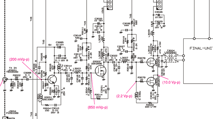

I blew a driver on mine. It went D-S short and so there was zero drive to the PA.

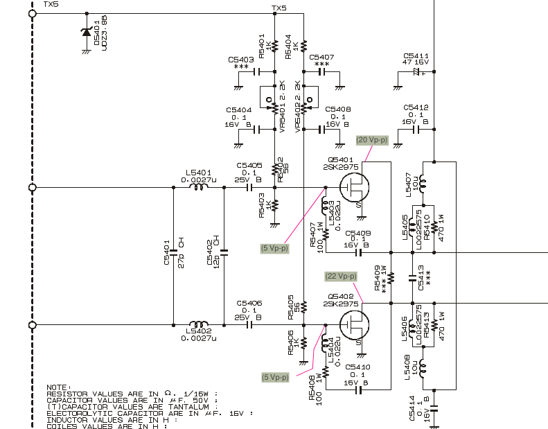

Stick your scope on the drivers and PA fets and check the signals are per the circuit.
gate Q3001 200mv p-p
gate Q3002 850mV p-p
gates Q3004/Q3005 2.2V p-p
drains Q3004/Q3005 10V p-p
gates Q5401/Q5402 5V p-p
drains Q5401/Q5402 20V p-p
As soon as something is vastly different it points to where you should look.

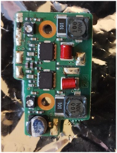

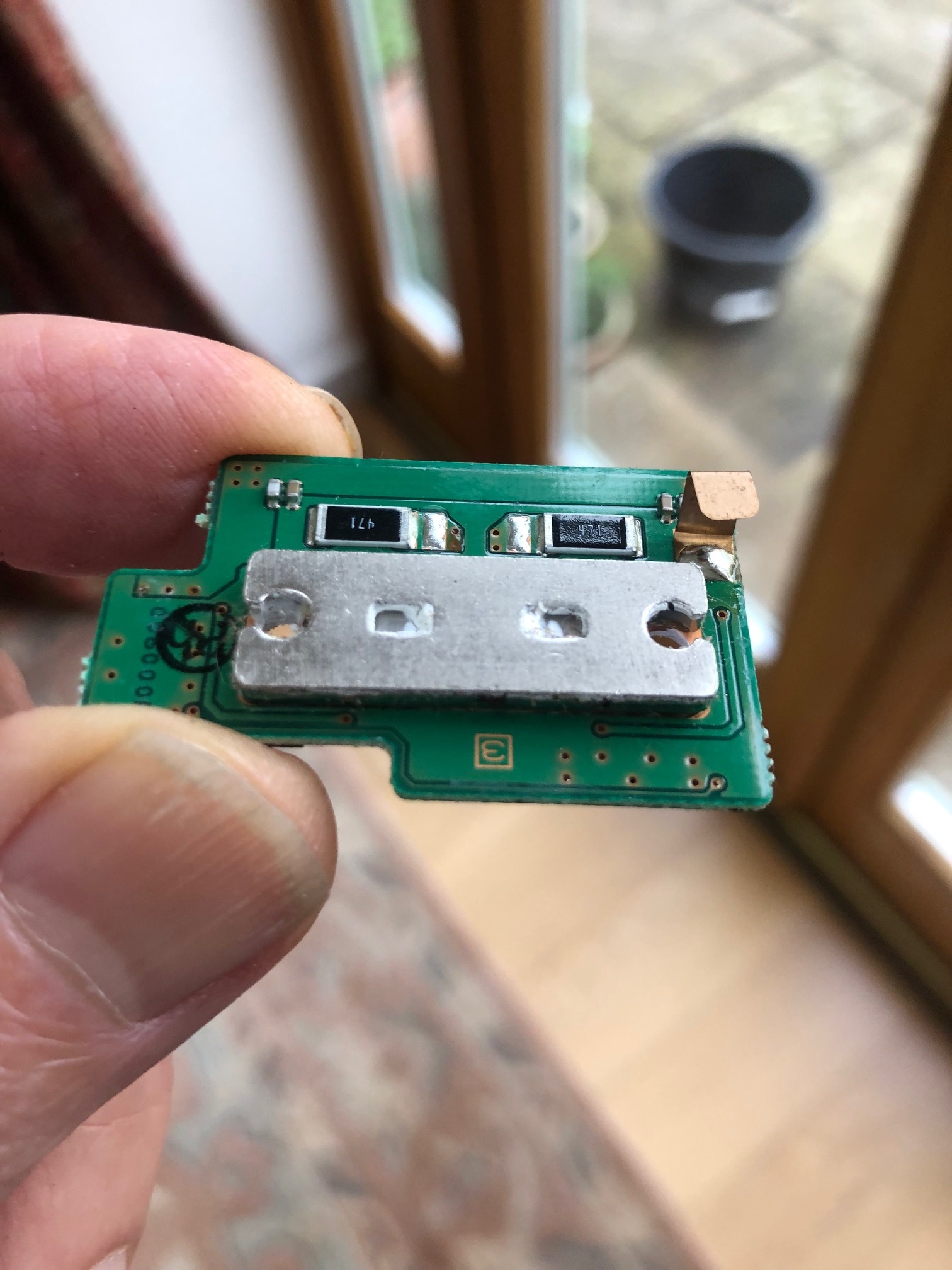

Thinking on… I should have a working Mk1 PA board somewhere because it was a driver fault on mine but I believed the Intarwebz and just swapped the PA without looking to see if there was no drive. The house is upside down especially the shack as building work progresses, but I’ll see If I can find it.
EDIT:
Success :-):
