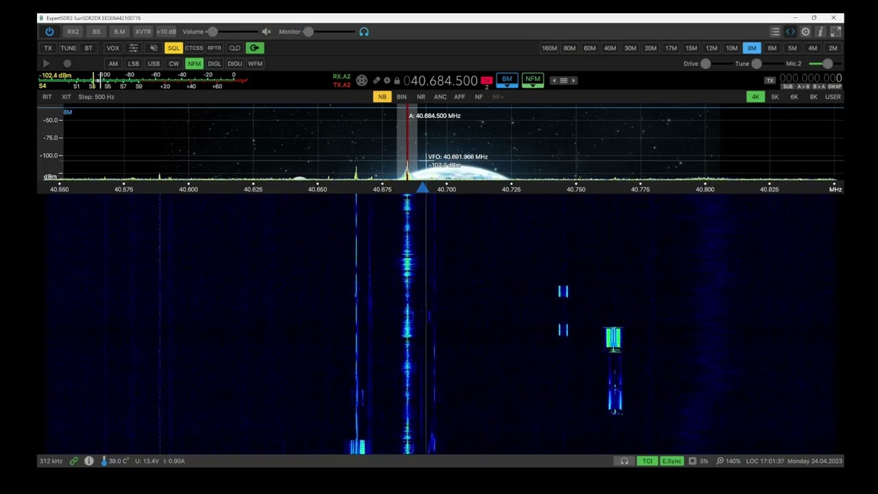

PSK Reporter shows a lot of activity on 8m FT8.

I was watching a video there about 8m in the USA and it looks very interesting, just the band in general. The prop potential looks immense. There is some absolutely bezerk DX windows as well, according to an EI blog. Windows of 15,000km+, trans-Pacific etc.
I only found 2 videos about the 8 meter band on YouTube. Has anyone done an 8m SOTA activation yet? If not, who will be the first to do it!?
