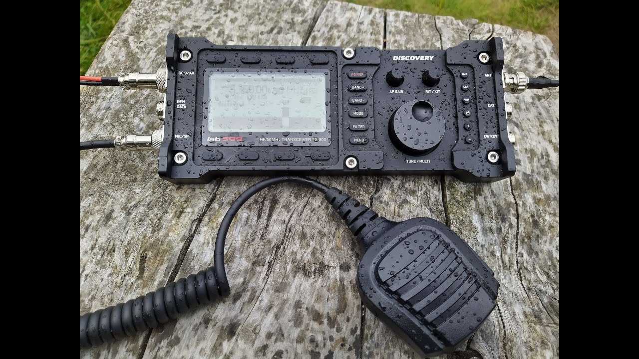

After I activated 17 summits using this transceiver in SSB-mode, the points in my previous post are still valid and I don’t regret that I bought this rig.
When travelling by plane, I prefer the FT-818 due to its contained 30Wh LiPo and therefore less chance for trouble during the security inspection. Another solution could be my Chinese power bank with the three swappable 18650 LiIon cells, since the rig should work down to 9V. I tested it with 9.5V, where it still delivers about 7W RF output power.
Some refined or additional points:
  • I used it twice without any protection in the rain. It’s really built for rough environments and you don’t have to be worried about ingress. But it’s not IP-certified, probably because of the involved costs. I still have to test it in the cold with deep snow, but I guess this evaluation was already done in Siberia by the manufacturer :cold_face:
  • When transmitting with the full 10W RF output-power for longer periods in the sun, the device gets very hot. But thanks to it’s aluminum alloy body and it’s black anodized surface that acts as big heat sink, I never could make it overheat. If so, according to the test videos, it would reduce the TX output power.
  • It’s useful to have voice memories. Especially the sentence “is this frequency in use…?” is handy to transmit prior to sending out a spot, by simply pressing a function button. Unfortunately, this sentence only helps if the other party is listening on the frequency before transmitting :wink:
  • The usability is very good and the button layout and menu structure makes sense to me.
  • The transceiver allows to TX according IARU region 2 band plan, with one exception: on the 60-meter band, the range is 5330.5-5405kHz USB.
  • The measured SWR values are too optimistic.
    Since the last firmware update, there is also the possibility to produce an SWR-graph, similar like the IC-705 does. Of course this graph cannot compete with an analyzer, is not very well readable, and like the SWR measurement, it is not exact. But compared to the FT-817/818, it’s a big improvement.
    Last Saturday, while doing an activation, I made a short video, where I compared this graph and its SWR values with my analyzer: Lab599 TX-500 Transceiver Tests after Firmware Update to Version 1.10.04 - YouTube
73 Stephan
