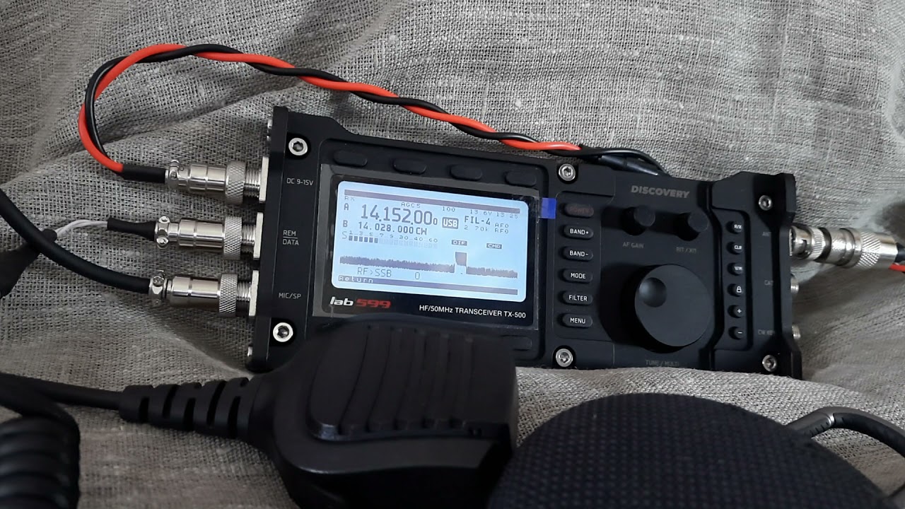

I faced I few videos which show clicks after setting PRE on, and RFG to 0+ and than increasing Audio Gain to 20+. There is significant distortion in ouput audio like overloading audio frequency amplifier.
Hi Yuri,
Interesting, I had the pre-amplifier enabled and the rf-gain set to 0 (default setting) but didn’t hear distortions. Do you have a link of such video that shows this behavior?

Hi Yury,
Thanks for providing these two videos!
In the first video, one hears a lot of man-made RF noise, and after Vlad connects the line output to an external (active) speaker, suddenly a French voice can be heard. But I’m not sure what was the problem that Vlad wanted to show. IMHO, a signal generator would be better and more repeatable to analyze a problematic RX behavior.
In the second video, I focused on the SSB part, but even after listening and looking at the transceiver’s display (for changing AGC, AF- and RF-gain values), I’m not sure if I really understood the problem.
Using the translator, it seems that there is a problem with AGC and therefore overloading the AF-stage. Further, it seems that part of it can be solved by increasing the RF-gain, but this sound not logic to me and I’m not sure if I understood it correctly. Unfortunately, due to the not perfect English translation (that is moreover not my mother tongue), I may have missed the fine details.
I really appreciate that RX3ALL sent his findings to the developers, so we may hope for an improvement in this weak spot.

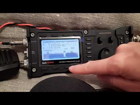

Here is video, where RX3ALL connects RF Generator to Xiegu G90 and TX-500.
As a result sensitivity of TX-500 meets the specs but at some time there are noticeable distortion during receiving signal from generator at 3:50m.
Also Vlad posted video for TX-500 where he set equalizer to 5 or 10 for SSB and this solved annoying noise (clicks). You cat try to do this (increase EQL RX HF to 100) on your rig and enable PRE and RFG to 5, I am very curious about results.

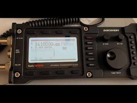

Hi Yury,
I can’t say much about the first video, since I have no experience with CW. The filter is set to 50Hz, which is very narrow.
In the second video: at which time can the problematic behavior heard?

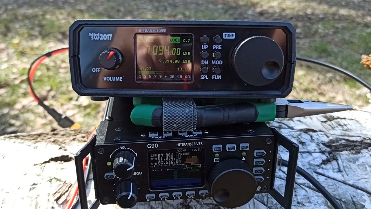

To finally close off topic, on 0:35 on my G90 video I hear strong hiss noise despite the fact that it was spring near the lake without any man-made or atmosphere static noise. The audio gain was not important because using headphones or line-in for recording produce the similar result with hiss noise only from G90
I also constantly use high-impedance headphone and It was hard to use it with G90 after QCX or 2017 or FT-891.
Unfortunately, I sold G90 and was not able to record using audio input like here in video:

At this 0:35 position, the G90 was just switched on, probably having max. RF-gain, until the AGC kicked in.

This is problem with AGC in G90 (firmware). If I turn off AGC it will be a little bit noisy than sw2017 but enabled AGC adds significant amount of noise.
To be honest, RF Gain was set to minimum value 1% on Xiegu G90 in the video.
You can also notice that Xiegu G90 S-meter reports something about S7 but mini sw2017 S-meter shows something about S9+15 when the same OP say hello. This means that sensitivity of sw2017 is better than G90. And this is not a QRN or signal level changes.
G90 is a little noisy and a little deaf transceiver, this is pity but true. You can check Receiver Test Data list there G90 is in the bottom of the list for receiver Sensitivity.
My DIY mini sw2017 has sensitivity about 0.35uV comparing with G90 with 1.0uV when RF Gain set 50%. With RF Gain 1% G90 Sensitivity will be worse.
