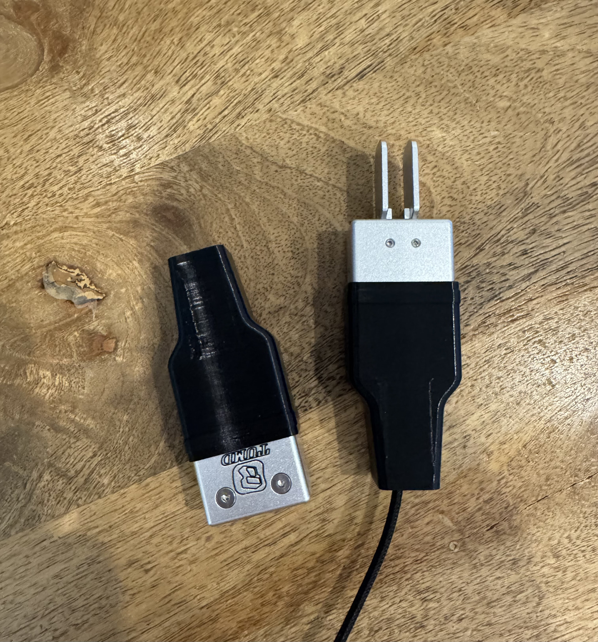

I’ll add a plus 2 recommendation for the TUMD paddle. I’m super happy with it and bought a second one. Really solid for $50CAD Not the lightest but worth taking out for a SOTA and I’m even using it a home occasionally without feeling like it’s more work than my desk key.
I made a little slip-on protector that covers the keys when packed in my bag and reverses to give you a comfortable grip on it when using in the field. I can put in on Printables if anyone wants it. Printed with TPU and has some little divots inside that latch into the adjustment access holes on the sides. Really comfy to hold for me.
