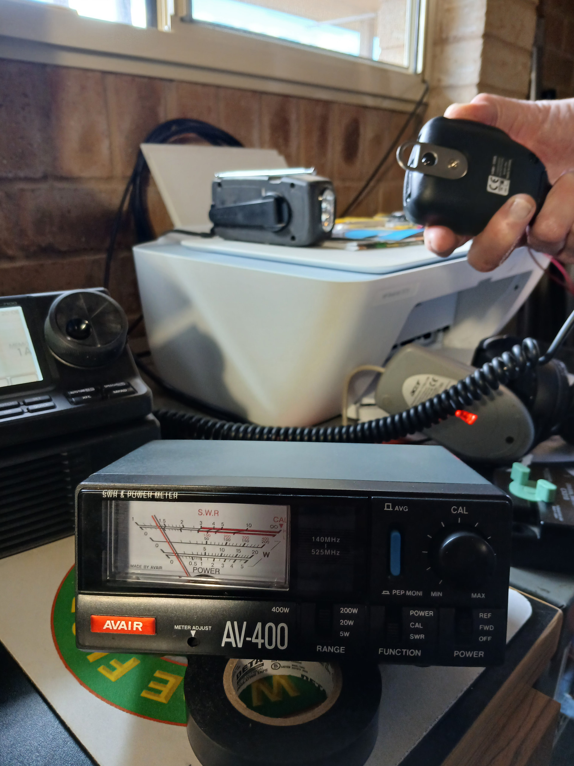

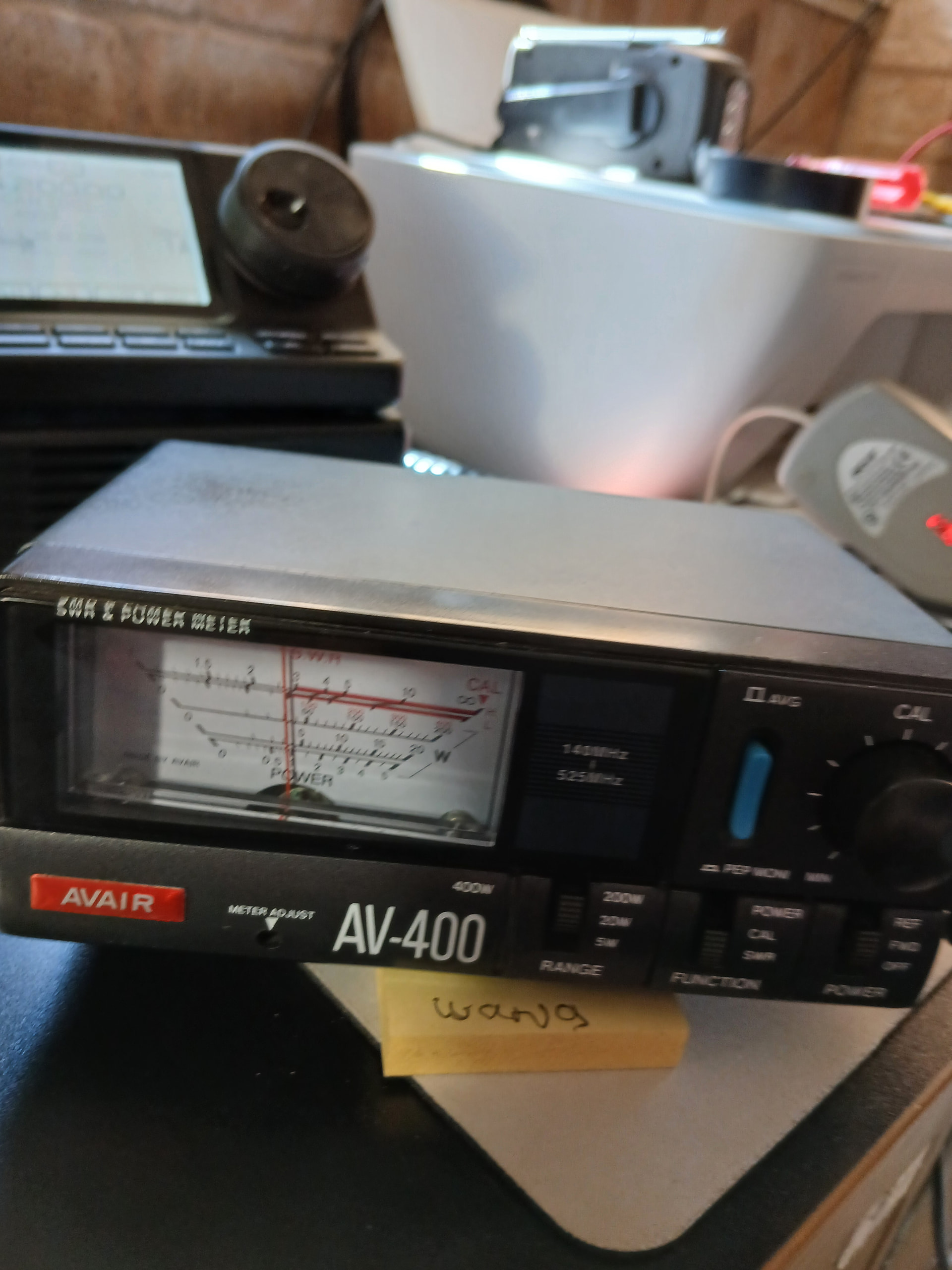

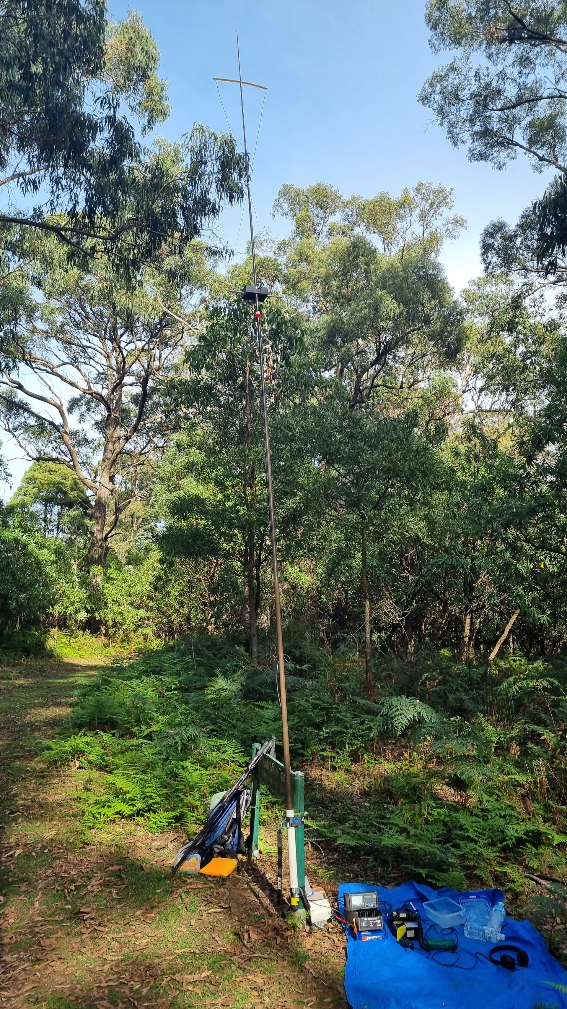

…hi Ian, yes make sure you do tune. Below are my before and after tuning.
The initial length of 430cm given (which I used) by John Stanley is a good start but needs trimming. Got it down to 1.3 to 1. Very pleased :grinning_face:
cheers- Geoff vk3sq
