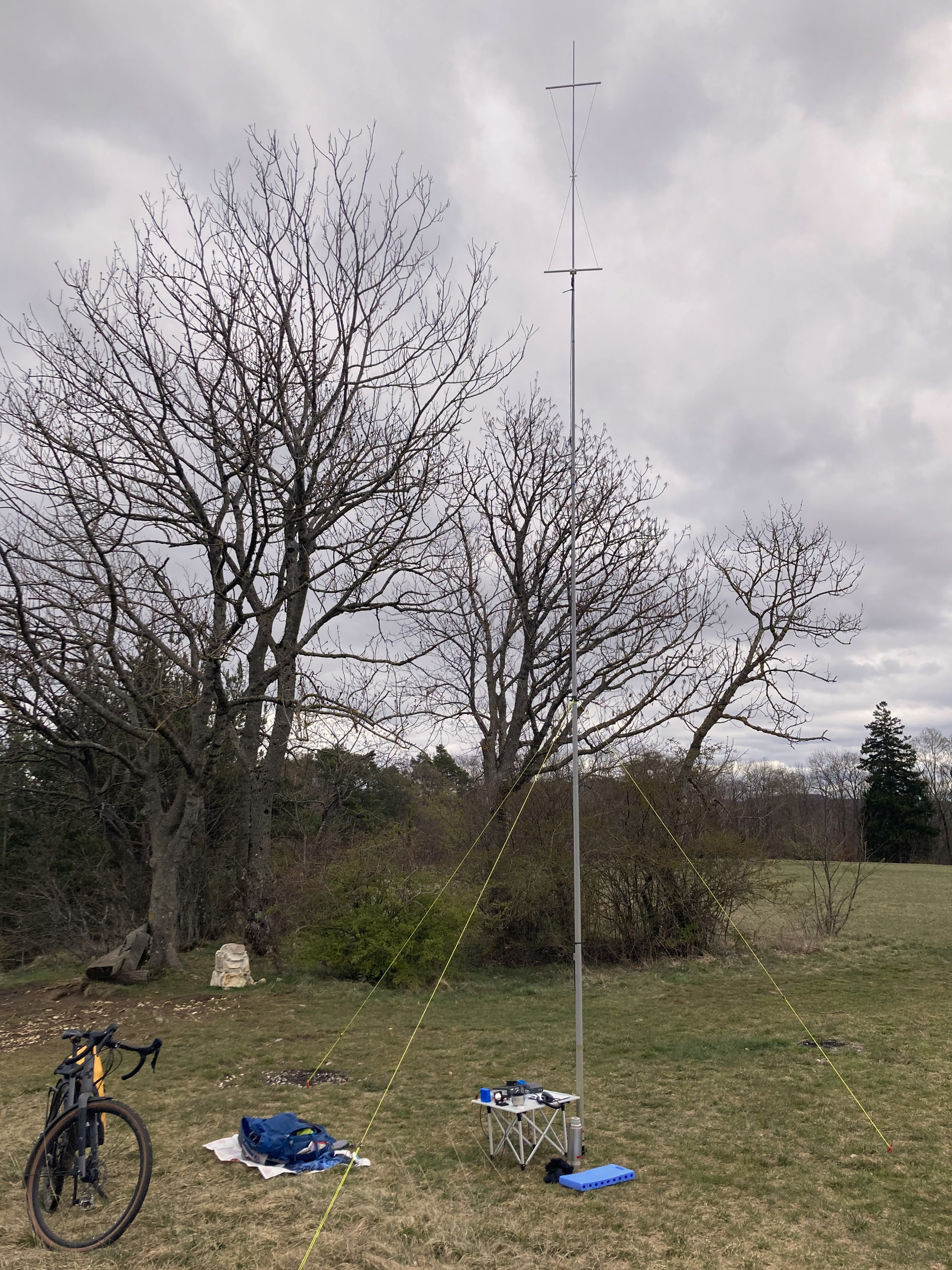

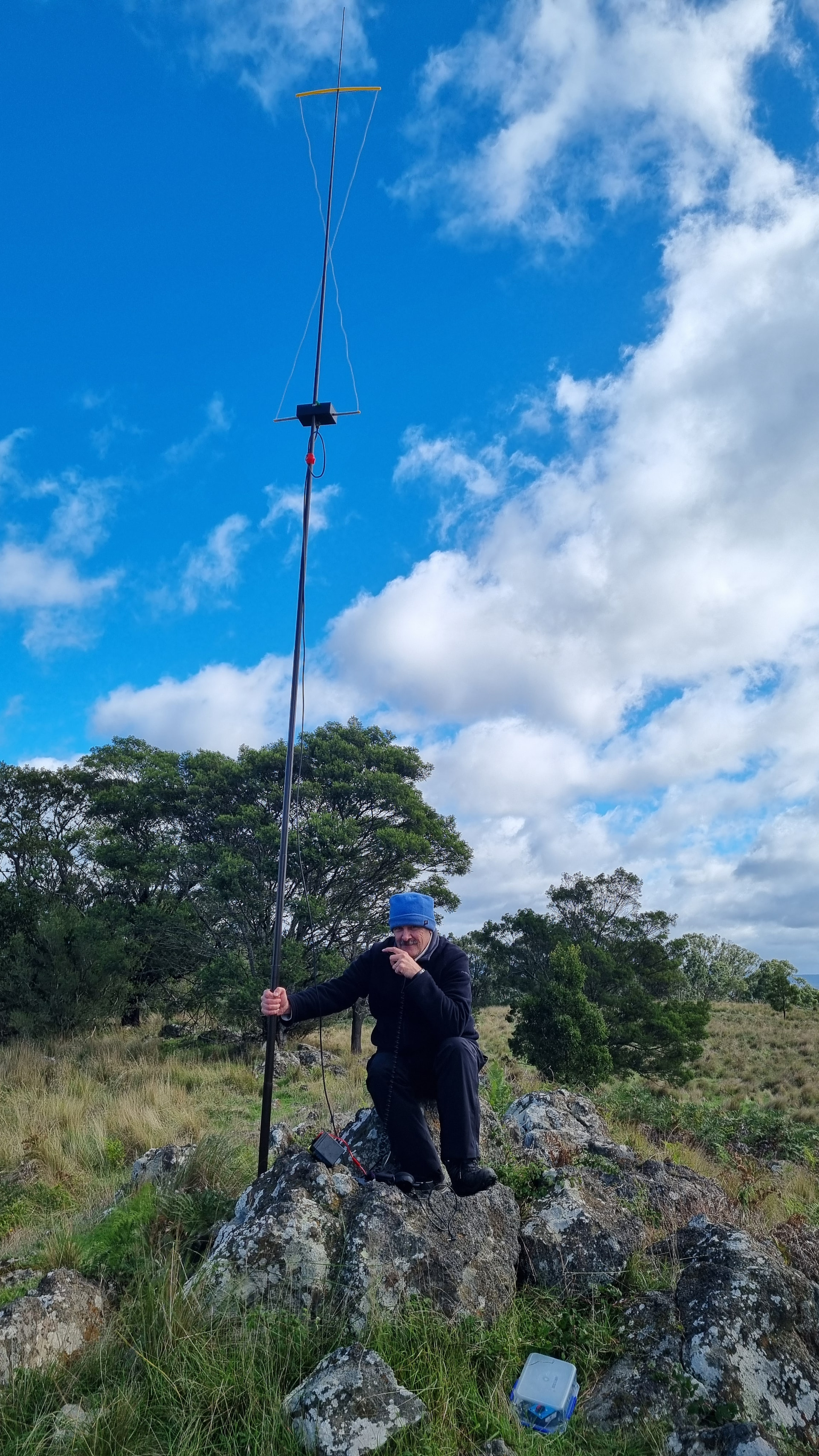

Today I participated in the DARC VHF Spring Contest from DM/BW-089, one of my local summits. Again I brought my hourglass antenna along but this time I wanted to try mounting it on a 10-meter squid pole instead of my usual 6-meter pole. Foolishly, I hadn’t bothered to try assembling it at home, so I didn’t realize that the holes didn’t line up until I was up the mountain. To make things worse, it was pretty windy, and the antenna kept twisting around immediately. I could only achieve a straight alignment using cable ties and a large amount of tape. The whole endeavor was somewhat pointless, because due to the strong wind, I couldn’t use the full 10 meters as planned, and had to settle for about 7–8 meters.

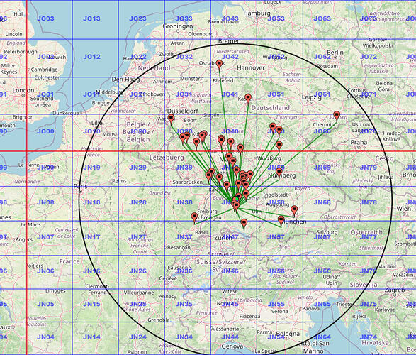

Conditions were average overall. There were plenty of contacts between 100 and 300 km, plus two QSOs over 300 km and two over 400 km.
Equipment was again the old FT-290R and a small PA with about 10 dB gain.

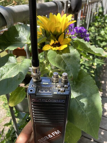

One highlight was a QSO I made using my Belcom LS-202E, which covers 144 SSB with PLL and VXO. Maximum output power is around 3 W. I honestly wasn’t sure if the transmit and receive frequencies were still properly aligned, but to my relief the Tx frequency was only slightly off.

That Belcom looks amazing. I love it. Looks a little like my FT-202R. It has a limited crystal set in it but I can slip it a little tickle from a linear to pep it up!

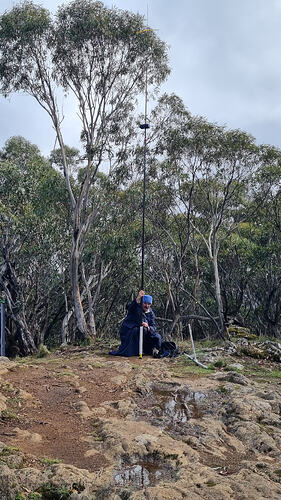

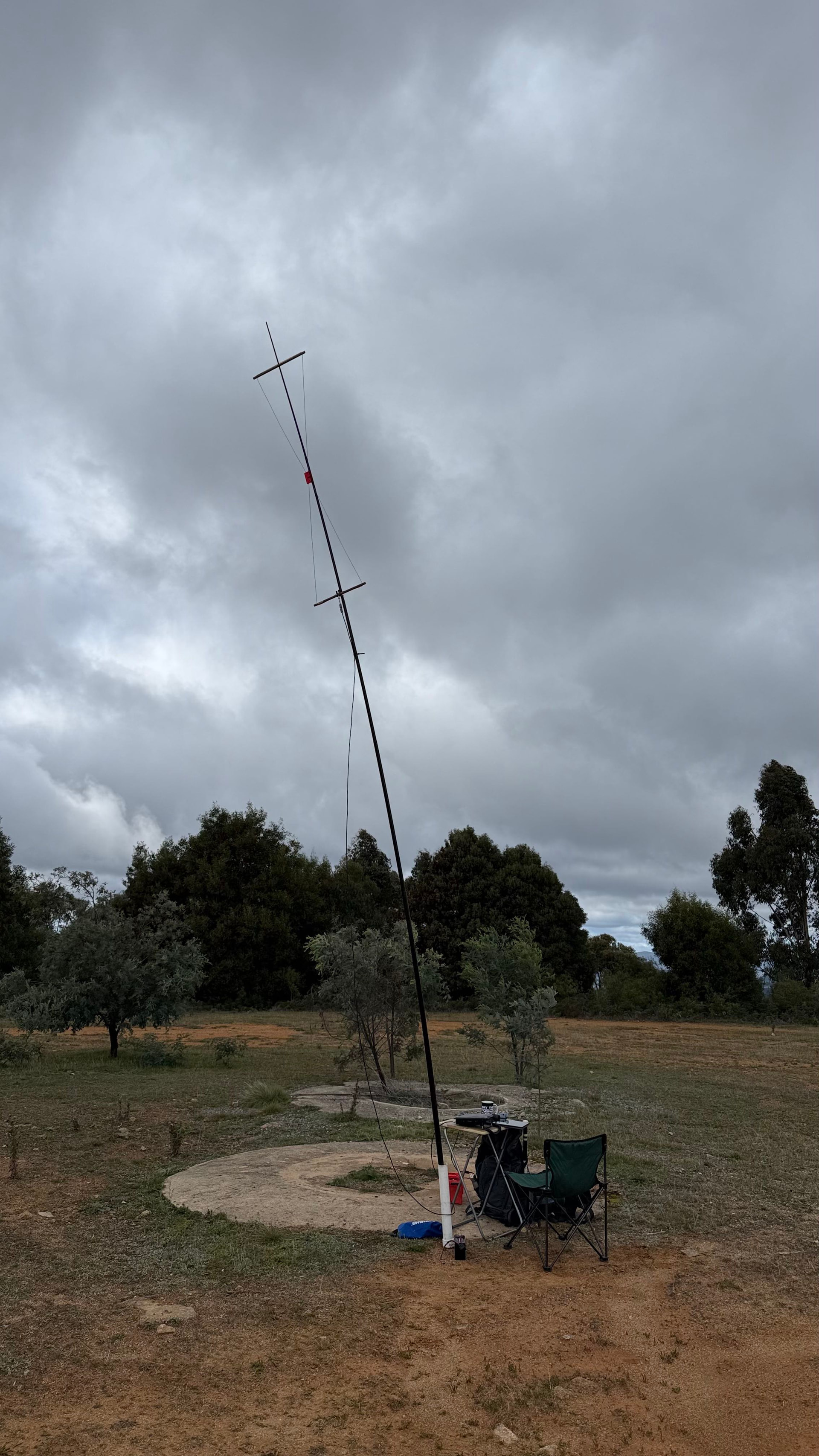

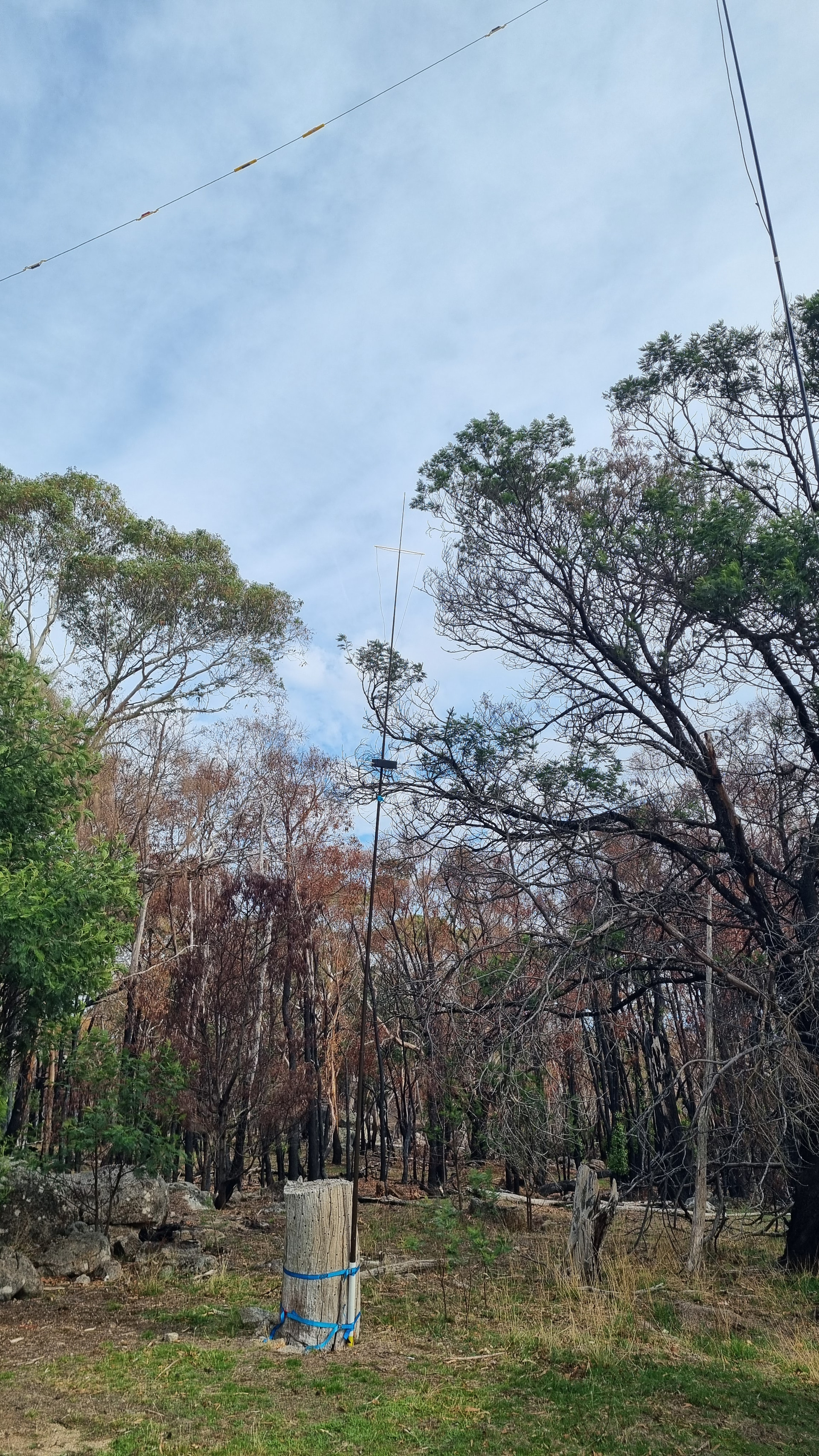

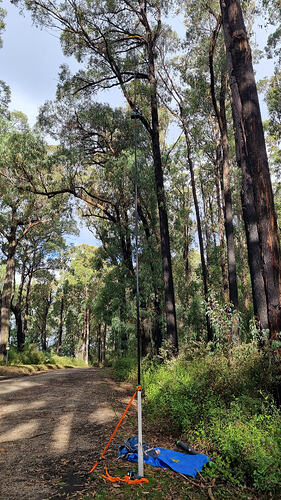

Sunday 5 April 20026 with Manuel @EA2DT we activated VK3/VN-016 Mt Alexander. While Manuel focused on HF, I tried out my repaired hourglass antenna.
Mt Alexander is 751 m ASL, located in Central Victoria. The line-of-site path to the capital city, Melbourne, is obstructed by the Macedon Ranges that peaks at 1005m ASL at VK3/VC-040 Camels Hump. This makes for trying conditions on VHF.
Using the hourglass antenna, on a 6m pole fastened to a tree stump, I was able to make four 2m SSB QSOs, ranging between 78 and 161 km, including one S2S with @VK3YY at VK3/VC-031 Arthurs Seat. I did resort to the 5 element Yagi for one QSO as it seems to have slightly more gain than the hourglass. This may be due to less feeder loss as the Yagi is fed with RG213, while the hourglass uses RG223.
After VK3/VN-016 we moved to VK3/VN-023 Mt Tarrengower. This hill, at 565m ASL is lower than Mt Alexander but is further west and suffers less from obstruction by the Macedon Ranges.

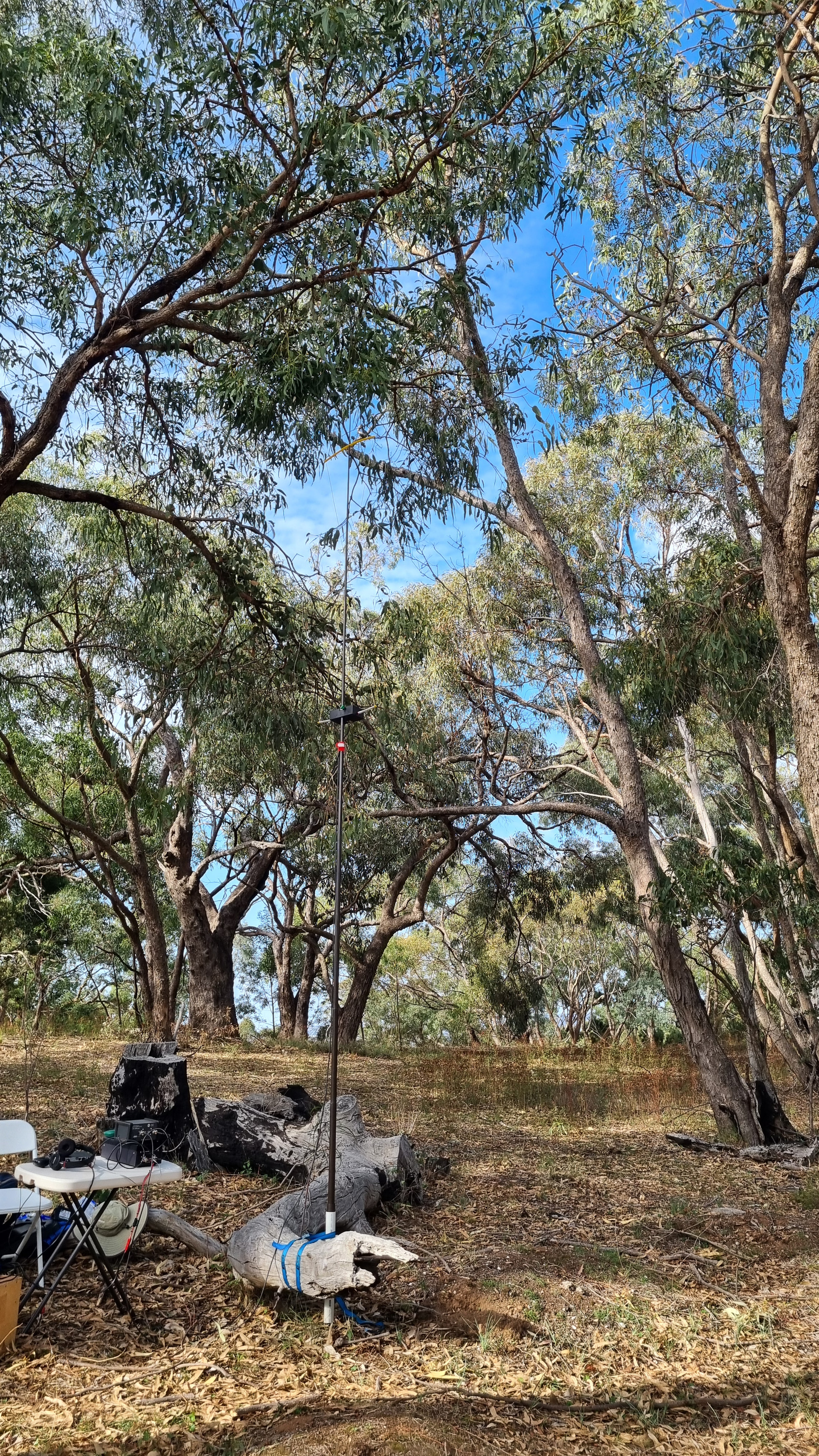

Again Manuel @EA2DT focused on HF, making more than 110 QSOs, while I again tried 2m SSB with the hourglass antenna on a 6m pole strapped to a log.
From Mt Tarrengower I was able to make 7 QSOs on 2m SSB between 66 and 258 km.

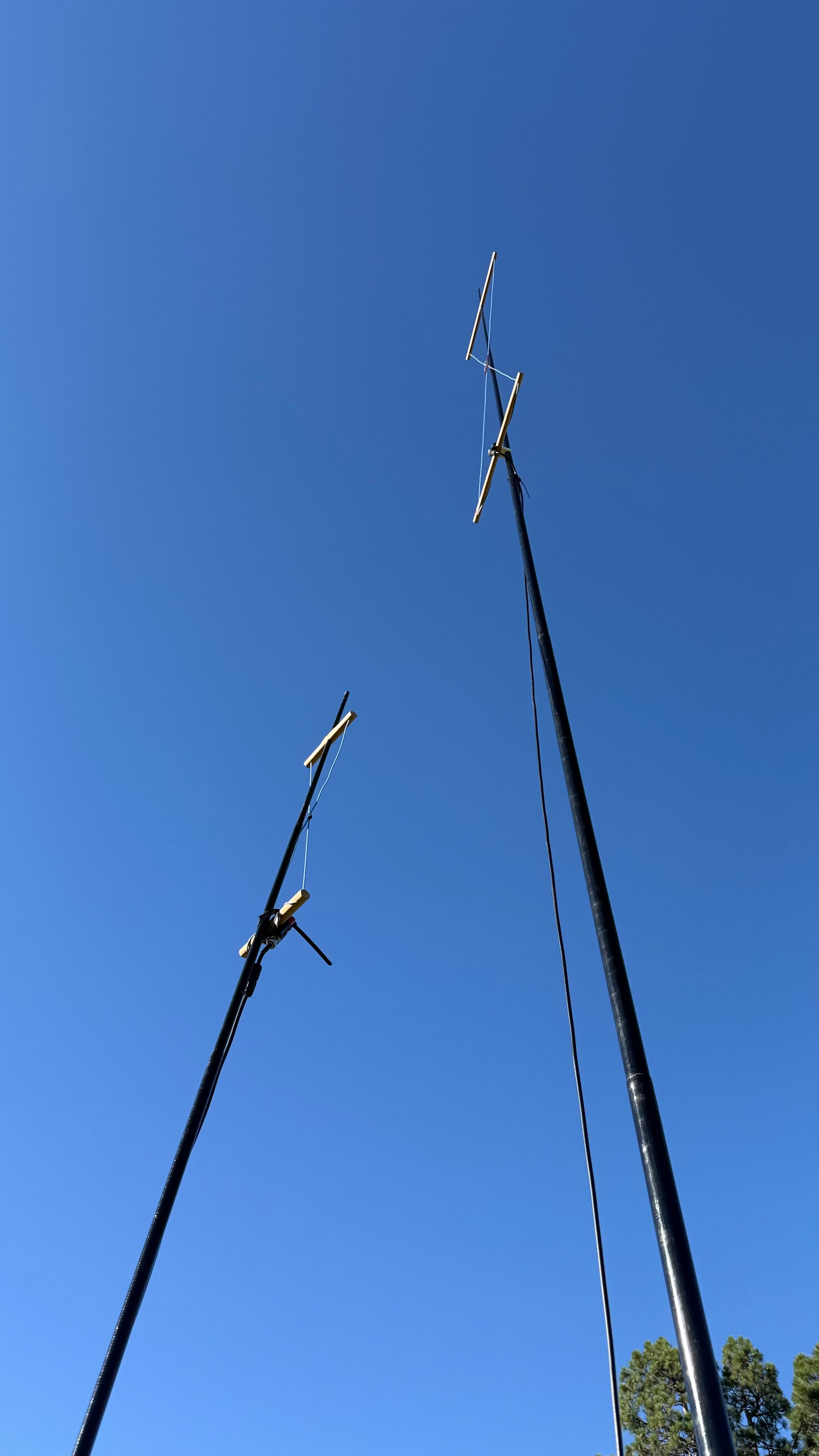

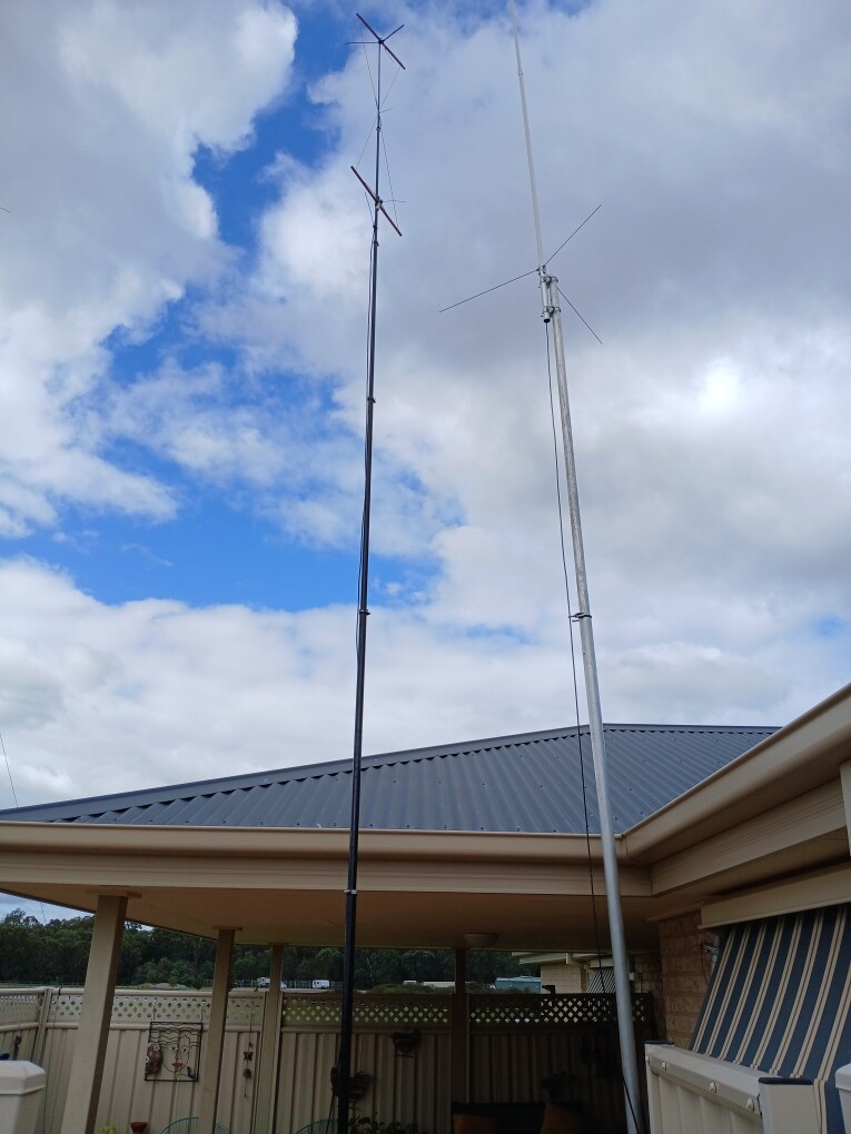

Earlier today, 2m and 70cm hourglass antennas at Mt Stromlo VK1/AC-043
Andrew VK1AD
No way. You built a 70cm as well? Nice! Look at them hoisted there like a couple of proud champions! :star_struck:

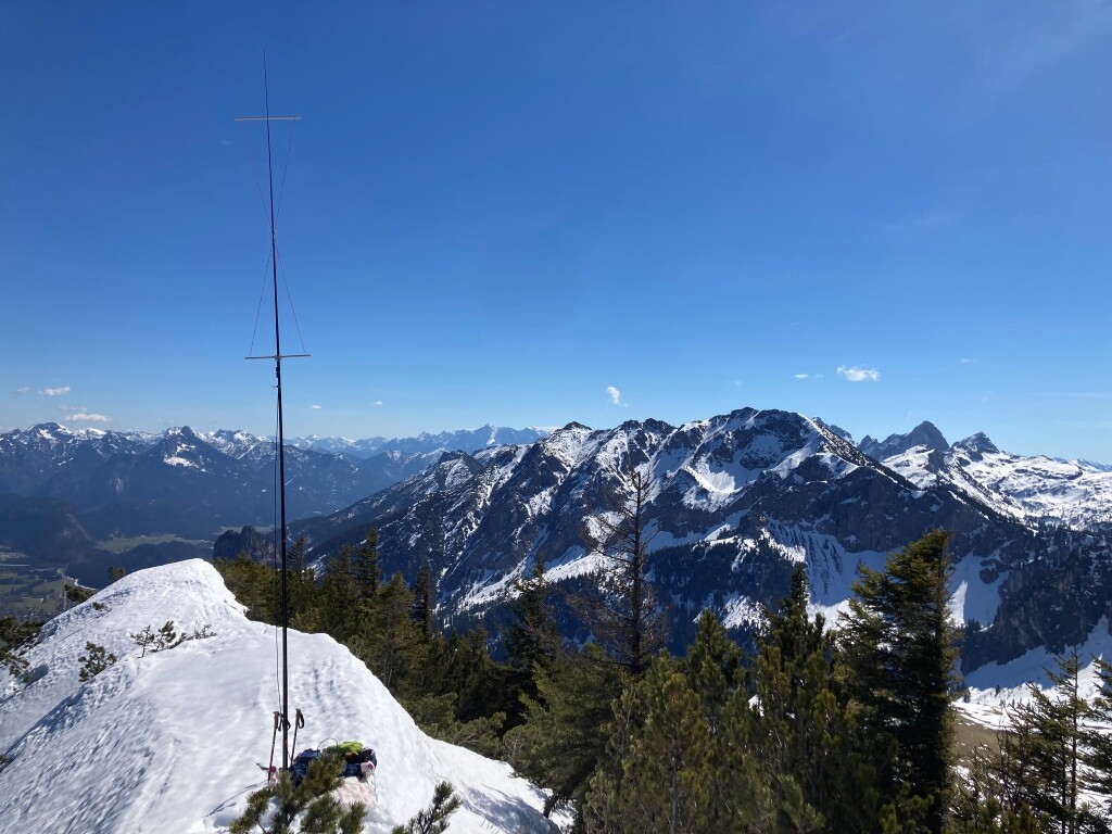

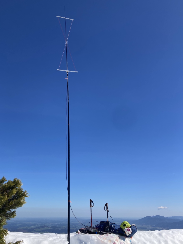

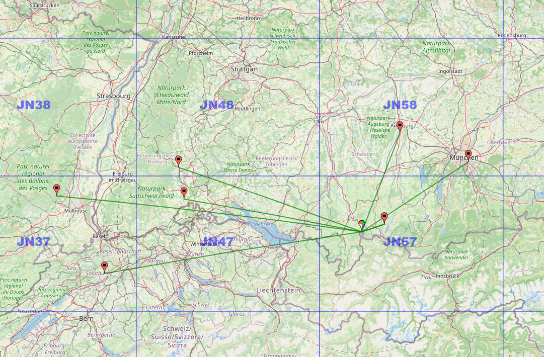

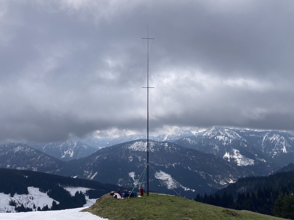

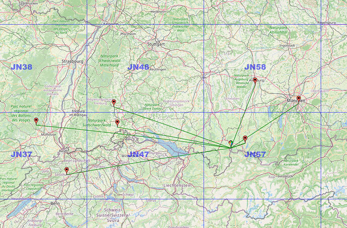

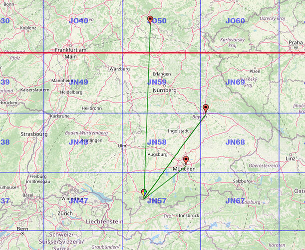

I spent the last few days up in the Alps (DL/AL region) and did a couple of activations there. As already said, the hourglass loop is a good candidate for long hikes and restricted space.
Activity on 2 metres SSB wasn’t that high but thanks to a few die-hard chasers and some random QSOs it was lots of fun again :slight_smile:
Activation of DL/AL-163, Reuterwanne, 1542m asl

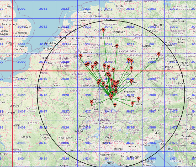

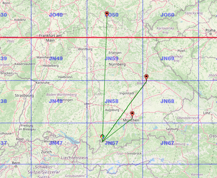

QSO-Map: ODX was a S2S with @HB9EAJ on FL/VO-017 across almost 250 km with 6 watts on Stephan’s end.
Activation of DL/AL-158, Breitenberg, 1838m asl
QSO-Map: ODX was DK5KMA across 320 km. The signals were strong enough for me to turn off the PA and complete the QSO with ~ 2.5 watts.

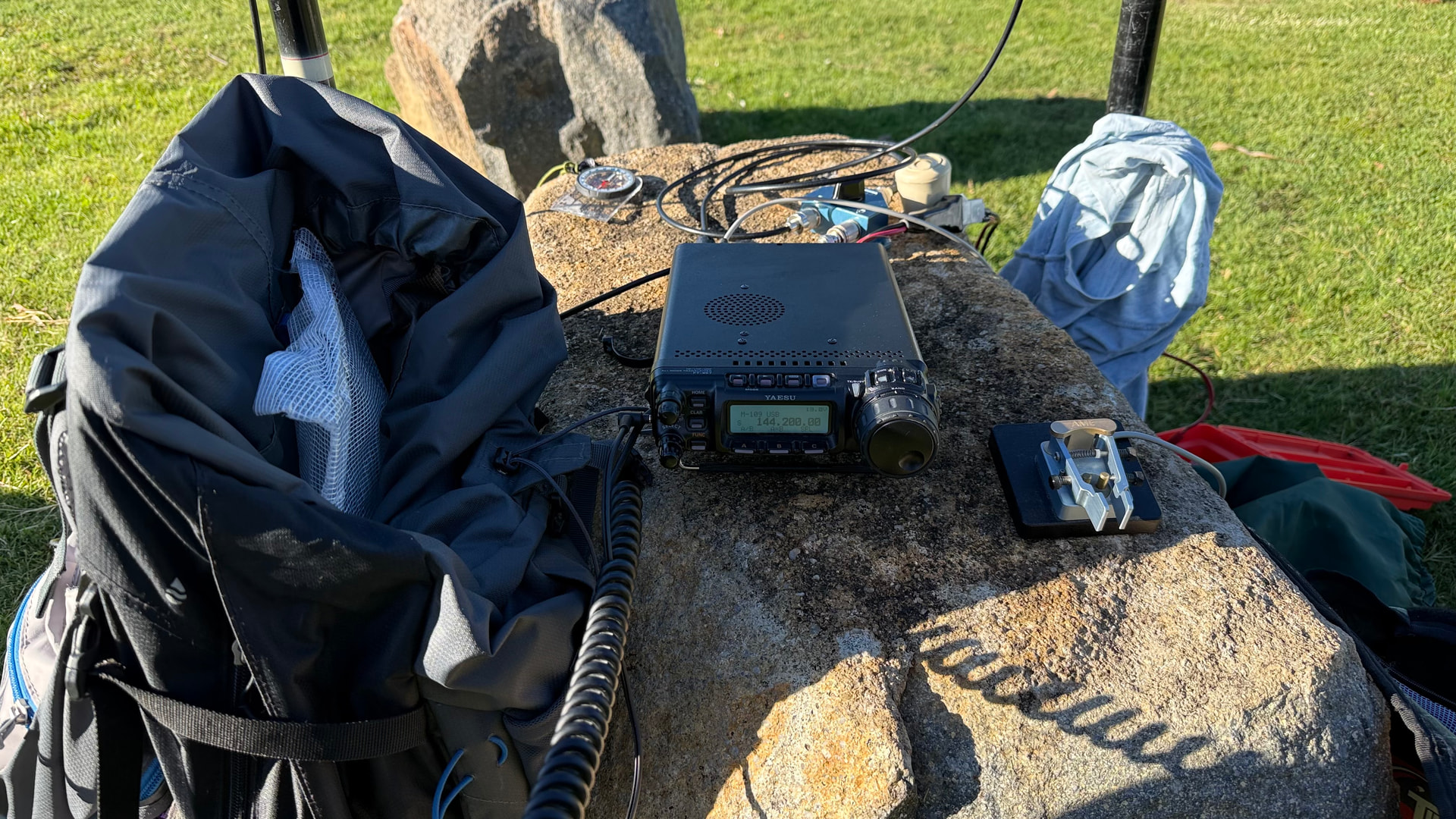

Saturday 11 April saw Manuel VK3/@EA2DT/P, Peter @VK3TKK and I walk up two summits.
The first summit was VK3/VC-039 Mt Gisborne about 630 m ASL. The weather here was OK, but a slight breeze and the threat of rain made the activation a bit uncomfortable.
Here Manuel stuck to 40m and 20m working 31 QSOs while @VK3TKK and I looked for beacons and compared the hourglass and 4 element Yagi antenna. We also made five 2m SSB QSOs ranging 14 - 82 km from our summit.
As noted by David VK3KR supporting poles at VK3/VC-039 is challenging and I had to support the pole to keep it vertical when making QSOs.
The second summit for the day was VK3VC-040 Camel’s hump. Again, Manuel VK3/EA2DT/P focussed on 40m and 20m making 48 QSOs, with the final QSOs being made as the rain moved in, and the temperature dropped. As Camel’s Hump is 1011m ASL the weather change was certainly more noticeable.
Peter VK3TKK made 7 QSOs and I made 8 QSOs on 2m with the hourglass antenna. We also did some comparisons between the hourglass and a delta loop antenna.
The last QSOs for the day was all three of us contacting @VK3PF who took time out from a class he was instructing, just for our 2m SSB QSOs. Although we had packed up when Peter called us on the telephone, we quickly reestablished the 2m station with the hourglass antenna. This last QSO was about 180 km. Other 2m QSOs from here were 29 - 92 km away.

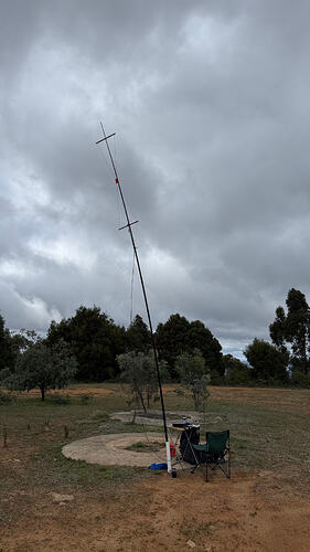

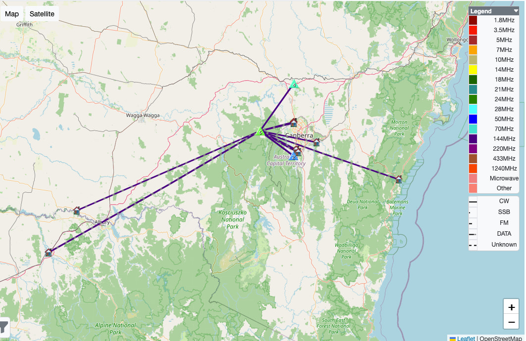

Earlier today at Snow Gum Mountain 1179m ASL VK2/SW-028, where the ambient temp was 5 degrees C and the feels like was zero or less with winds gusting to 45 km/h. I struggled to keep the pole vertical while the hourglass cross arms were acting as wind vanes and rotating with each wind gust :frowning:
Notable mentions: Geoff VK3SQ 251 km, Greg VK2EXA 206 km and Chris VK2DO 148 km. I worked Geoff twice via aircraft scatter :slight_smile: while Geoff was using his freshly minted 2m hourglass antenna at his QTH. Hourglass to Hourglass at 251 km :hugs:
S2S contacts: Bill VK1RT at Mt Mundoonen 59 km and Andrew VK1DA & Tom VK1CAT both at Castle Hill VK1/AC-032 41 km.
