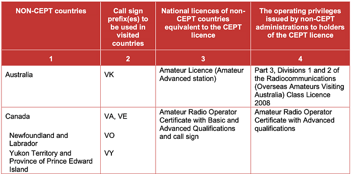

Today is one of those days when I need to ask the guidance of my peers, because I see a discrepancy between what many people are doing and what it says in The Documents, specifically in T/R 61-01 (extract below).
Case in point: yesterday I activated VY2/PE-002 on Prince Edward Island as VY/G5MUP, because that’s how I interpreted the recommendation in T/R 61-01. Other activators have been using VY2 as a prefix, some use VY2 as a suffix, while others just use their own call from another region. We can’t all be right, so is it a case of:

The question of whether the country code of the country you are visiting comes before or after your home call sign depends on which agreement you are operating under.
In the case of CEPT TR61/01, the prefix comes first - it is the one shown in the document and for UK hams, it’s the “actual” licence call sign (i.e. without the RSL). For CEPT 61/01 UK hams must have a full licence.
If, however, you are visiting a country which is NOT a signatory to the CEPT agreement, then the rules in any older agreements apply, and in many cases, these require the visited country prefix to be after, not before, your home call sign. Many (but not all) of the Non-CEPT agreements will require a formal application to operate; you can’t simply arrive and operate for up to 3 months as with CEPT 61/01.
These older individual country-to-country agreements can sometimes also cover Intermediate and even Foundation licence holders; however, the CEPT arrangements currently apply to UK full licence holders only. There are CEPT agreements both at the Intermediate (CEPT Novice) and, to a lesser extent, Foundation (CEPT Entry level) licence classes; however, Ofcom has not signed up to these agreements, and therefore they do not apply to UK amateurs.
Between the US and Canada, at least for full licences, they have both a local country-country agreement and the CEPT one, so you may hear stations with the prefix before or after their callsign, depending on which agreement they are operating under.

Hi Paul, you were operating under the US-Canada country-to-country agreement, not the CEPT one, hence you were using VY2 as your suffix (as specified in that agreement). UK visitors to Canada or the US operate under CEPT 61/01 in which case they need to put the prefix before the home call.
You could have also operated as VY/W6PNG - in that case, you would have been operating under the CEPT agreement, to which both Canada and the US are signatories.
