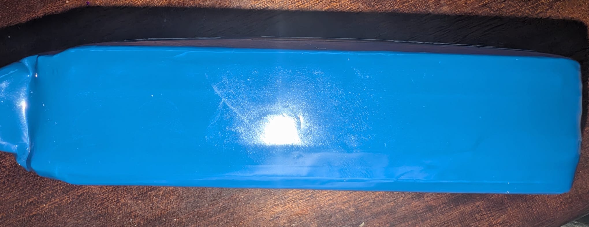

So i did a discharge not a long way but the worst cellw as down to 3.1V. then ran a really slow 0.2 balance charge and it seems to be working fine and was balancing up fine. except the battery i think is already bloated. I dont think the charging has done it, it might have been like this for a while one side feels fine but the other feels like a cushion, a very small cushion. the top of this image i tried to show the slight cushion/ballooning. So i dont think i’ll use it. I dont like ballooning lithium batteries.

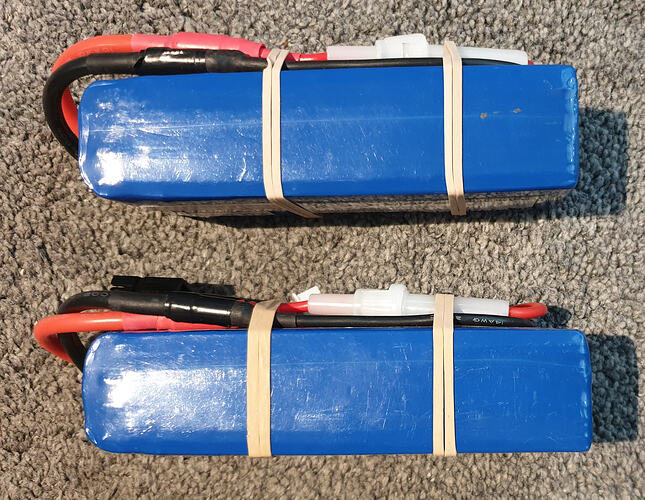

This swelling / cushion you describe looks little different to mine. All the wiring is at that slightly rounded end of the battery and it is definitely easier to compress. By comparison, the other end is hard and angular.
Mine haven’t changed since I purchased them. For comparison, I photographed mine.
I think you will know when they swell. I had two yellow Zippy 4.2AH LiFePO4 batteries… now one remaining. The other ballooned big time.
