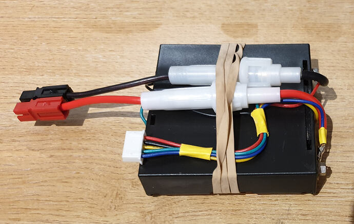

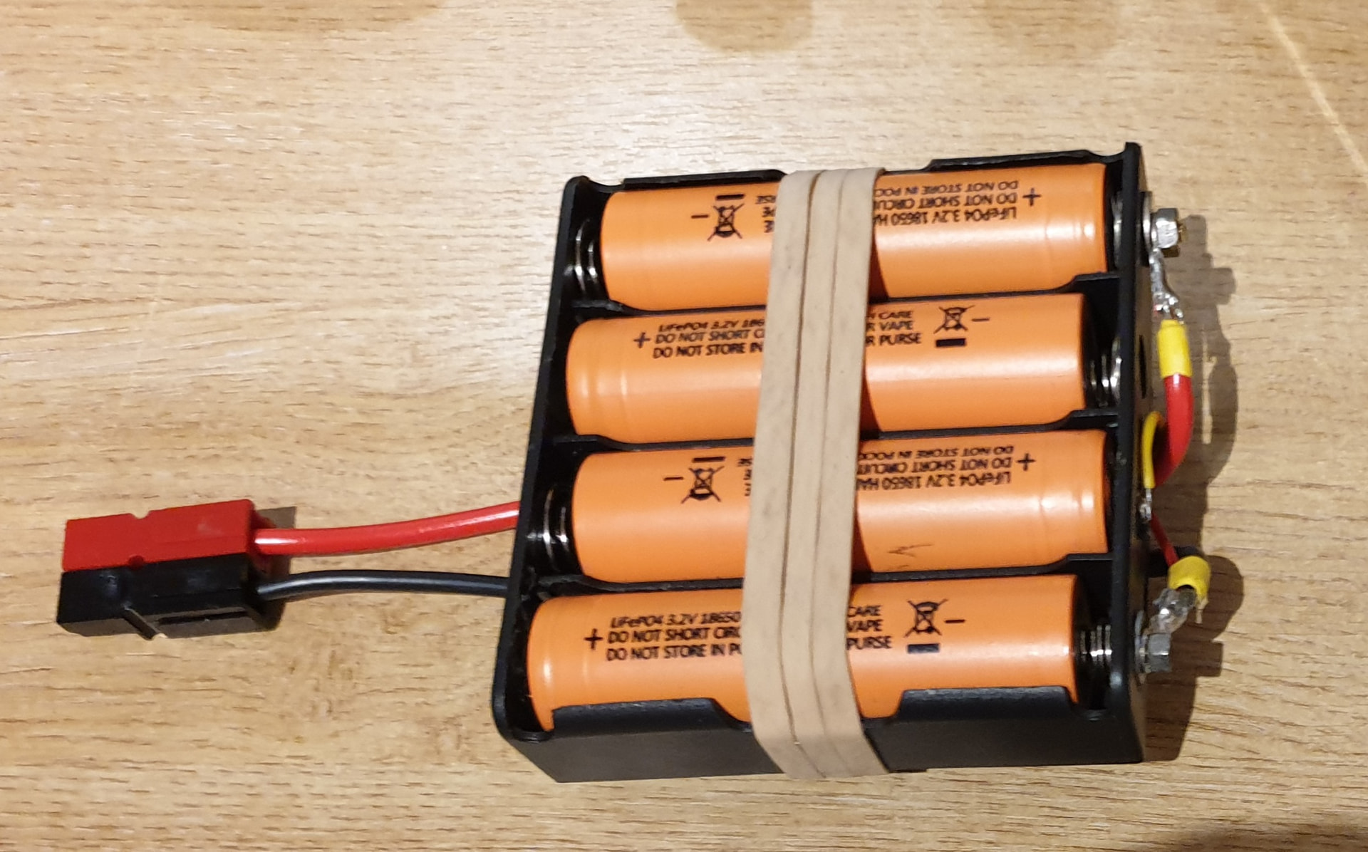

My preliminary effort based on the 2AH 18650 cells from Battery 101.
On its initial outing it powered my 817 for 2 hours running 2.5W SSB (driving a small linear powered by a 4.2AH LiFePO4) plus 15 minutes of 2m FM at 5W. Total current drawn 1.55AH. Weighs 220g. I’m thinking I might try a pair of 2 cell holders mounted back to back and blade fuses for the Mk2 version.
