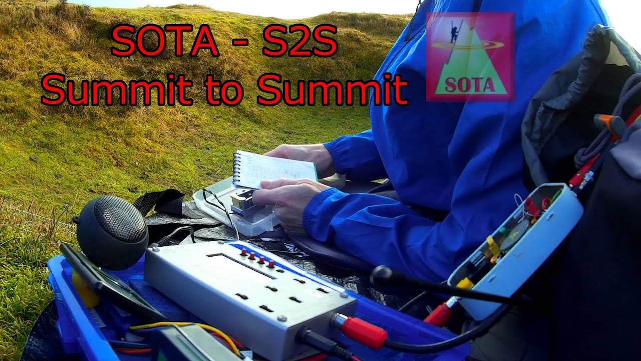

Similar here.
I rarely take video during an activation as I normally wear earphones especially if it’s windy.
When I do record audio, I use a little portable speaker plugged into the rig.
You can see it here at 45secs.
The camera I use ([Mobius][1]) seems to pick the audio up pretty well.
I’ll only record when there is no one else around as I feel it’s wrong to make any noise (other than key clicks) on a summit when others are present.
