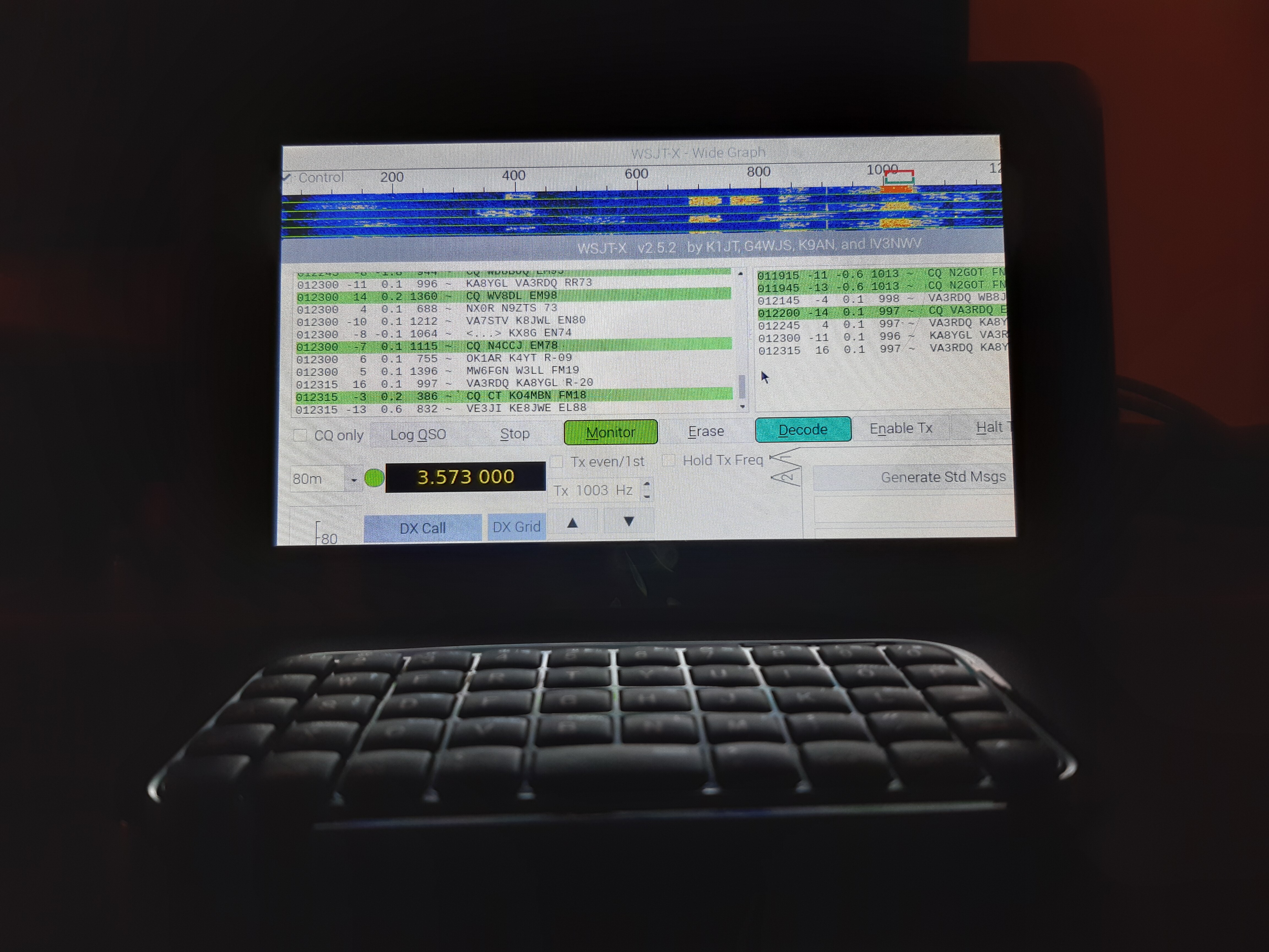

My Raspberry Pi 7 inch touch screen with Pi 3B and small BT keyboard from Adafruit. I used the screen with tlf on ARRL field days 2020 and 2021 in Class E Home stations with emergency power (12 V battery). Fritz HB9CYX mentioned similar setup already.
Tip: Use [ALT]-[left_click] or [ALT]-[finger] to move windows around. They are too large for this display.
I received the tiny keyboard last Friday and it is possible to make QSOs with WSJT-X using touch screen and keyboard by tapping the call on screen and moving TX frequency with [SHIFT]-[tap] and [ALT]-[finger] to move windows, but I would not do that everyday. With regular keyboard and mouse no problems.
In /boot/config.txt
#ignore_lcd=1
lcd_rotate=2
73, Jaakko ac1bb/oh7bf
Edit: Pi and display seem to consume about 0.4 A from 13.9 V source (5 - 6 W) when running WSJT-X.

Even Raspberry Pi Zero W seems to be usable in Fast Decode mode. Current draw from 13.9 V supply about 0.16 A using a separate HDMI display. Did not test VNC yet. Two random QSOs with this setup.
I was using RPi3 for FT8 at home for some time and in my experience it was too weak for anything beyond regular decode. Even in regular decode mode, it took RPi3 several seconds of next transmit period to complete the decode. RPi4 that I’m using now is fine even in deep decode mode, just make sure that you use proper CPU cooling as it gets hot fast under load.
In my experience 1280x720 is perfect resolution for 10’’ tablet. IMO any screen resolution below 1280x720 is too small as WSJT-X window won’t fit, especialy if you want to see the waterfall display. There are other programs that may fit, but I currently don’t use them. I tried JTDX and I found it more user friendly because its band activity display is much bigger. Using larger resolution, WSJT-X controls will be too small for comfortable work.

The ordered display is able to do 1024 x 600… will have to see which software will work with it.
Thanks Valdi for the hint! @Jaakko: the Pi Zero might be the next step once the existing solution is working. Thanks!

Reading the manual Decode button should illuminate three times for each pass in deep decode mode. It does that 2 - 3 times in my Pi 3b so I might be loosing some information in reception. Thanks for pointing that out.
