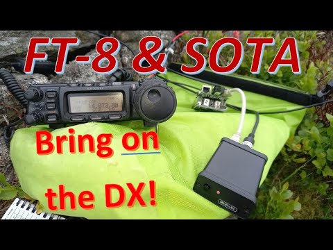

I’ve done a bit. I used a raspberry pi3b, a miniproSC interface and a Tablet with my ft-857d
The next time I forgot to take the tablet and managed just as well using my phone.
Maybe one day I’ll work out how to share YouTube links without displaying the big previews…
Cheers,
Fraser

First video was also very helpful!
