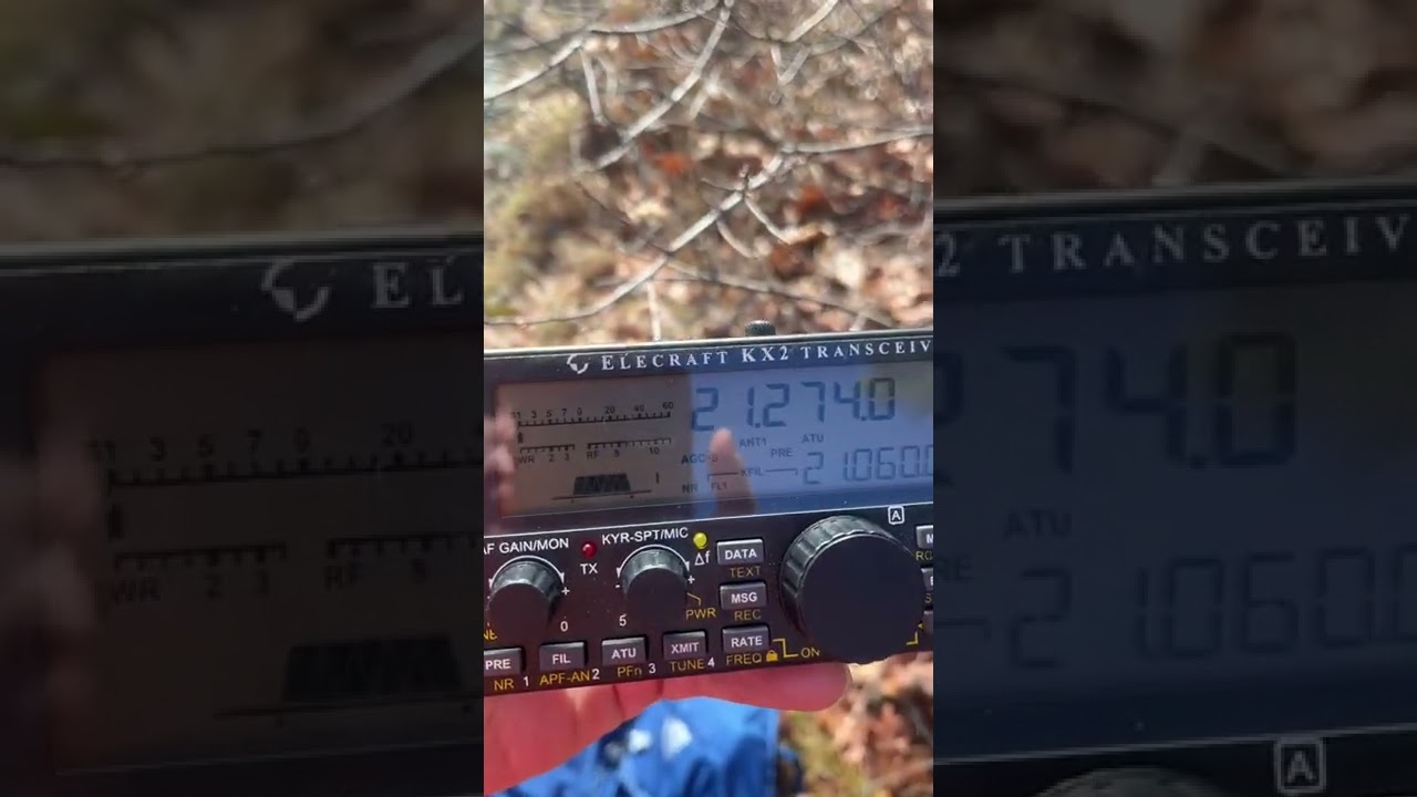

I managed two this past weekend on 15m SSB. HB9EAG and S57MS/P. I was QRP on SSB. Here is my video with HB9EAG. I was using a NY4G 40m EFHW and my Kx2
