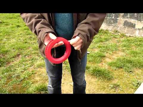

But you if you want, you can built it cheap and easy to carry. This is my ZS6BKW for 80m and other bands. It’s built with twisted wire as a feeder. And yes - i have an antenna tuner.
Ignacio made a beautiful film how to wind it.
I fix it with velcro and carry it in a freeze bag with zipper…
