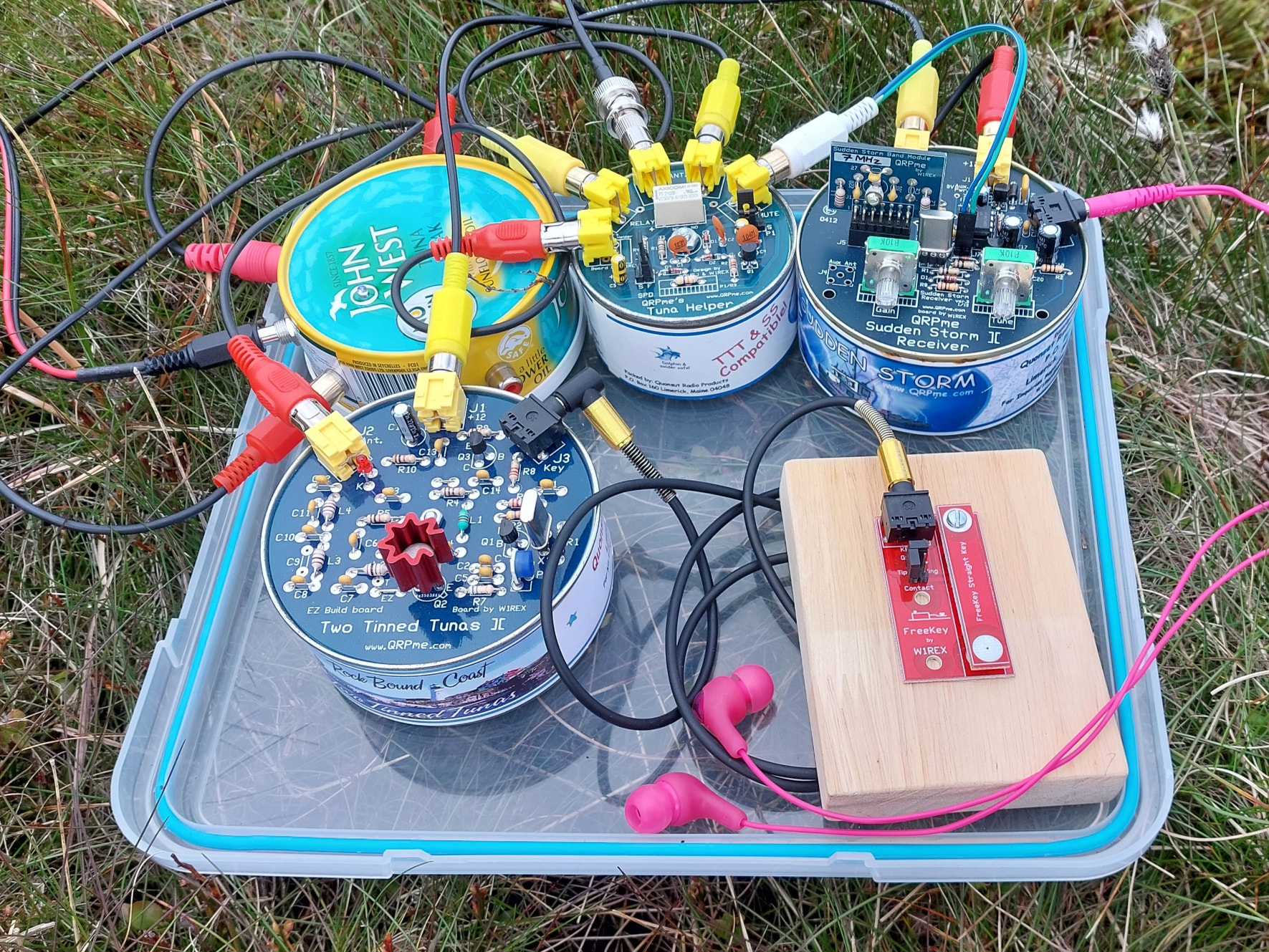

​My own journey with Tuna-based rigs started at a G-QRP convention in Rishworth, where I picked up a QRPme SUPER Tuna ][ kit. I’ve always found amusement in the quirky side of the hobby, and the fact that the components arrived sealed inside a genuine ring-pull tuna can was irresistible. My collection grew steadily until I simply ran out of kits to buy!
​Admittedly, these kits are entirely unsuitable for SOTA. The components are exposed and vulnerable to the elements—but I suppose that vulnerability just adds to the challenge.
​The Activation: Fair Snape Fell (G/SP-007)
​I wanted to celebrate the 50th anniversary with a summit attempt this month. After some correspondence with Richard, G4TGJ, the stars aligned for a joint activation today. I hastily grabbed a few tuna cans from the shack shelf last night, and had my fingers crossed that they still worked!
​We met near Fell Foot and made the trek up to the summit. A chilly breeze greeted us at the top, so we took shelter amongst the peat mounds to set up.
​Operation: “Open the Tin”

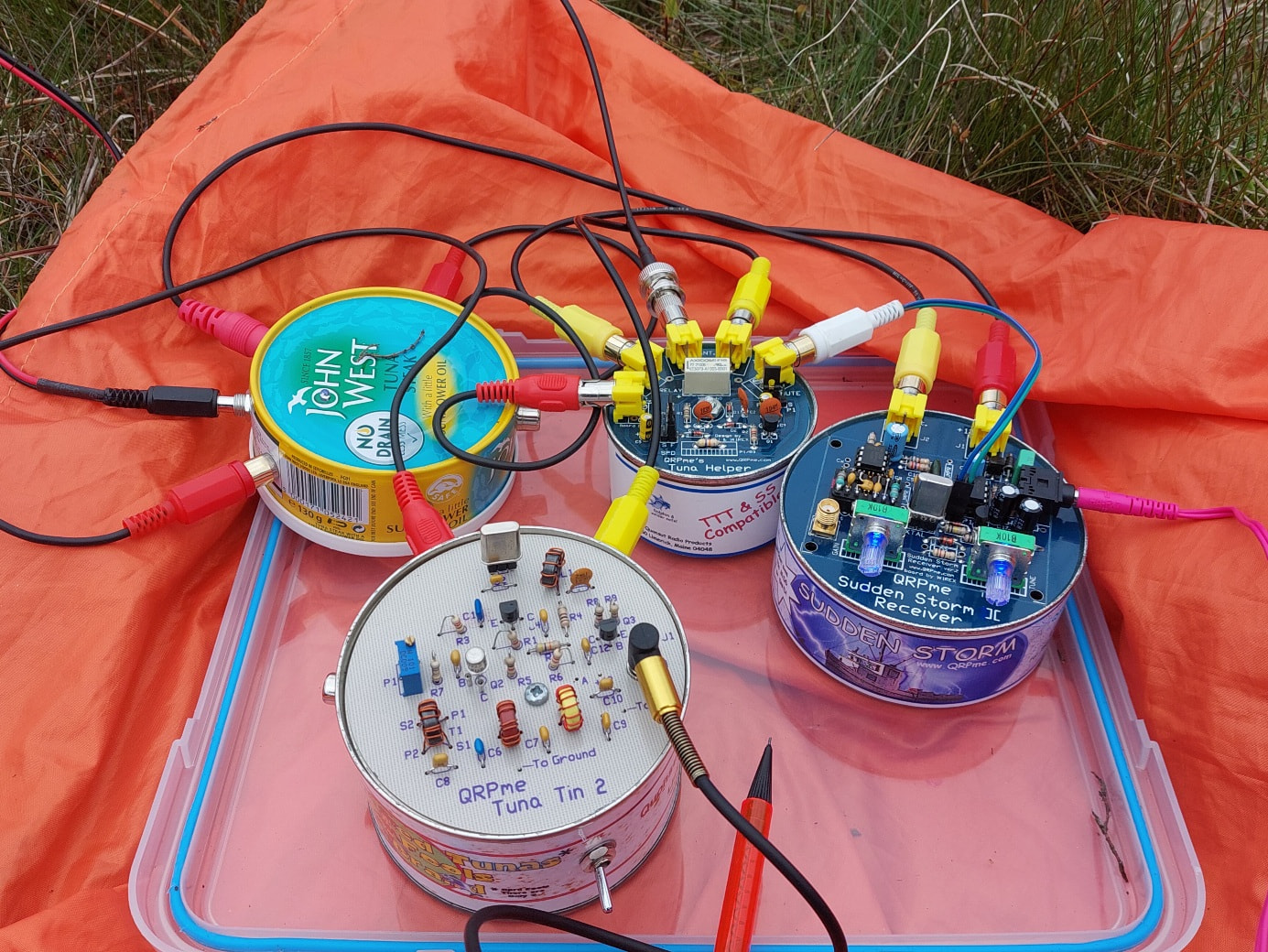

​Assembling the station was a delicate process; I checked the wiring several times before nervously applying power.
​40m: I managed 4 QSOs, which was a massive relief. The receiver is quite wide, making it a mental workout to determine if a station is actually replying to you or someone else nearby.
​20m: Encouraged by the 40m success, I switched to a 20m Tuna receiver and TT2 transmitter. I was amazed to be pulled out of the noise by EA7GV and OK2VOX.
​By that point, the effort of straight-keying in the cold had taken its toll, and I decided to pack away.
​Summary
​Qualifying the hill with novelty equipment was fantastic fun. It felt like a fitting way to mark a significant milestone in QRP history.
​Equipment Used:
​TX: QRPme Tuna Tin 2 (40m & 20m versions)
​RX: Matching Tuna-can receivers
TX/RX switching: QRPme Tuna Helper
​Key: QRPme ‘FreeKey’ Straight key
Antenna: 40m/20m linked dipole on 6m Decathlon carbon pole

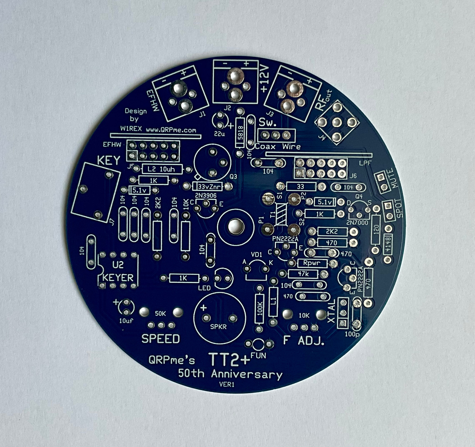

The special 50th Anniversary Tuna-Tin 2 kits are shipping, but has anyone seen the wiring diagram yet?
If not, does anyone know W1REX’s email address (still no reply from tunacankits ‘at’ gmail ‘dot’ com)?
EDIT I finally found the TT 2 topic here, so I’ll ask my question there

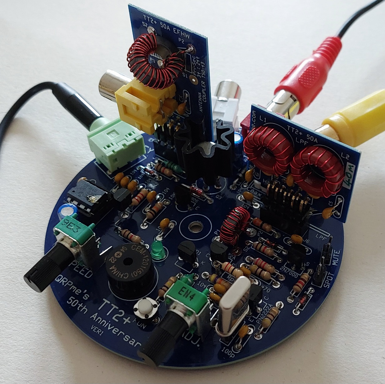

The TTT50A kit arrived a few days before I left for a camping trip to the Isle of Mull with my youngest son. I was busy getting things ready for my trip, so the radio kit was put on the shelf.
I’ve put the kit together over the past couple of days. Initially the transmitter didn’t work but then by sheer chance I saw an email from Rex in my spam folder explaining about a missing 2N7000 transistor. I’ve added the missing transistor this afternoon and now the rig is working as expected. I found a short on the EFHW coupler board, which I cleared with a sharp craft knife. There’s a power rail routed through the EFHW main board connector and unfortunately one of the corresponding pins on the daughter board is connected to the ground plane. An easier fix would be to clip the problem pin from the daughter board connector.
I’m yet to work out how to use the keyer chip!

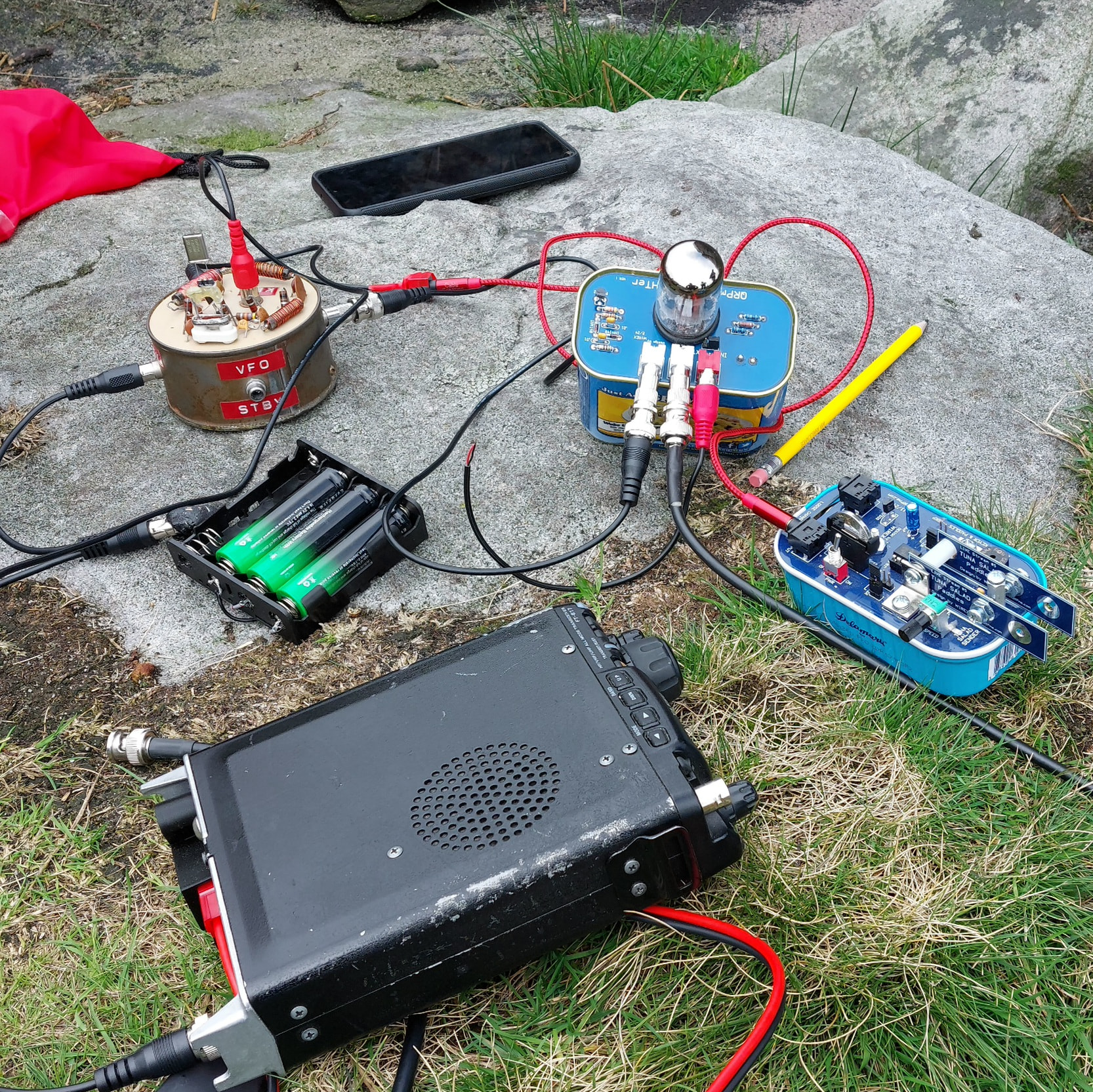

Rather unexpectedly I found myself doing another whacky activation yesterday.
Somehow, the stars aligned and I found myself completing a SOTA activation of Rombalds Moor G/NP-028 with the original W1CER (W1FB) 1976 Tuna Tin 2 transmitter.
I’m still letting that sink in… THE original Tuna Tin 2 that lives in a museum in the USA, being used for SOTA on Ilkley Moor!

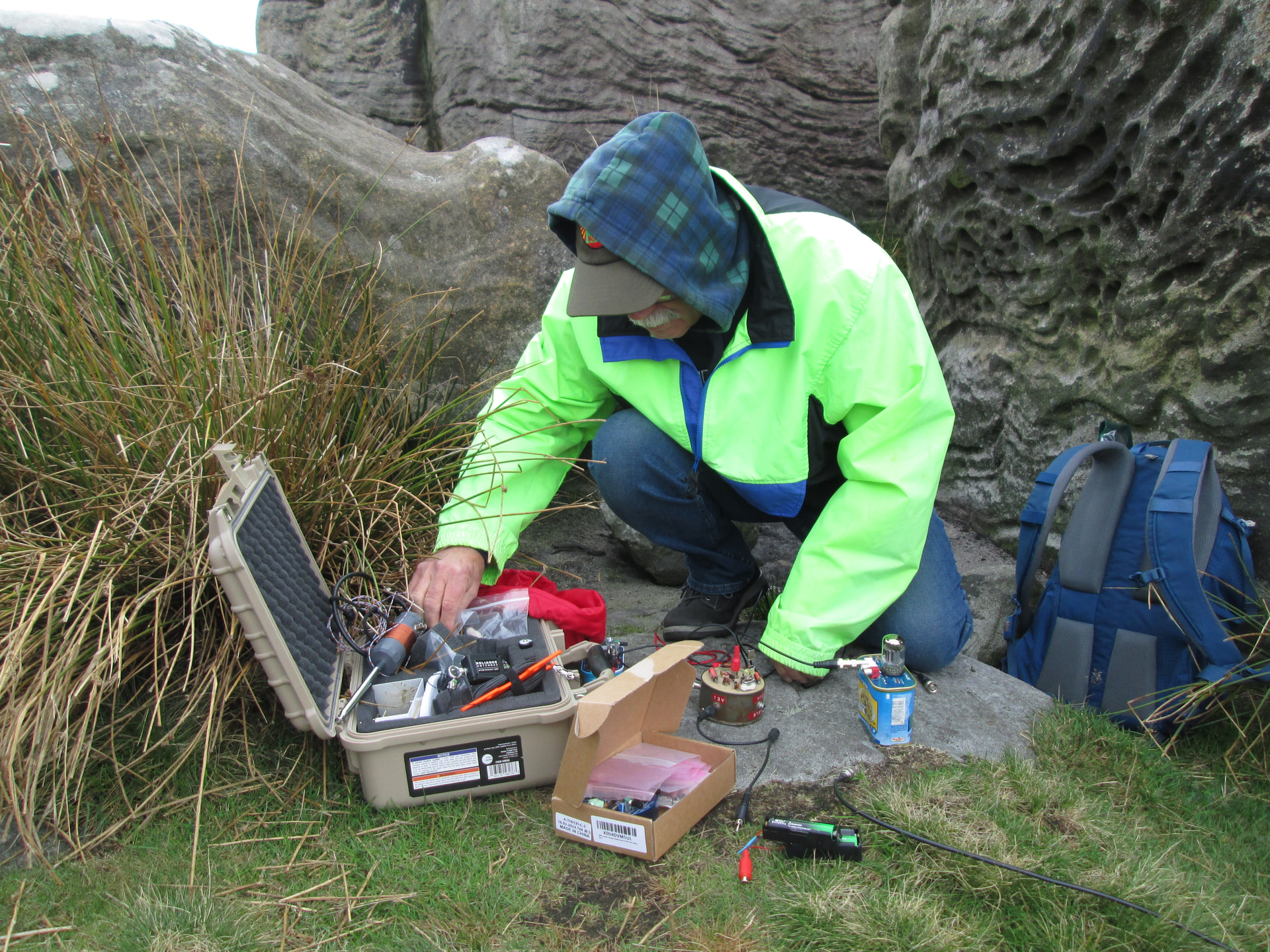

Rex W1REX doing a little last minute fault finding

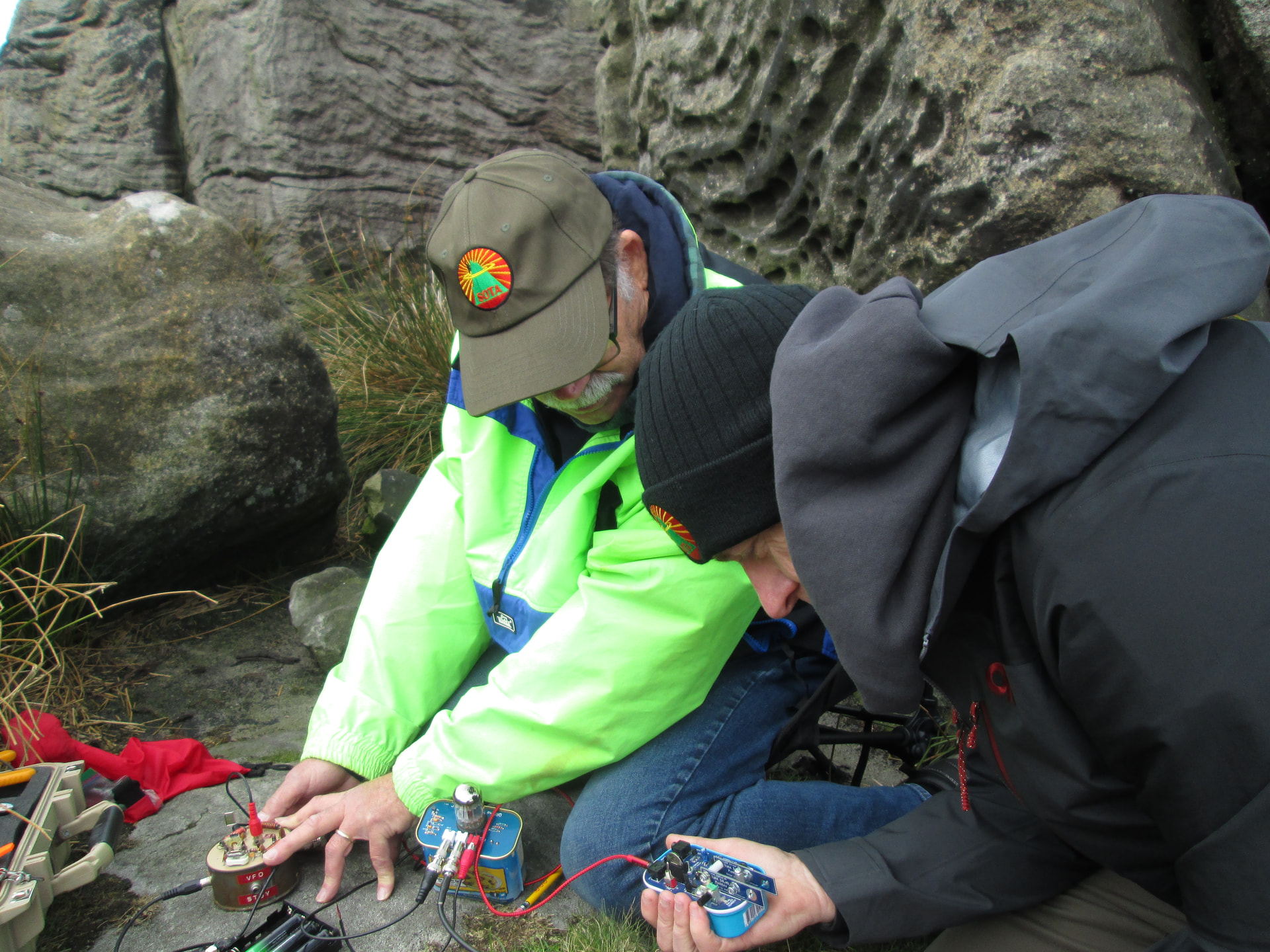

Rex W1REX and Charlie NJ7V

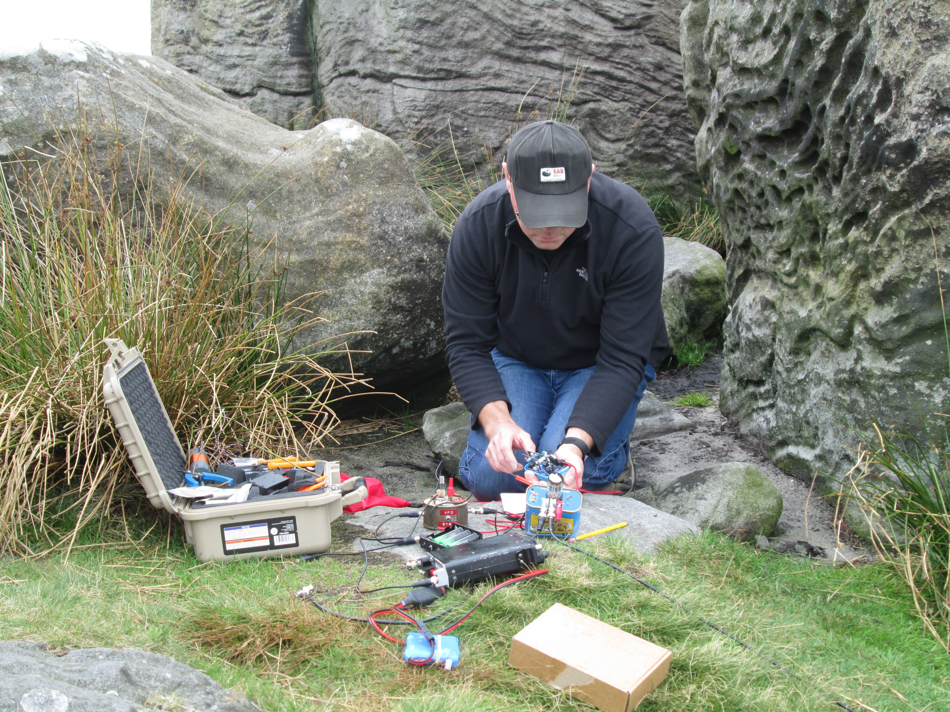

NJ7V, M1BUU, W1REX, M0KZZ and M0KOV
