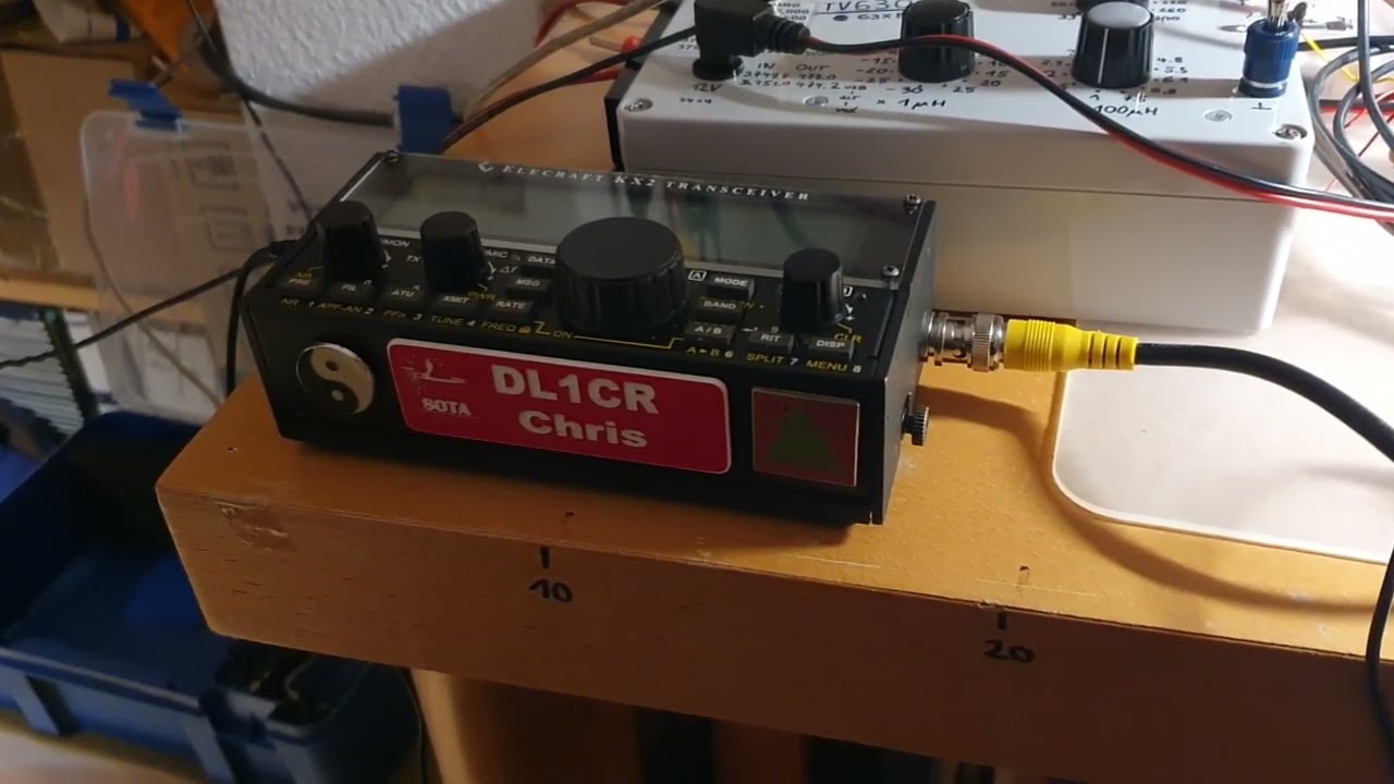

We plan to publish instructions and a circuit board for a 40m <> 630m transverter with a maximum of 50W and integrated antenna matching.
This will allow us to cover distances of up to 100km during the day and more at night. The digital WSPNet will reach the center of Europe.

My transverter is also based on G3XBM’s concept. The decoupling of the RX via the first capacitor in the pi filter short-circuited at TX by the antiparallel diodes, is brilliant.
I get just under 50 watts out at 24 V, and that’s fine for portable activation. I use a switchable toroidal coil with taps as the antenna coil.
Please tell us more about your concept. I will do the same later.

Chris, it’s still in the development stage. TX follows G3XBM’s design except for a class E output stage which produces 23 W at 12 V and since my ft817 is broadbanded the LO is 3MHz. For the RX side, I’ve tried both fet and ne612 mixers, the 612 seems the easiest approach, but I haven’t heard any stations to do on-air testing.
I was hoping that some TVS diodes that I’ve got from an old modem will short the TX and I’ll follow your approach.
Considering a T200-2 but will it give me enough inductance?
73 Steve

My approach produces only 12W at 12V. I will rebuilt and check it with more care. My version is more than 6 years old. On 24V it put out 50W. :scream:
That’s what I have done. I will try to onmit the ne612. The loss of the mixer is only -6db and the sensitivity of the trx should suffice. I will see.
I once took 2 of T240-2 with a total of I guess 132 turns with 2 step switches. One for each 10 and the other on there other side of the coil each one. So I can choose 1, 2, 3 … 132 turns. That brings up to 700uH. This is enough for my 10m vertical and 30m horizontal antenna. And I can tune it for best antenna current.
In my new approach I take one T240-52 and hope that it will do it with not more than n=50
Additionally I use an switchable impedance transformer with a FT140-43 for up 180 ohms. When your counterpoise is not the best the total resistance of antenna goes up to this value. The radiation resistance is near 1Ohm so you can imagine your efficiency is about 1%. :worried:
