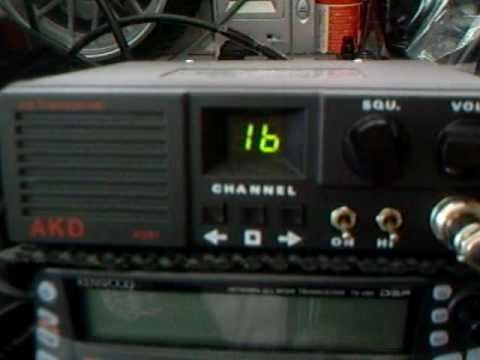

Sounds interesting, what is the rig, Mike?

Hi Adrian,
AKD 4001. Found this on youtube
