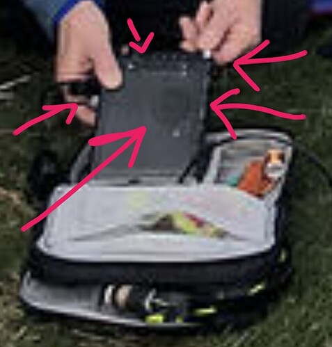

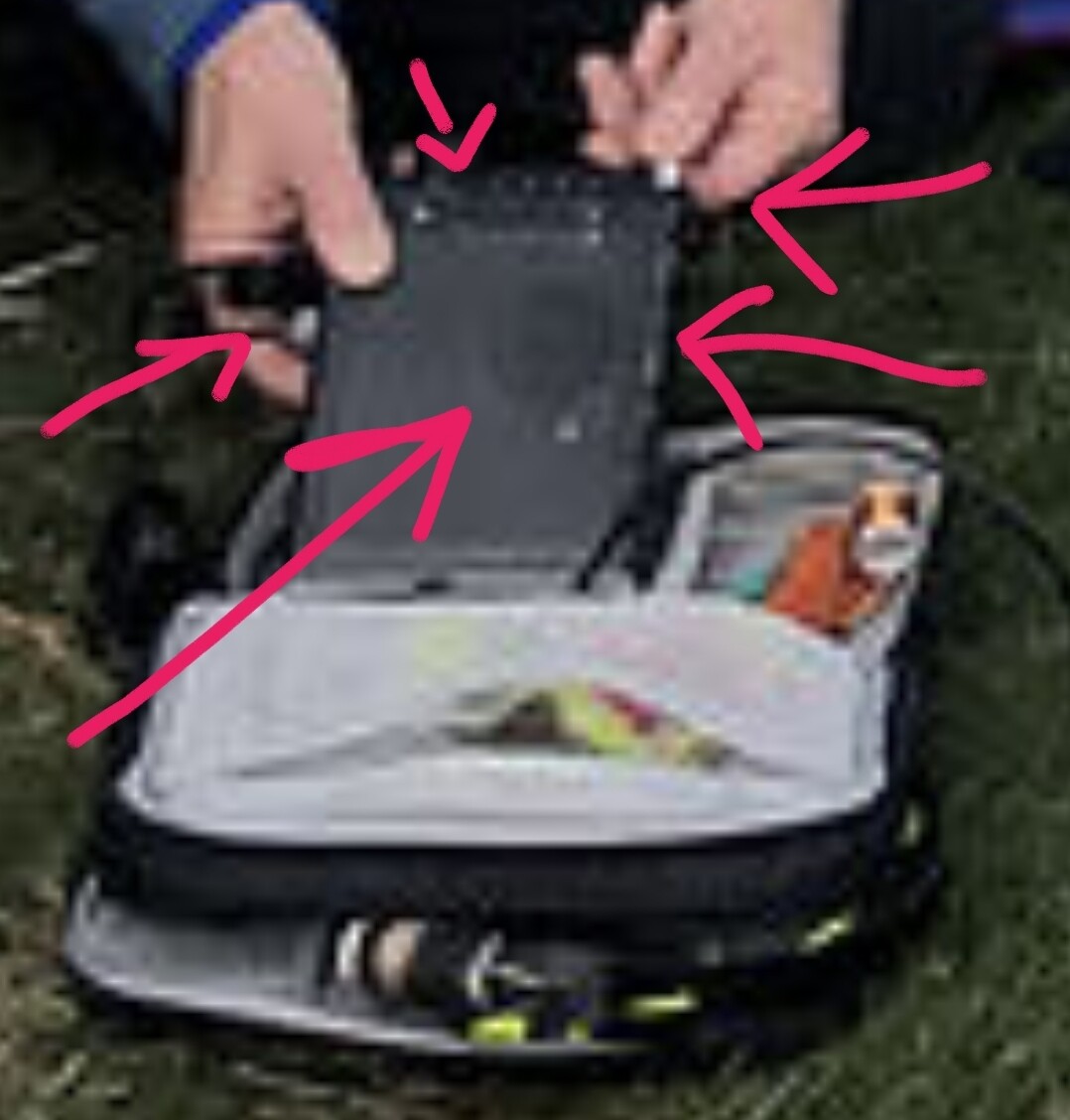

I initially read that as Roy Castle and was expecting to read about him appearing on a summit with a trumpet. :face_with_peeking_eye: :laughing:
Is that the lesser spotted Yaesu FT-290R? Excellent taste! :face_blowing_a_kiss: :ok_hand:
(if it’s anything else as I am only going by the speaker grille, then I take it all back! :grin:)
Every single word of this. 100%.

No.
No, a very battered Yaesu FT-817
I nearly went there as I thought I saw buttons lining the top of the head. Lovely stuff regardless. :ok_hand:

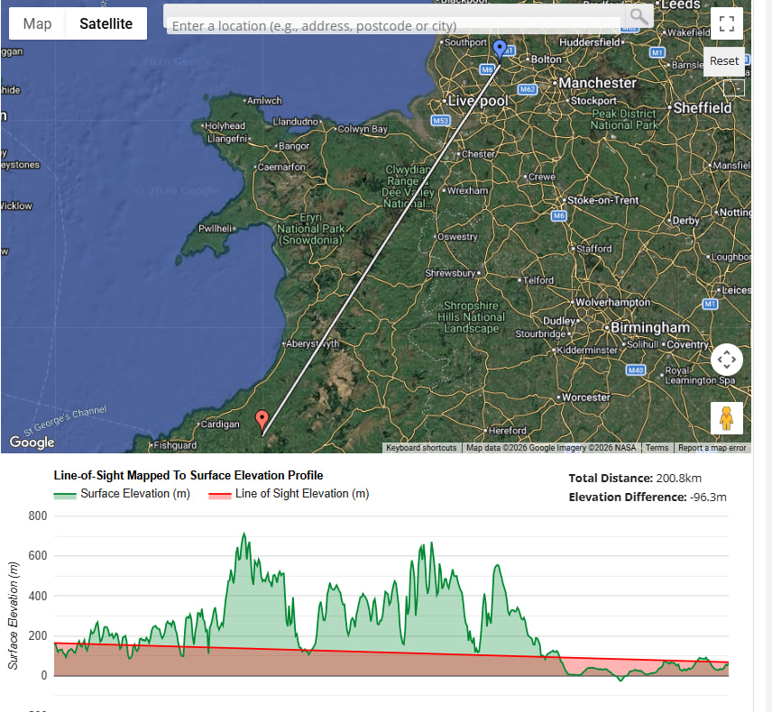

An interesting thing happened earlier today. While waiting my turn for Gerald MW0WML on GW/NW-012 Cadair Berwyn , he was called by Allan GW4VPX.
The thing was, I could hear Allan. Not very strong, but whilst the signal strength wasnt high, he was 90% readable. At just over 100 miles, it isnt going to break any records, but what surprised me that I could hear him at all considering there is a lot of solid matter in the way (map shown at the end).
I don’t know if he could hear me at all but thinking about it afterwards, I wondered if there was a way to try it out (without impinging on what the activator is doing).
What I may start doing, is once I’ve worked someone, is to goto 144.300 and put out a CQ just to see if anyone else just want a quick exchange of signal reports.
For Info: I was running 20W to a Vertical White Stick at about 5m.
Map and elevation chart below to illustrate the obstructions.

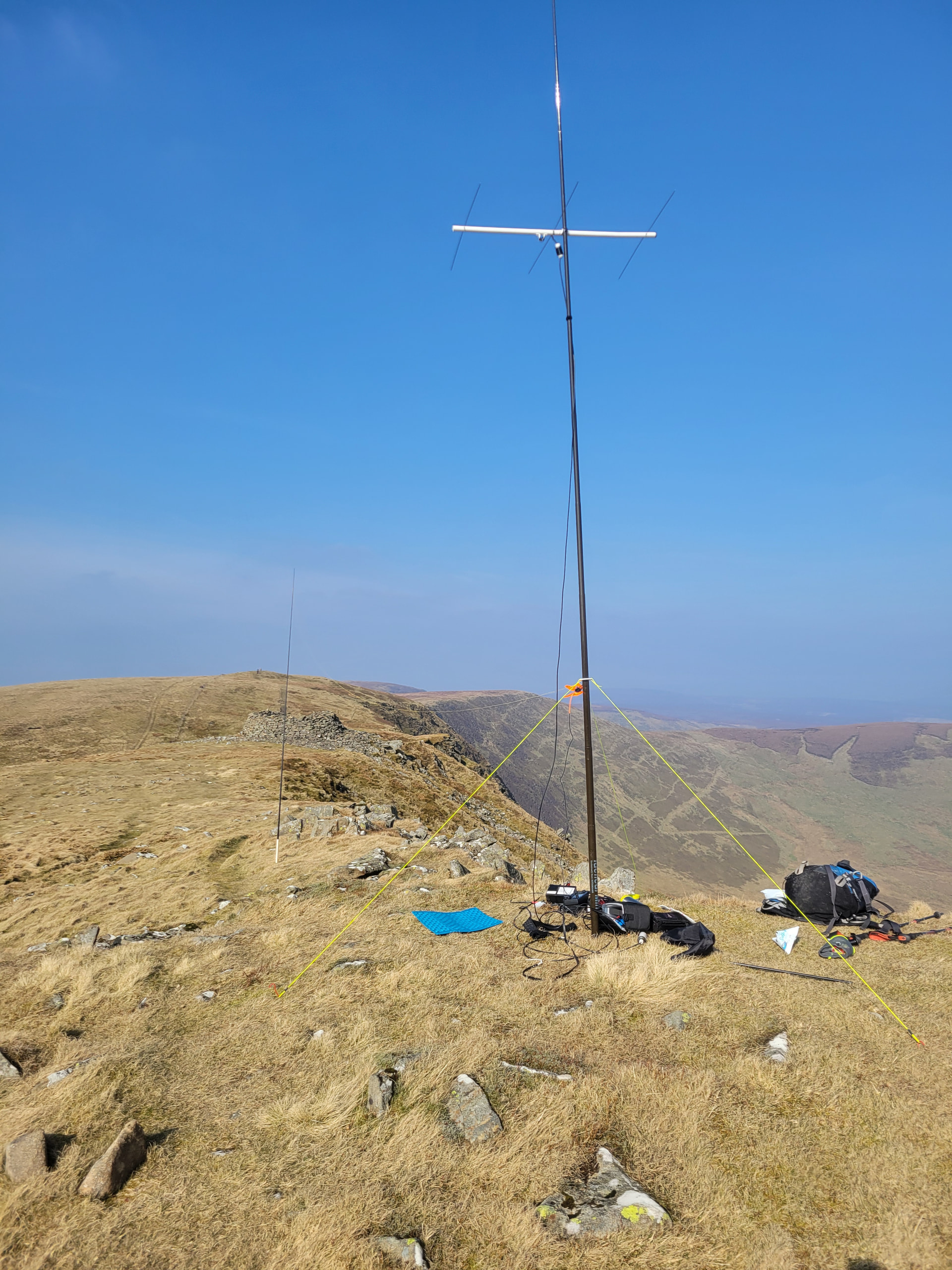

Threw the “kitchen sink” at it today, started 2m FM omni vert, then 2m SSB omni vert, then 2m SSB horizontal and finally HF (briefly due to losing freq in the contest mêlée)
73 Gerald
The thing is that radio waves do not follow a hypothetical line of sight. The refractive index of the atmosphere varies with height so the radio waves follow a gently curving path. Add to this the opportunities for diffraction over summits and possible aircraft reflections and apparently blocked paths will often yield contacts.

Echoing about what Brian said about non-Line of Sight contacts on 2m (and 70cm), there are a number of mechanisms that can cause ‘impossible’ radio contacts to be possible. VHF/UHF radio conditions have improved in parts of the UK during the last few days due to high pressure. These ‘lifts’ are ideal for creating tropospheric ducting.
e.g. Messing around at home Saturday afternoon with a new short pole/guying arrangement for my 3-el 2m Yagi I could clearly make out the Morse ID of the GB3NGI 2m beacon 237km away in County Antrim, N.I. My back garden is about 20m ASL and Whitbarrow Scar G/LD-056 is ‘blocking’ the path towards N.I. Normally, the Yagi would have to be on a hill to do that.

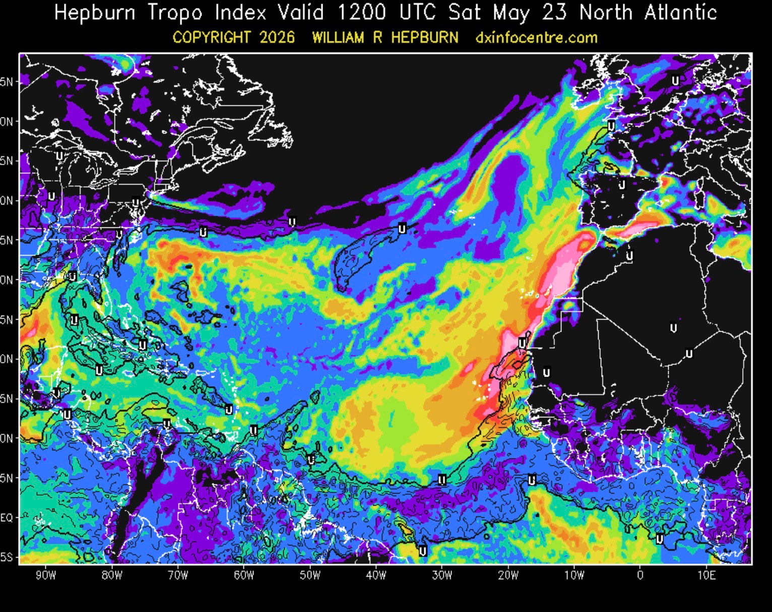

The tropo forecast is looking interesting for Saturday.
It may be worth trying to chase some 2m SSB activators that you wouldn’t normally expect to hear.
Also 433Alive activity day on Saturday (23rd) between 12:00 and 15:00 UTC so there maybe some SSB/FM action on 70cm too. The timings are not hard set, so maybe activity before and after too.

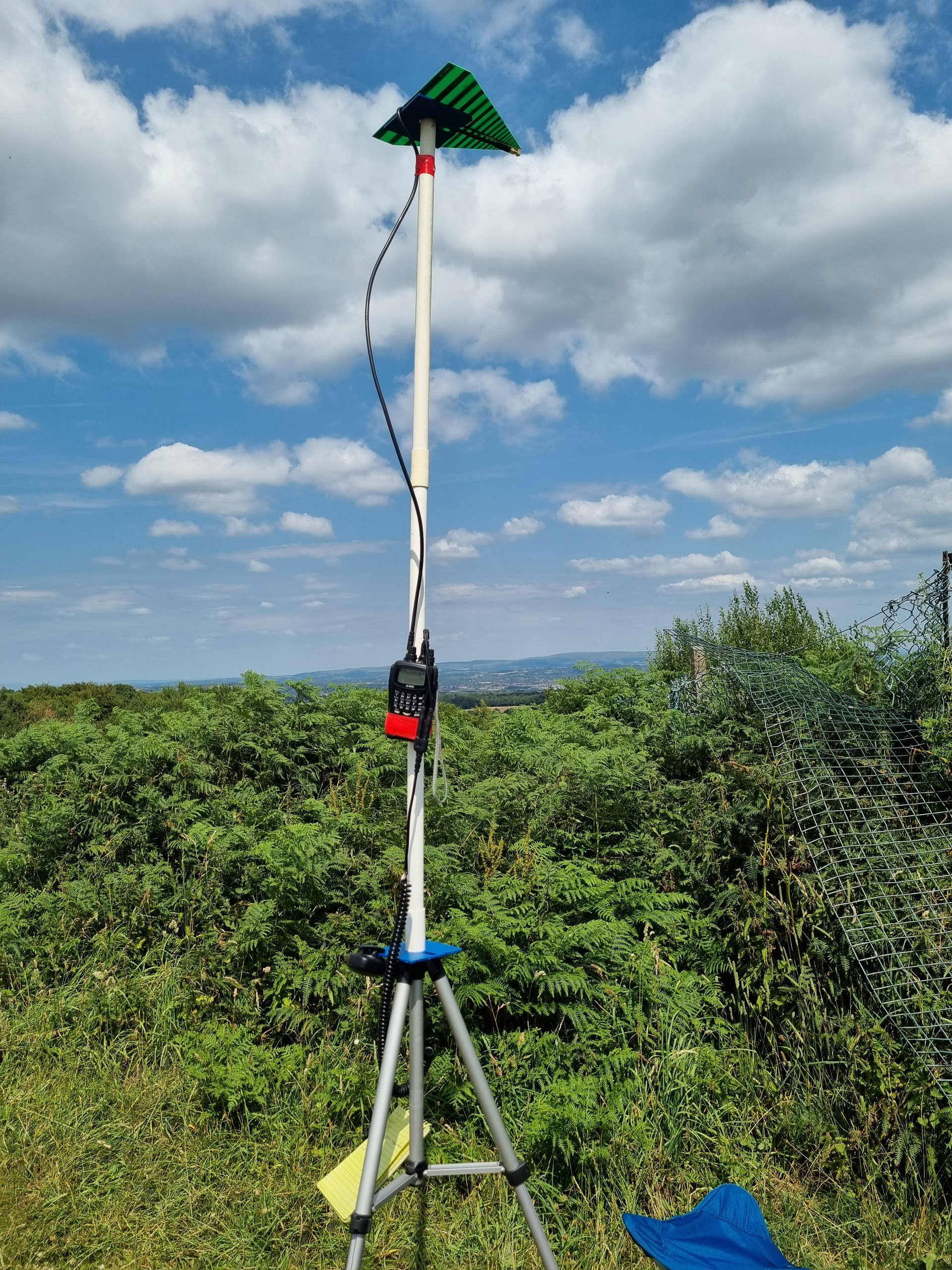

Spotted an Alinco DJ-7 triband handie on well known auction site. 1W on 23cm FM and works on 2m and 70cm too. Antenna is a pcb log periodic from Amazon which is taped onto a piece of plastic drainpipe and mounted on a lightweight tripod thing. Coax is 1m of something with sma-males on each end. Total cost <£200
