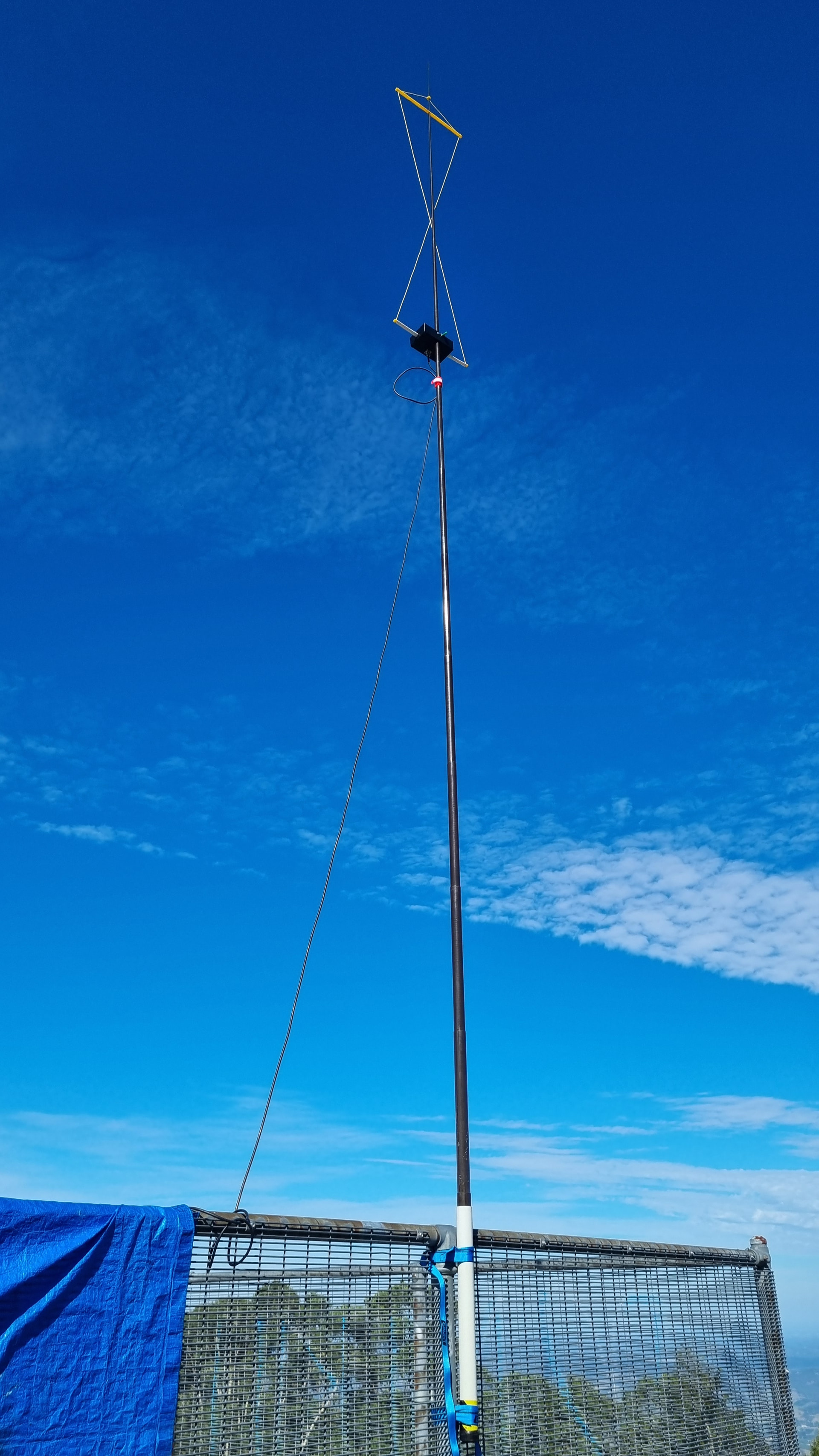

There are a some VK activators getting good results without carrying a Yagi to the summit. A single length of wire and a suitable support can do the job. CQ 270 CW SSB Gang! - Cool Kids Sip from the Hour Glass? - Equipment / Antennas - SOTA Reflector

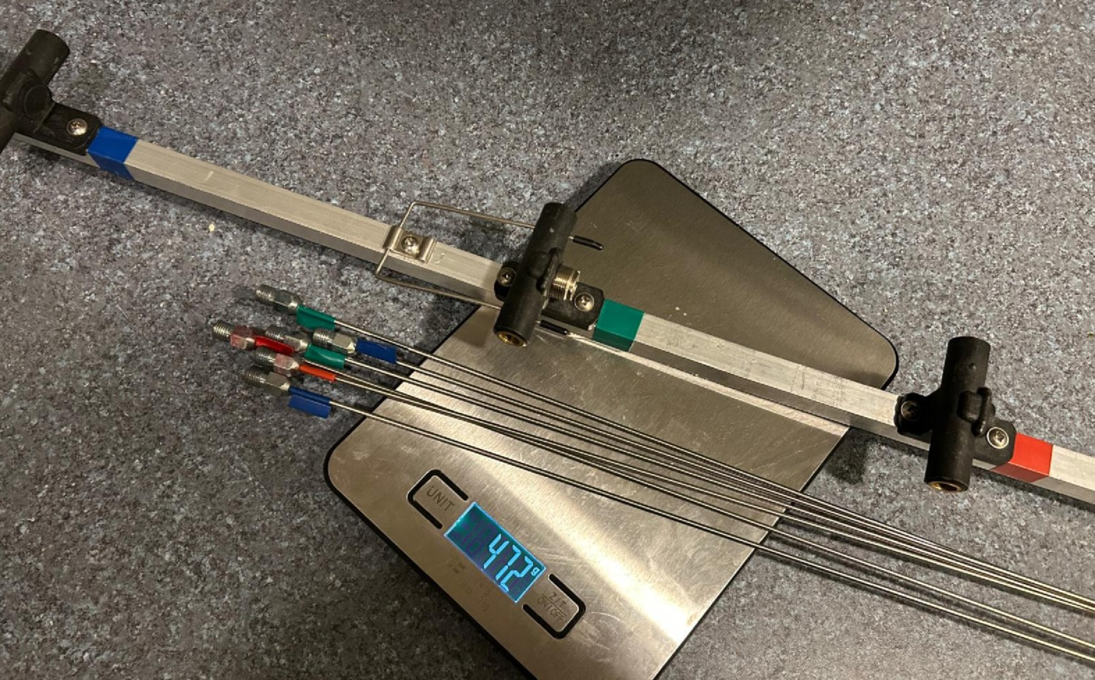

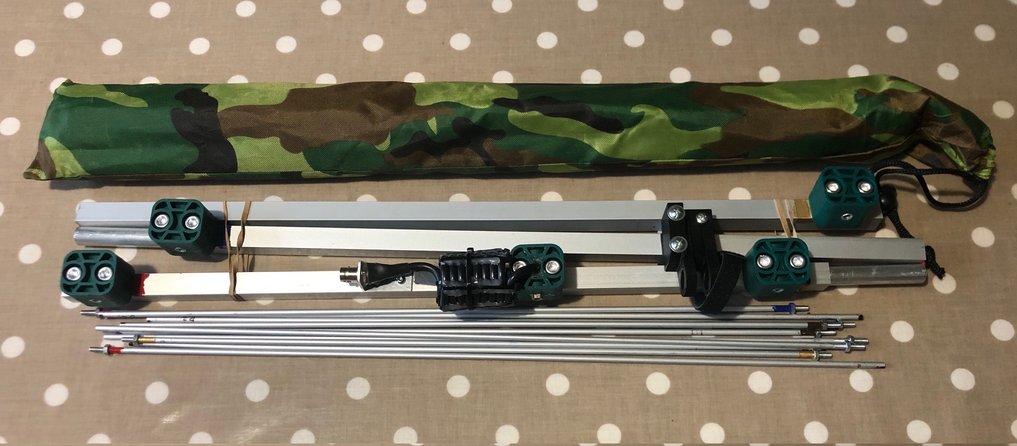

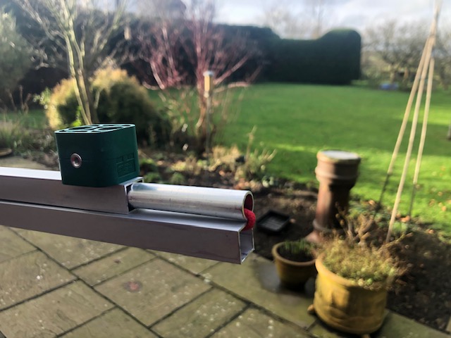

So, when it comes to a 2m Yagi, for many years I’ve been very happy with my (discontinued) Sandpiper 3-element 2m Yagi. For me ~7dBi is a fair tradeoff between gain and practicality.
The 6 element rods screw quickly into insulated blocks on the 31-inch boom. It fits nicely into a small shoulder bag or my largest rucksack [so in line with my ‘stealth mode’] and without its U-shaped pole clamp weighs about 470g. For SOTA I think the large beamwidth of a 3-el Yagi avoids missing someone calling you currently well off your current beam direction.
I haven’t tried Brian’s @G8ADD suggestion using it handheld. I see some problems: 1) I was QRV on 2m SSB and FM for ~40 minutes today on G/NP-010 and I’m sure my hand/arm would be aching a lot after that length of time, 2) I might have managed SSB/microphone with the one free hand but not CW/Morse key, and 3) I need to sit in a comfortable chair for most activations and I don’t see how that works for all compass points if you have to keep moving your chair to face the beam direction. So, I’ll stick with my tried-and-tested solution of the H-pol Yagi on a short pole next to my seat and where I can rotate the pole/Yagi combination 360 degrees without getting up.

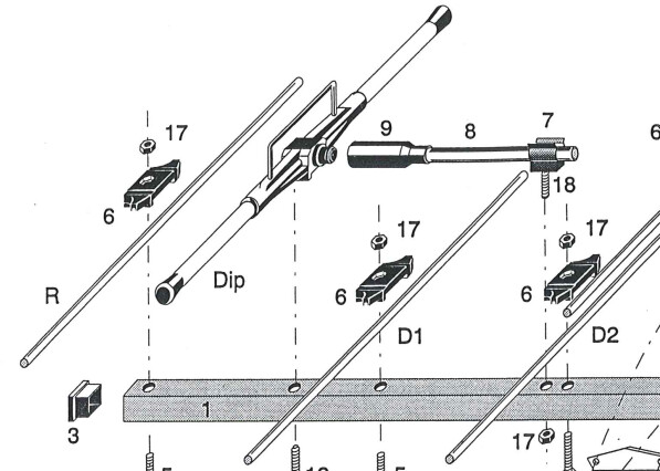

The company was Antennes Tonna and the company was originally setup by Marc Tonna F9FT in Reims, France. The antennas were high performance and very lightweight. They worked very well and were popular in W. Europe. Over the years I had many on my house in England a 2m 9ele fixed updated with a 2m 13ele fixed. On 70cm the 21ele was the business till bigger and better designs came out. So that was a 13 and 21 on one mast. I had a 6m 5ele on another mast. For portable work I still have a 2m 13ele. It was clever how the elements folded against the boom and the boom split into 4. I also have 2x 23cm 23ele. One is mint and the other suffers from the element fixings failing in UV light. To get around boom effect on such short elements, they stand about 6cm above the boom on plastic fittings.
Here you can see the elements (copper wire) on the standoffs from the boom.
They used a type of balun called a Bazooka. This was a 1/4wave long aluminium tube that slipped over the feeder and was a snug fit. You connected the N plug to the socket on the antenna and the bazooka had a plastic end fitting that clipped over the N. The far end of the metal tube clipped to the boom which was earthed. This acted wonderfully and the feeders were nice and RF free.
Here’s a grab from the manual… #8 is the bazooka balun, #7 grounds the far end of the bazooka and #9 is the plastic N connector weathershield.
Much DX worked on 6/2m & 70cm. Including on 2m Iceland via SSB MS and Ceuta and Mellila (both EA9 African islands) via SSB Es.
EDIT: 2m 9ele installation manual: G1OGY.com::Projects

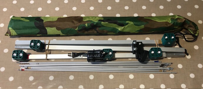

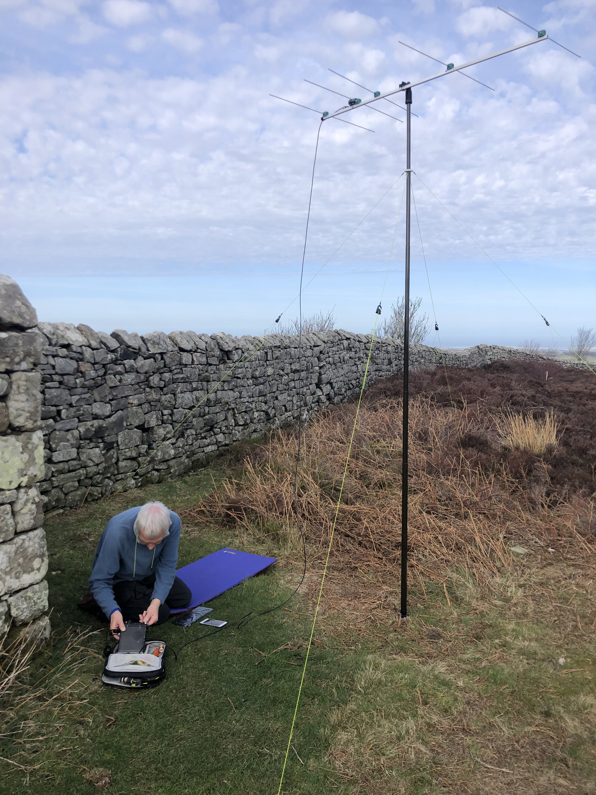

Seeing the picture of a Sandpiper 3el, made me want to show off my new compact design​:grin:
Ros Castle G/SB-009 was the first outing of my new “Jackal” 2m 5el Yagi. Weight 600 g including the 3D printed bracket, folded length 560 mm.
Rather lacklustre performance, probably because I couldn’t get PoloHam2k spotting to work. There’ll be nothing wrong with the app, just the operator. Good to get Andy G8CPZ over on G/NP-010.
