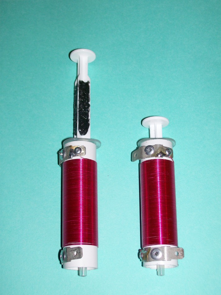

I used my SOTAbeams BH4 80/40/30/20 dipole with G4YSS loading coils to tune it for 160m. I haven’t used the loading coils for quite some time. Not shown in the photo is that I painted the slugs white and used a sharpie to mark graduations on each at equal values of inductance.
I started with the loading coils at mid inductance and with just one tweak on each coil (less inductance), I had good VSWR on 1.832MHz. The system is quite narrowband, so significant frequency excursions require a re-tweak.
