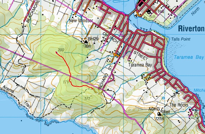

ZL3/SL-322 - Riverton/Aparima
A short walk half on-track, half off-track to a low summit in native rata forest above Riverton. Bush is mostly quite open, but requires some skill at off-track navigation.
This unnamed summit lies in rich coastal rata forest in a council-owned Mores Scenic Reserve (ZLP/SL-0097) above Riverton. There’s a grassy picnic area and parking at the end of Richard St, with enough room for motorhomes / busses if not too busy. Camping is not allowed.
Light green - limits of council reserve
Two tracks start from the picnic area - the main track is the Ta Araroa Trail, and is well signposted - that’s not the one we need however. Instead - nosing around in the grassy picnic area to the right of the main track, a small signpost marks the start of the Mores Lookout Track. This well gravelled track leads through lush forest to the westernmost of the two 171m highpoints and ends. From there you need to nose your way 800m NNW through untracked but reasonably open bush, crossing a gentle saddle to reach the 200m SOTA summit. A map+compass or GPS is advised and the terrain isn’t quite as simple as the maps indicate.
The sea-stunted rata forest is quite open and running a 40m EFHW was straight forward. We were there in flowering season, and the entire bush was carpeted in the fine red strands of rata flower.

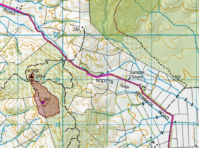

ZL3/SL-298 - Otautau
An uninspiring summit lying in commercial forestry, apparently accessible via PAE’s (public access easements) along forestry roads. Straight-forward walk along forestry roads.
This unnamed summit is accessed from the summit of the Scotts Gap - Feldwick Road. A large turn-in at the entry to commercial forestry gives ample access for parking. This is part of the Te Araroa Walkway, so their website is the best spot to look for track closures due to forestry activities, or you could contact Matariki Forests directly.
The signpost at the entry-point lists the rules. No vehicle access, stick to the PAE roads, and wear hi-viz being the main points.
Both the trig point and the higher southern summit lie within the AZ.
