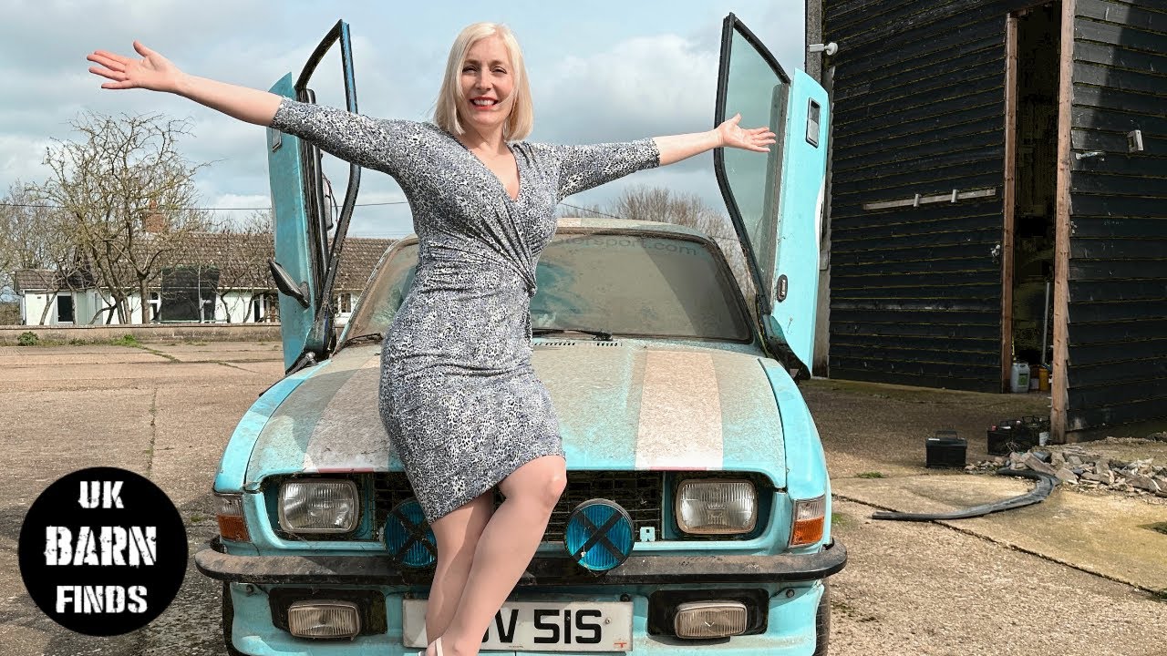

Austin Allaggro Equipe.
Rarer than an underwater hairdryer. Belissimo!
