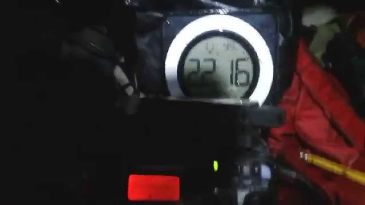

My regular summit is on the outskirts of Stoke. I’m up there often on Tuesday nights for the RSGB VHF contests. Including in winter!
Not got an FT1X yet but here’s a video of me operating in “challenging conditions” on a Tuesday night of years past!
