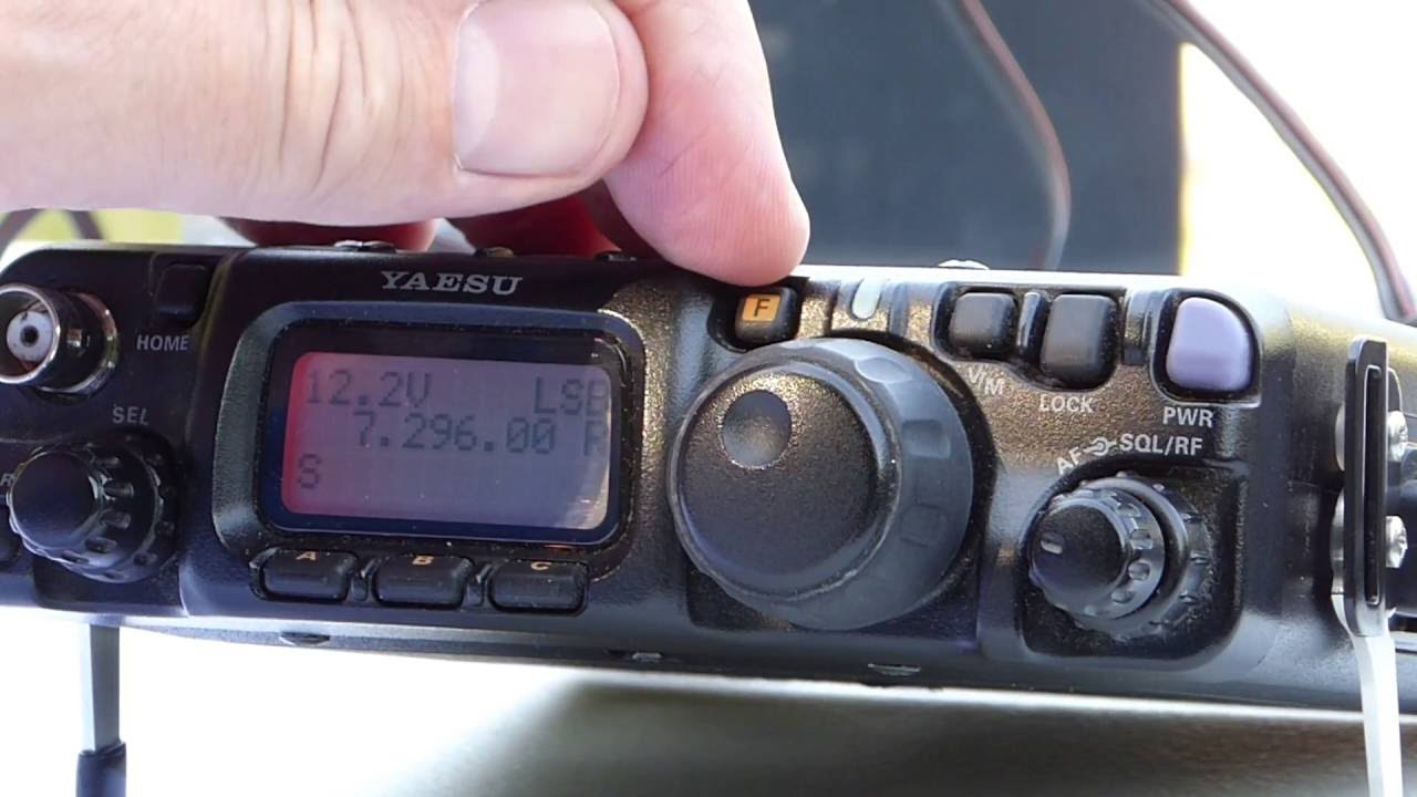

There are a couple of things you an try with an FT817 that cost nothing. They may help, but if they don’t, you still have the option of buying and installing a filter.
The first thing to try is the “IF Shift”. The instructions are on page 24 of the manual and enable you to move the existing filter band pass higher or lower (without changing the receive frequency the radio is tuned to), and so use the edge of the IF band-pass filter to remove an interfering signal that is close by.
The second thing to try is reducing the gain of the receiver by engaging the “IPO” function (essentially turning off the Rx pre-amp), engaging the “ATT” function (rx attenuator) and using the manual “RF gain” control (which is often disabled and use for a squelch function). This process is explained clearly in this U-tube video
