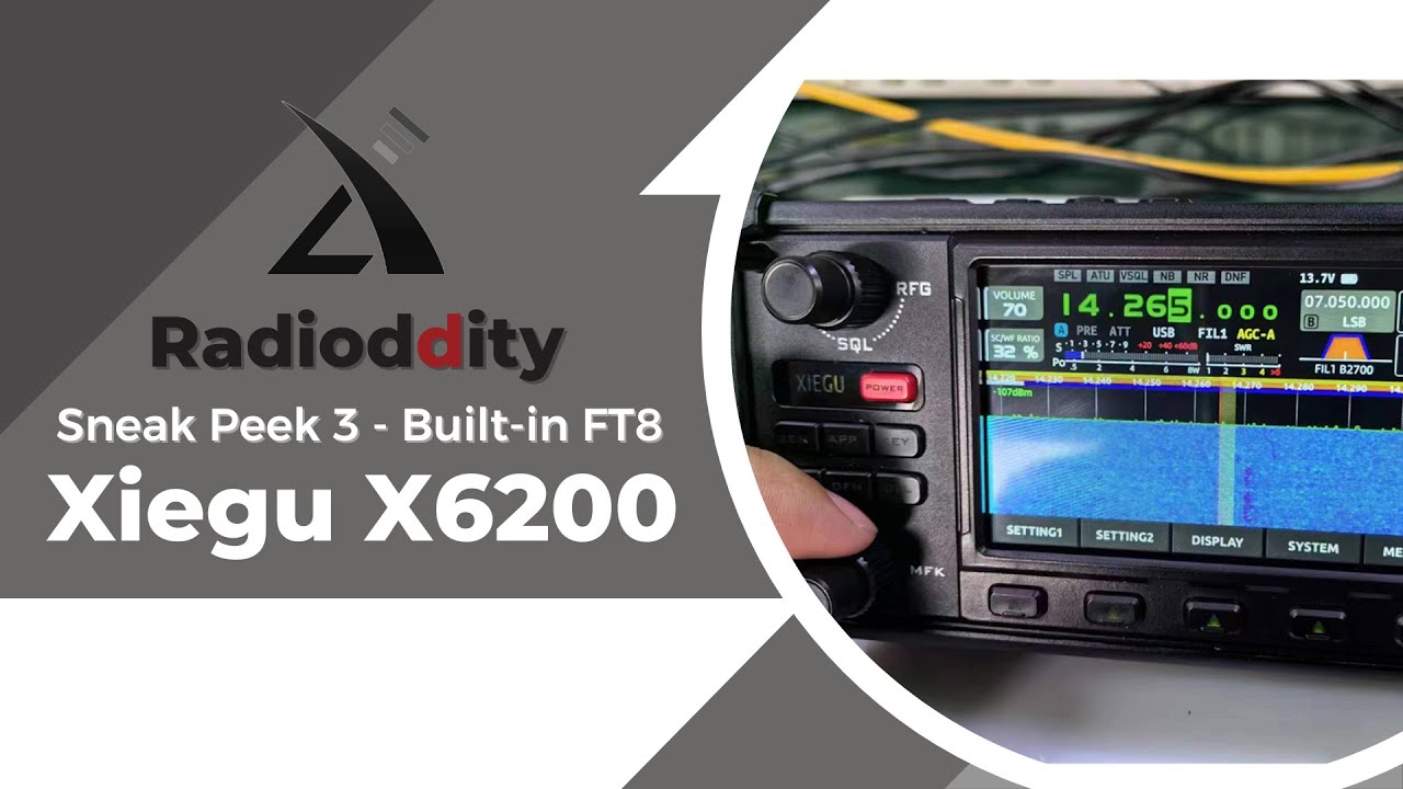

For those who may be looking for it - The X-6200 has built-in FT8 in the latest video:
73 Ed.
That is neat, but with the 6100 I can receive with a USB C cable and a iPhone/android app. The part I would love to see is ability to transmit… this would make is really viable for SOTA FT8. So far i can only get that working with USB-C CAT control via a PC/Mac and i’m not lugging that up a decent peak!
