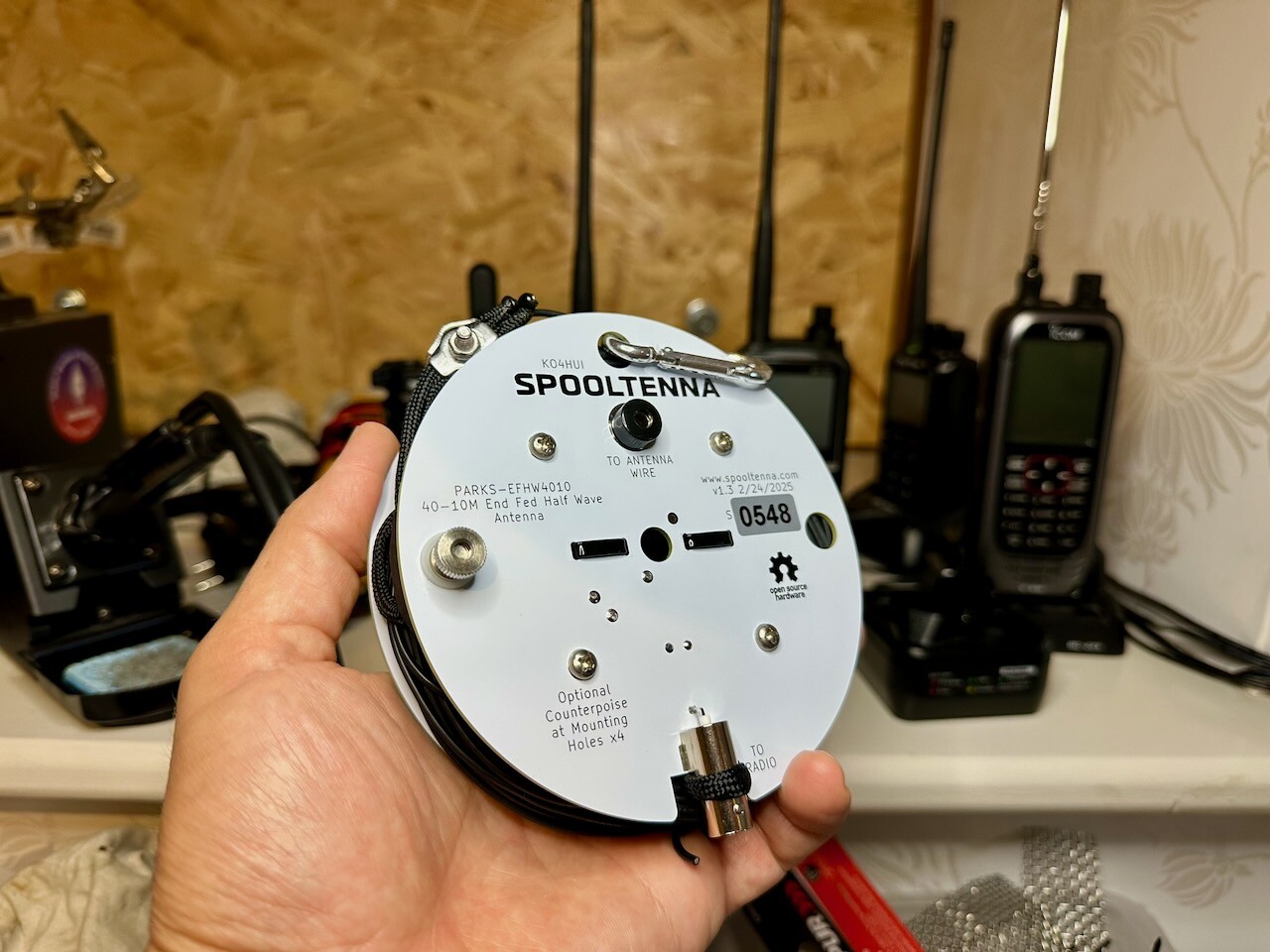

TL;DR: Tuner = superfluous, power unlikely to make much difference, weight / bulk might.

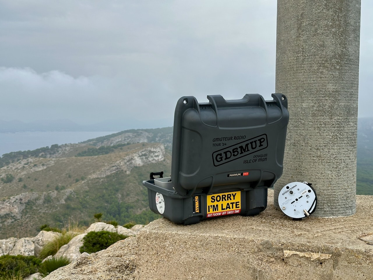

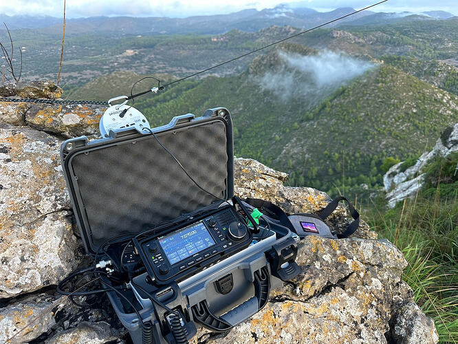

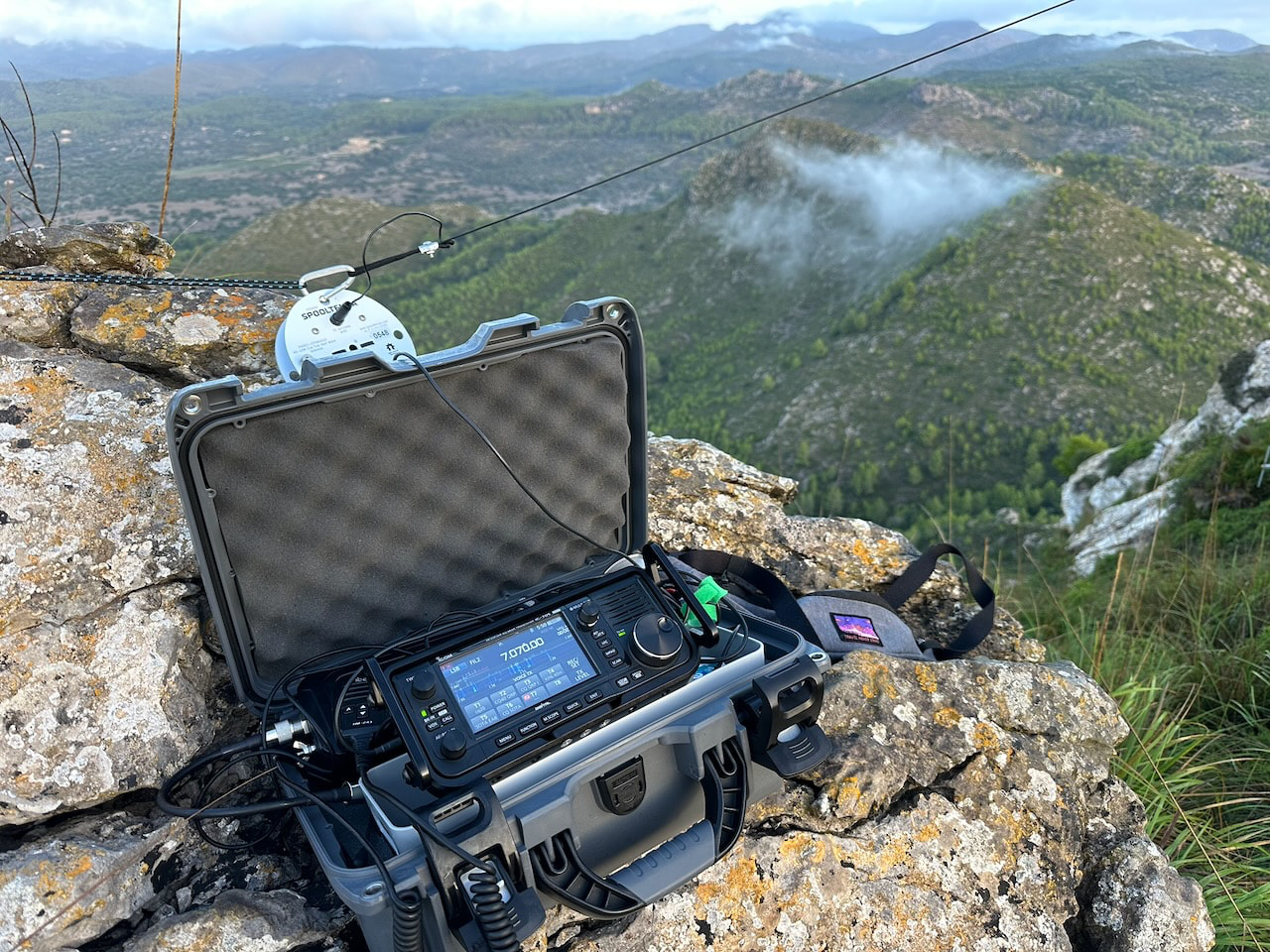

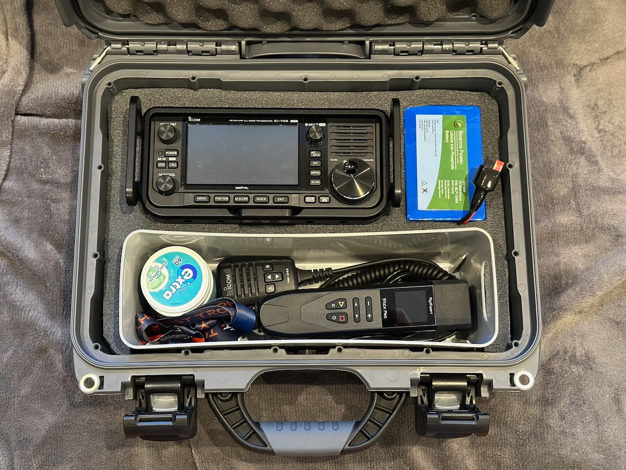

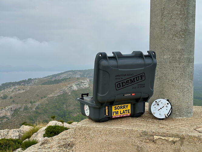

Set up a meth lab, spend the profits on Icom IC-705, Spooltenna, and some Bioenno batteries. :winking_face_with_tongue:
I’m super happy with the above setup in all but one aspects: weight / bulk. So far I haven’t found a way of adequately packing that lot into a hike-friendly pack with room for more than a light lunch, bottle, and waterproof layer, but to be honest I rarely pull all-day activations or anything more extreme than a light bit of scrambling. Often I just hand carry the radio gear in a dedicated Peli case for the hour or two that a holiday activation will take, but I admit it’s a pain for longer missions. The good news is that you can easily ‘simulate’ carrying a larger radio before committing to owning one - ballast is plentiful and cheap.
Getting back to your question, I don’t think that the increased transmitter power of 20W will result in substantially more activations. Occasionally when I’m at home I’ll turn the power down gradually while counting and ask the other party to let me know when I fade out, and the results are often surprising. I doubt that you’d notice a real world difference on activations, especially if you can spot yourself.
Where antenna tuners are concerned, others have mentioned the benefits of a resonant 40m EFHW and I completely agree, which is why the Spooltenna is my go-to choice and the reason that my AH-705 stays at home these days. A tuner is just bulk, and at the end of the day it won’t make a wet piece of string resonant, it’ll just make it electrically acceptable to your transmitter, with the caveat being that it might ‘unlock’ an additional band on a multi-band antenna which would otherwise not be available to you.

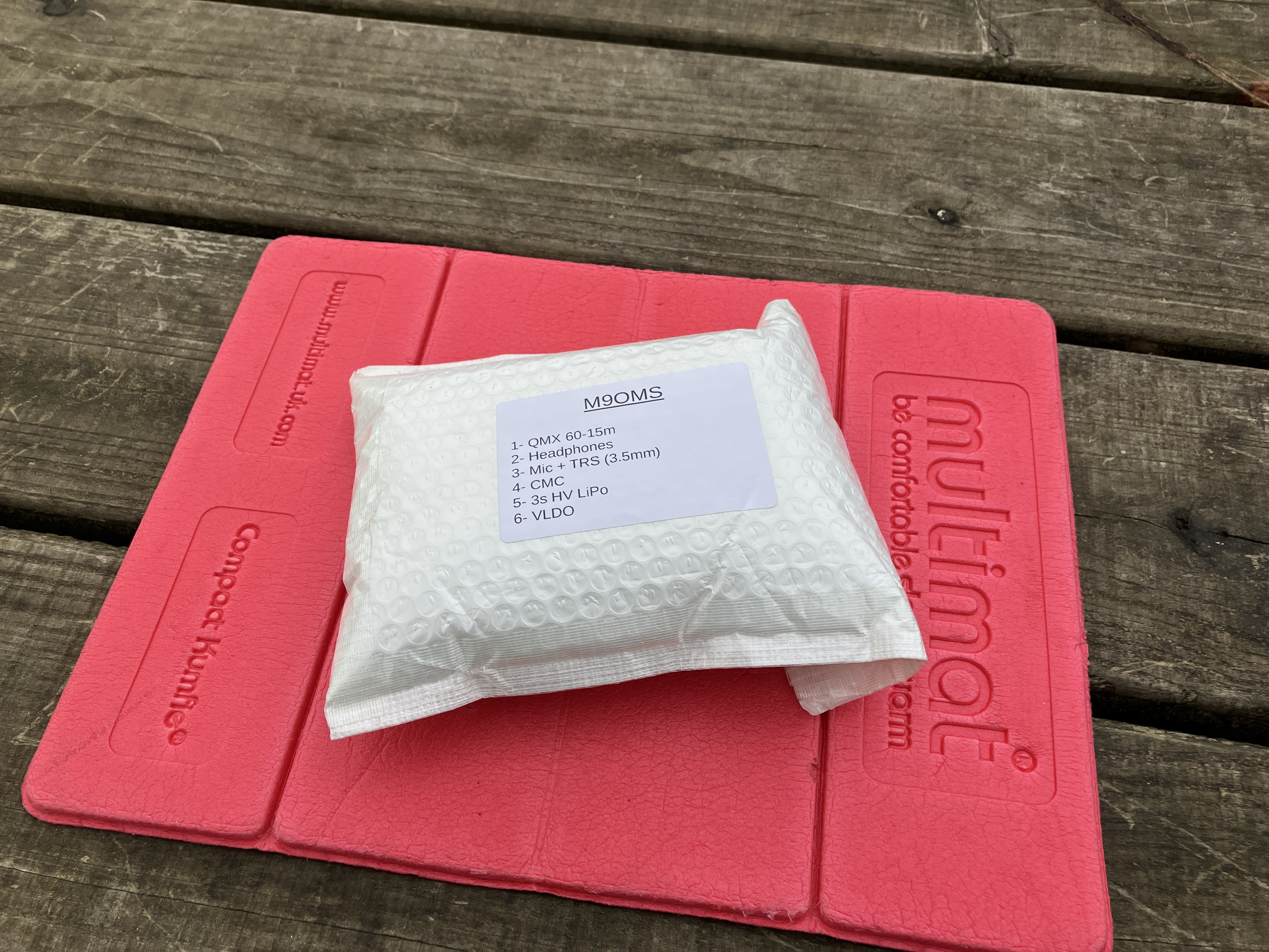

Everything I need (apart from antenna/mast/coax) fits into a padded envelope. Yes, I’m feeling smug. :joy:
