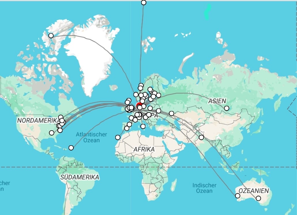

At home in the half-million-strong city of Hannover, a 40m loop has been hanging in our huge attic for 12 years. The local QRM has increased to over S9 over the years, making it practically useless.
I was about to take it down, but then I thought of WsprNet. A digital beacon system that also serves as a scientific method for researching solar activity. Usually, you need a PC and a transceiver to operate it. And an interface for automatic band switching.

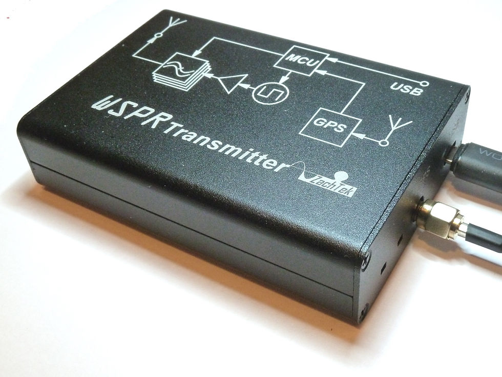

A standalone transmitter is much simpler and more cost-effective in the long run. I use a WSPR desktop from ZachTek www.zachtek.com for 80-10m with GPS and 200mW out. Now I can get an idea of the conditions myself before activating a summit. I look for my results on https://wspr.rocks/.

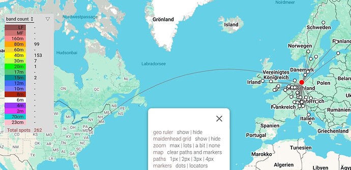

Peter, I took your advice and now transmit with 20 dB attenuation and only 2 mW. Amazingly, it still works, even across the pond. Thats 3176000km per Watt :star_struck:

WOW, Chris! I tried 1mW several times but never got a report from USA.
Yes, its fun to see that very low power is able to be readible far away!
