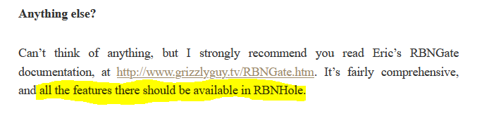

RBNHole says all features “should be available” but what you posted is ambiguous at best. Is the 60 minute criteria carried over from RBNGate as indicated by the snipit? The 10 minute lockout appears to apply only to an initial spot.
It’s a simple question. I have RTFM but there is no specific answer to my question in the documentation available.
