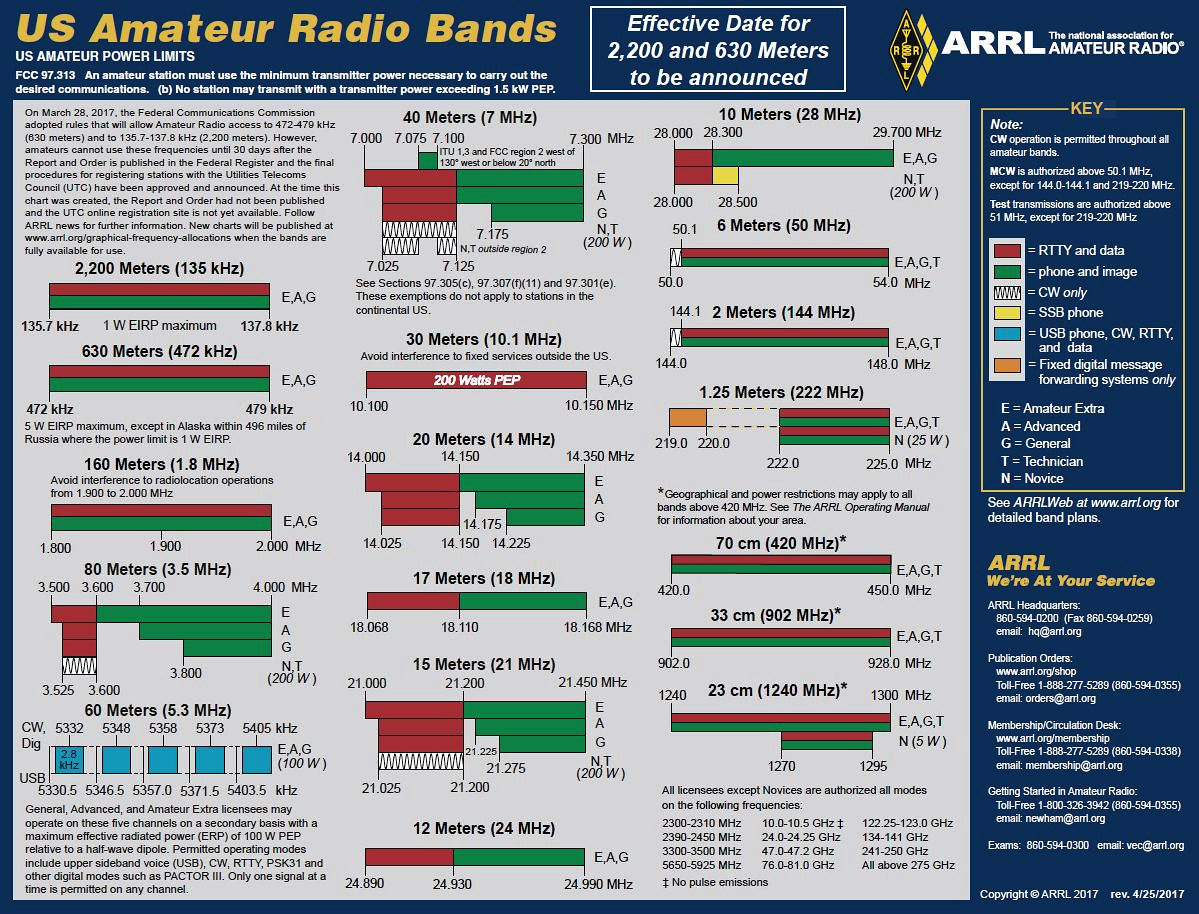

Yes. Apart from the extra 100Khz that Americans enjoy on 40m (which I didn’t use anyway), everything else matches up. You just need to be aware that tech licenses in the USA only have access to some of the 10m band, but a quick check of the ARRL bandplans will reveal all.

I reckon Andy @GM4LLD has got the measure of it:
Cracking resource, thanks Fraser. Reckon I’ll be printing and laminating that if / when I take HF gear across the pond. Talk about complicated!! :face_with_monocle:

Thanks for this Fraser, I’ve printed a couple of copies for my California trip next week.
