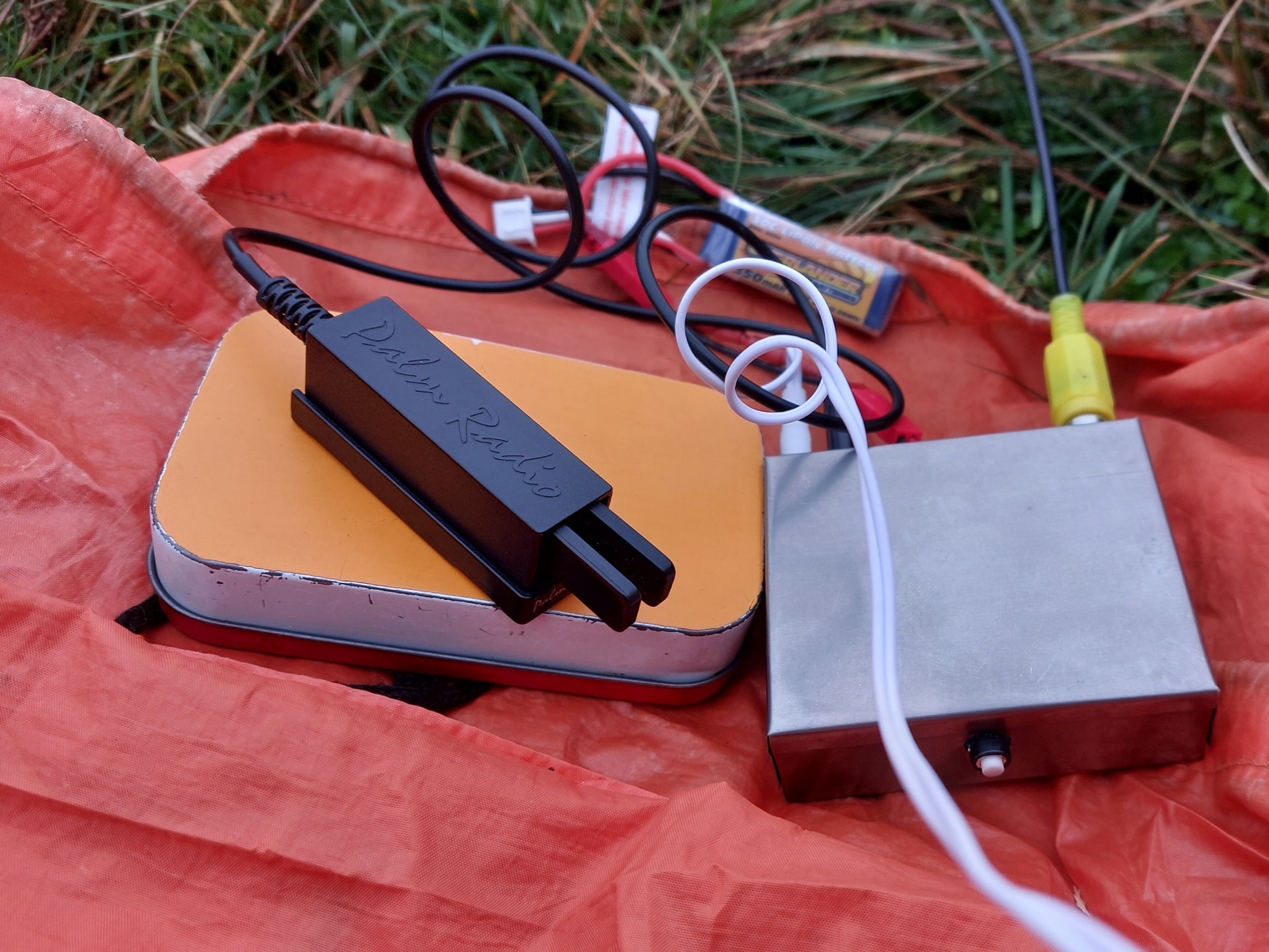

The Palm Mini is quite easy to hold in one hand whilst operating with the other. The Palm Pico is a bit more difficult, I often find that after a while I become uncomfortable, sometimes with pain in my hand. I store my Pico in an Altoids tin and using the tin as a base, I find it easier to hold.
I use the Palm Mini with my FT-817 mostly and I use the strong magnets in the paddle key base to hold the key to the radio. I can operate the paddle key with one hand. I can operate the Palm keys as quickly as my Kent Twin desk key.
There are holes in the Palm bases for mounting options, so you could use screws if the magnets aren’t strong enough.

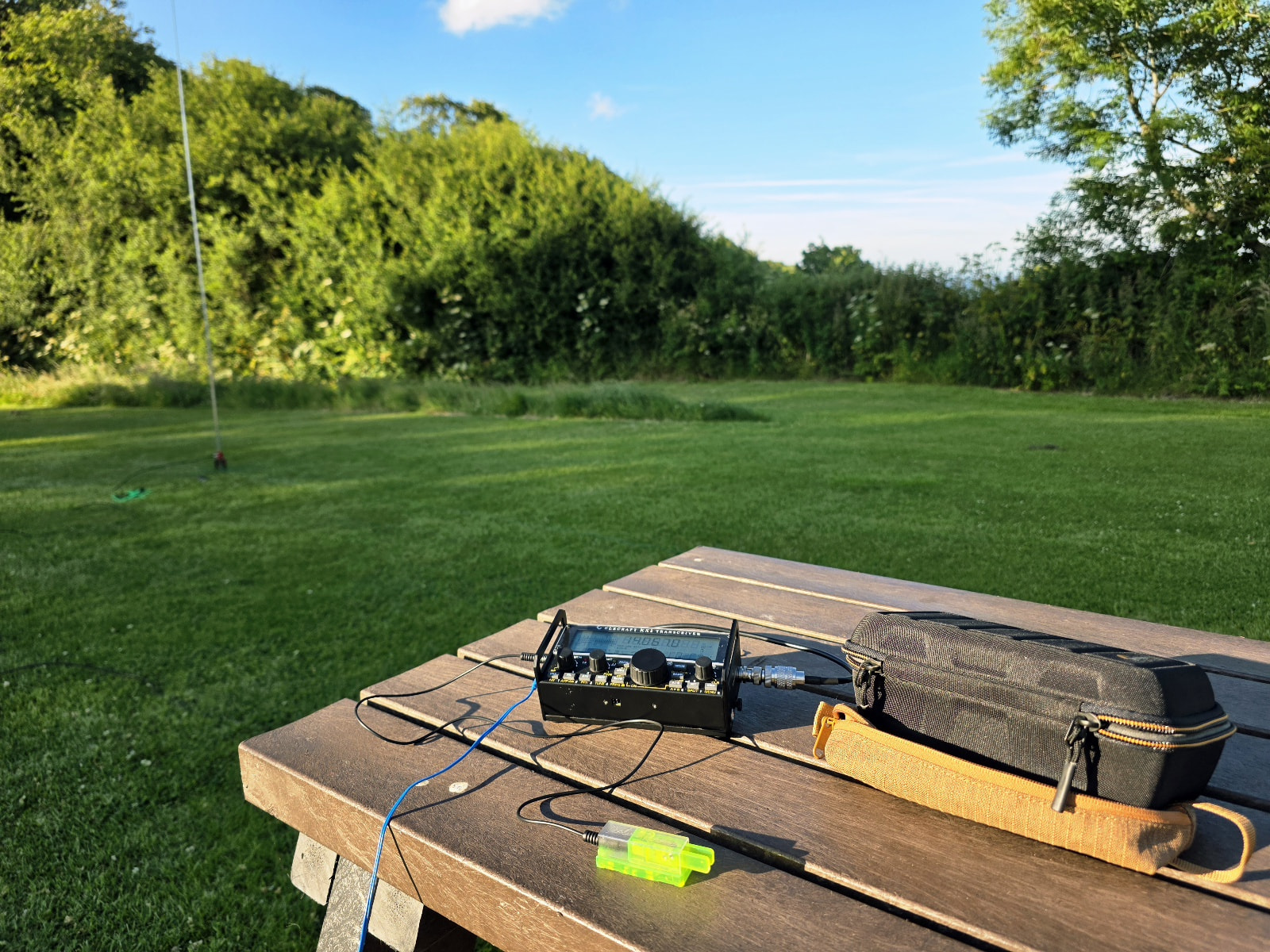

Another vote for the Palm Pico. I have the lime green one but would love to get the orange one as well some day just because it looks ace.
