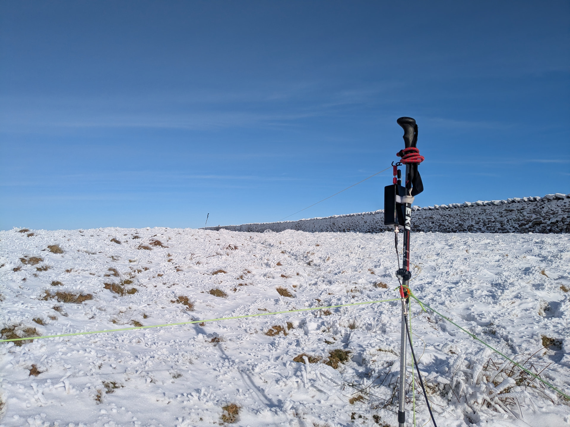

Every so often someone posts on here that they left some vital component in their car or back at home. I think what amateurs! I’d never do something like that. Well on Saturday I got to the summit of Whernside G/NP-004 and took out all the kit from my rucksack only to find there was no pole. What an idiot!
Initially thinking it was going to be a disaster I wasn’t going to give up so I strung my EFHW wire between my two walking poles. The wire was no more than about a metre above the ground and dipped a lot in the middle. I started on 20m CW and was pleased to see an RBNHole spot almost immediately. I had 12 QSOs in as many minutes. Every time there was a new call or when I got a 579 signal report there was a big smile on my face.
I also got a few S2S QSOs on 20/30/40m but my CQ on 30m didn’t get a spot from RBNHole. I normally start my activations on 30m and it was only by chance that I started on 20m. I might have been disheartened if I had tried 30m first and got no response.
I also had my FT-65 with a long whip and I had a number of S2S including into Scotland and Wales as well as a few to neighbouring summits.

Definitely a “Diving save” move with the walking poles.
Did that on Sear Sandal. I strung my antenna across the rocks. Not quite the number of contacts you got, but activated.
I wonder what the minimum you can get away with…

I’ve strung mine in a gorse bush on a VERY windy day…. got perfectly acceptable results. Sometimes I wonder why I both with a pole :slight_smile:

For a horizontal EFHW one reads that the optimum height for 50-ohm matching using a standard 49:1 transformer is generally 0.25 to 0.5 wavelengths above the ground. Clearly, your walking poles are not that long. Okay, so there’s some loss of RF power into the ground but not so bad that one can’t get and give good signal reports. And for NVIS on the lower bands (e.g. 60m) it’s actually an advantage (but probably higher than walking pole height).

Pole-free activation has become my default for work trips where work gear + radio gear = too much gear. There is generally a boulder or slope to hang a sloper off, or a pair or rocks or a gully to string a cloud-burner across.
Compromised setups but less of a compromise than leaving the radio at home because it’s all too much weight to carry. And not one failure to qualify so far with that setup.
