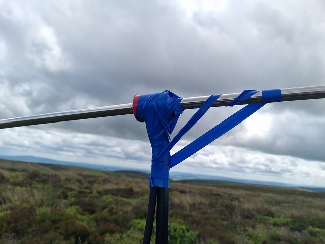

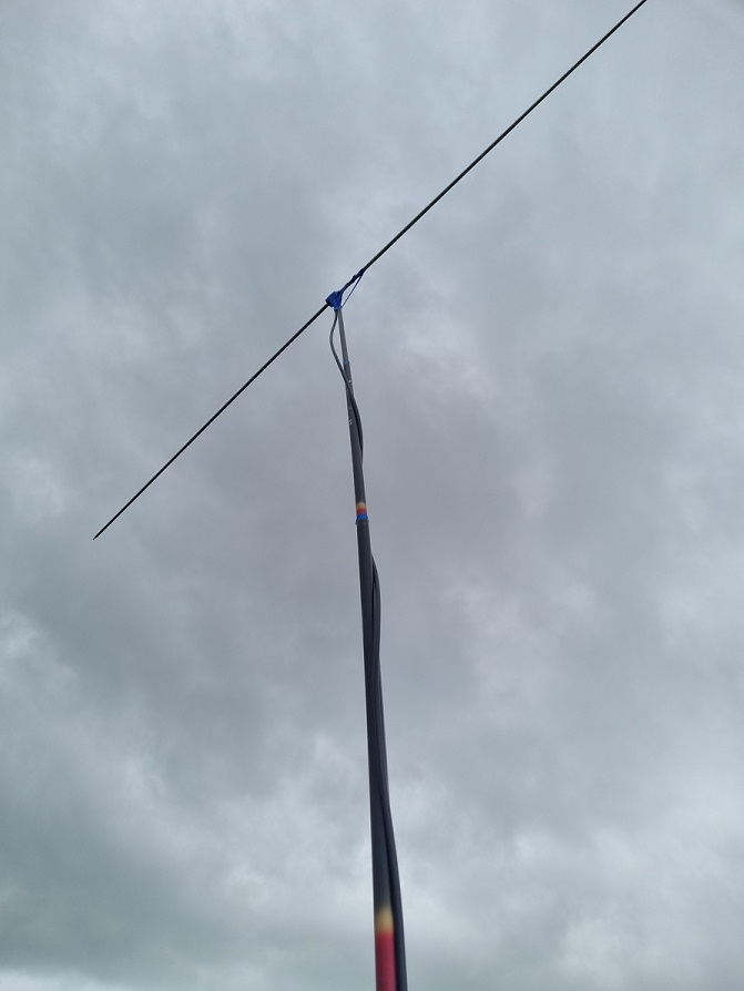

Take the screw in part of a JPC-12 with the so-239 socket and screw in 2 x 5.6m telescopic whips, adjust for resonance and away we go.
It worked mostly if a bit wobbly as a rotatable dipole, and I doubt it would stand much wind.
Pictures below.
The excellent method of mounting to a pole :slight_smile:
Up she goes
Ian
2 x 5.6m sections seems to be double the required length for a half wave dipole. Or is there something i’ve missed? Oh, one section is the mast. (Later edit: they aren’t extended fully, so make two 3m sections)

The 5.6m whips are telescopic and only extended to make a traditional half wave dipole. Used these since they were what i had on the summit.
Probably could have made a 20m dipole but that would have been very unstable.
Ian
