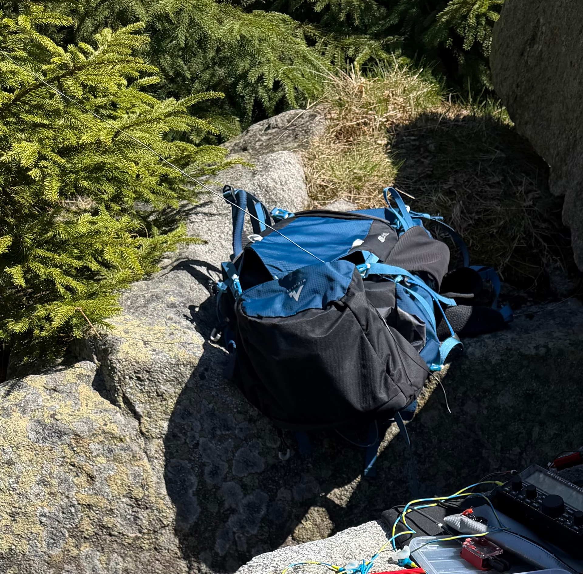

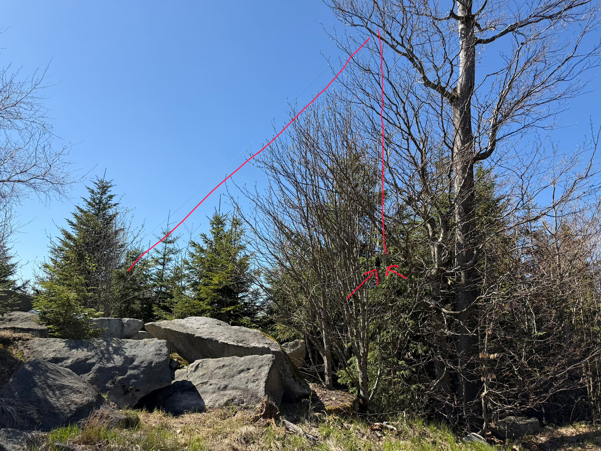

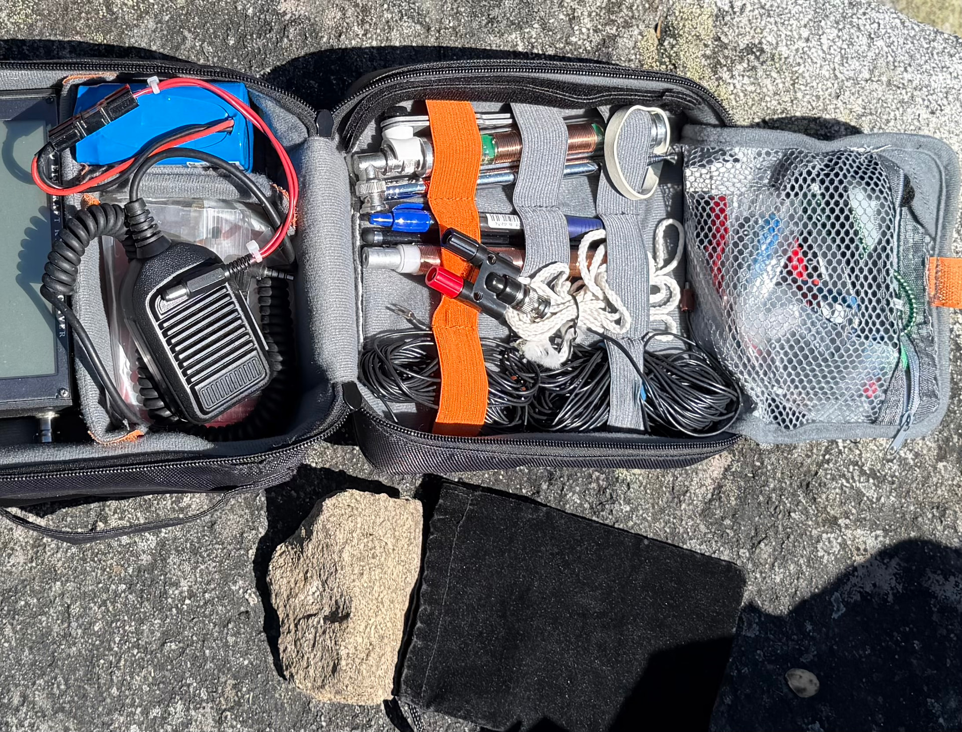

Well, I still had the AX1 with me, but amateur radio is about experimenting. So I used the ascent to brainstorm what I could use instead. I had a binding post adapter with me, I take this extra one with me in case the other one gets wet, esp. in winter times. And I had the counterpoises for 20 and 40 m from the AX1. But how to get the wire up in a tree? I only had a line of 2m. I finally used a small bag (which I use for accessories), put a stone in, knotted it to the line and the wire. This “system “ was rather short, so I ended with a kind of inv. L- sloper, the throwing weight still dangling some meters high in the tree. With the back pack as strain relief I connected to the KX2 via the binding post. The rest was done by the matching unit. 30m with SWR 1:1. 40m was quite unstable but possible. 20m not possible.
In the end I had 18 shortwave QSO‘s in the log, was happy with experimenting a bit and with the certainty that there is always a kind of solution. Below some pictures of the setup.
