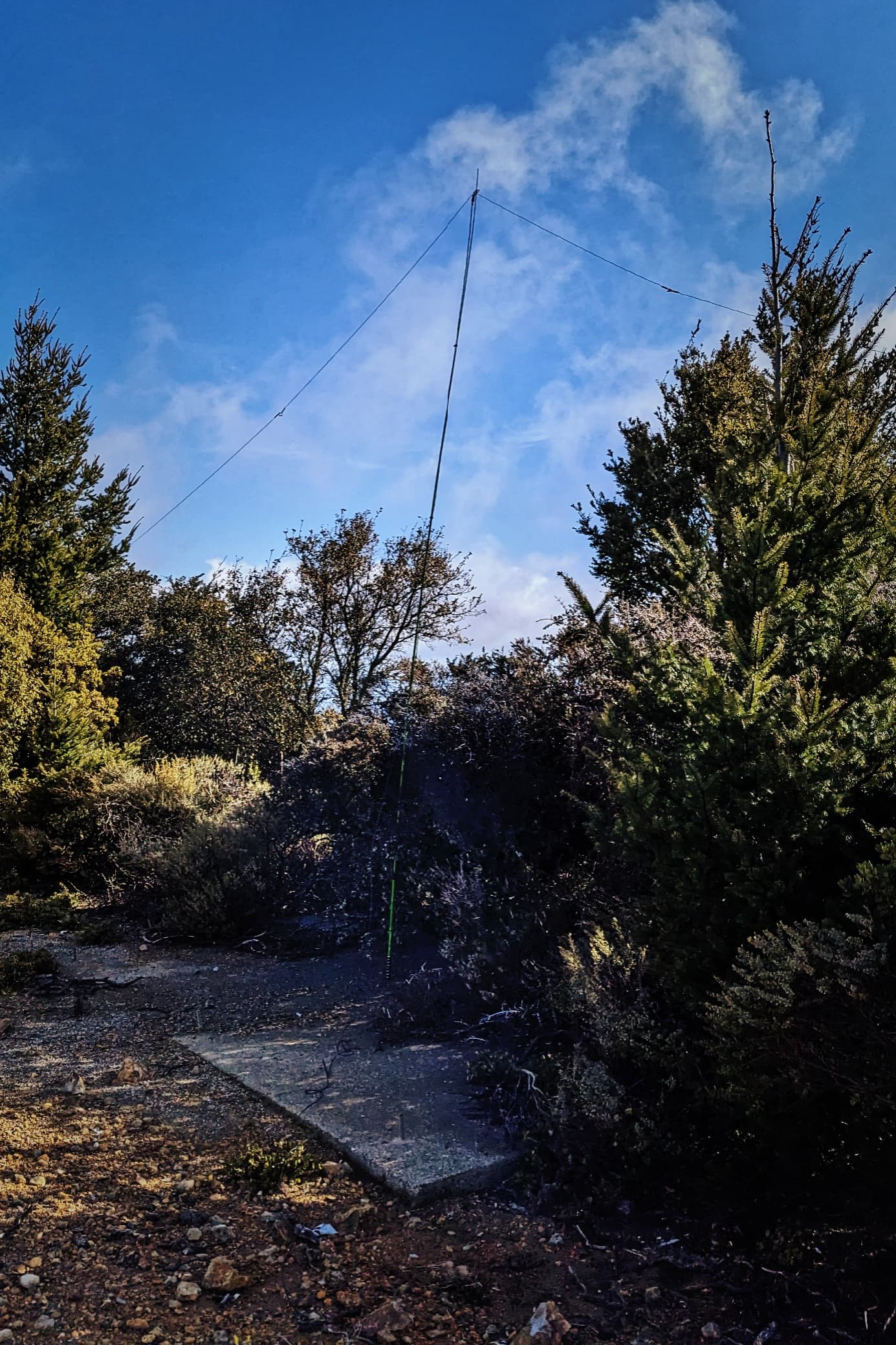

It was pretty cold and windy at the top and after the four contacts on two meters I decided to switch to HF and figure out how I was going to get everything set up in the wind. Luckily it went pretty smoothly and this was my first activation where I just used some scrub to hold my mast vs staking it out.
I didn’t take any pictures of my HF set up but I am using an x6100 and a Micro PA-50 amplifier for 40 watts out to the antenna. For coax I have RG-58 from the amp to my antenna and some RG-174 from the radio to the amp. The antenna is a linked dipole with 40m, 20m, and 10m links made by N9SAB. As you can see in the photo above, I am using a carbon fiber carp rod for a mast. For the software side, I am using the in development FT8CN app and my android phone and I find it to be very intuitive and saves me from bringing my widows tablet into the field. I will try to get a picture in the future.

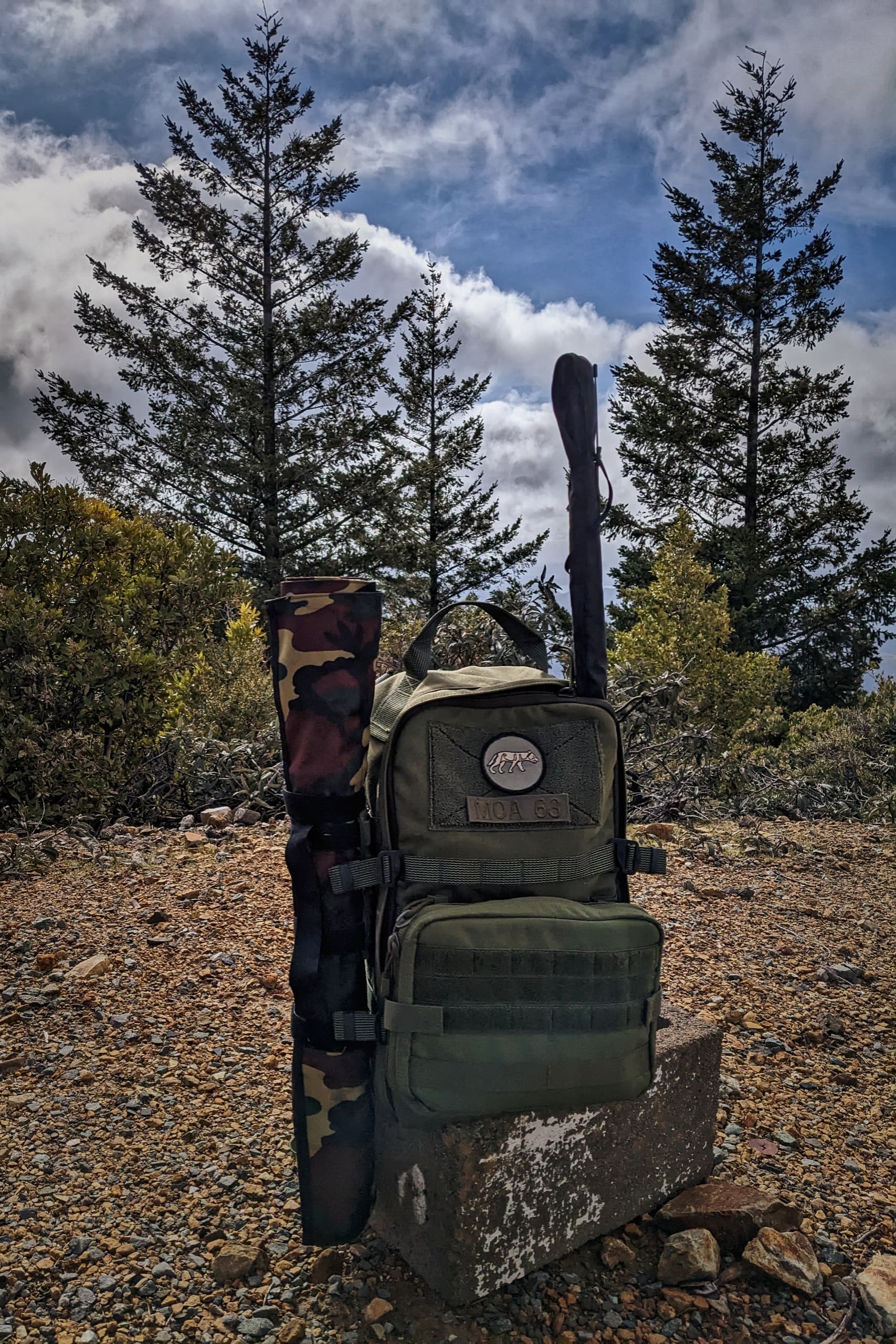

I was going to try 2m again and maybe 10m but after an hour of being wind blown and the heat from my body leaving my rear into the earth I decided it was time to return the the family and pack everything up. Here is my pack with everything loaded, a small PSK, FAK, and some water:
