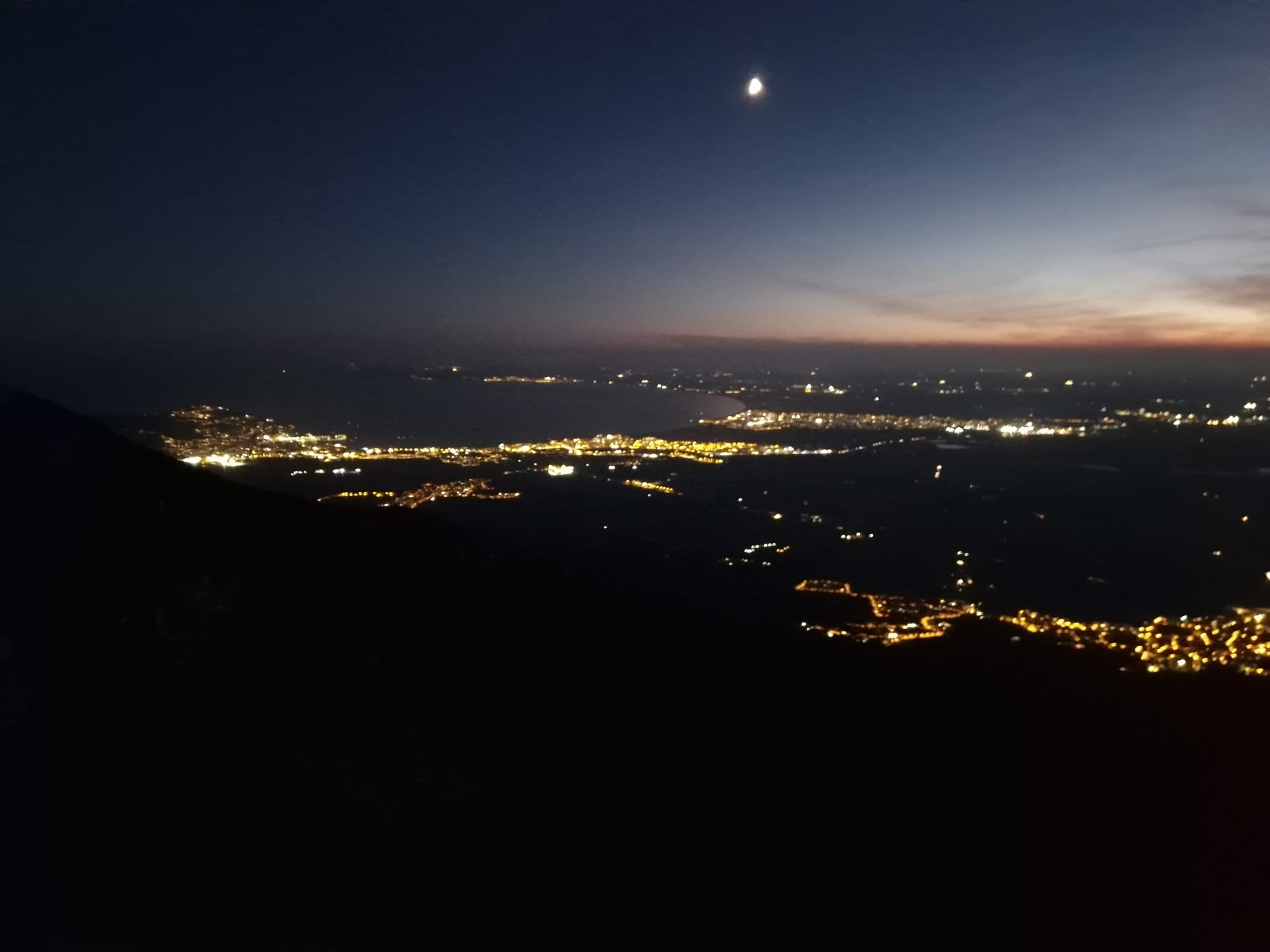

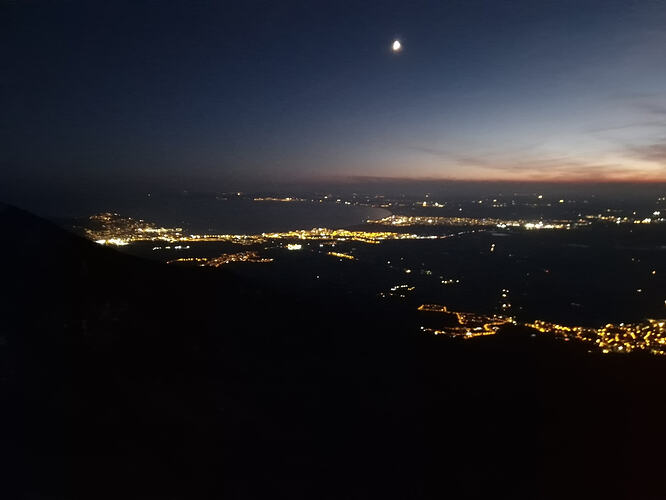

Roses Bay, looking south:

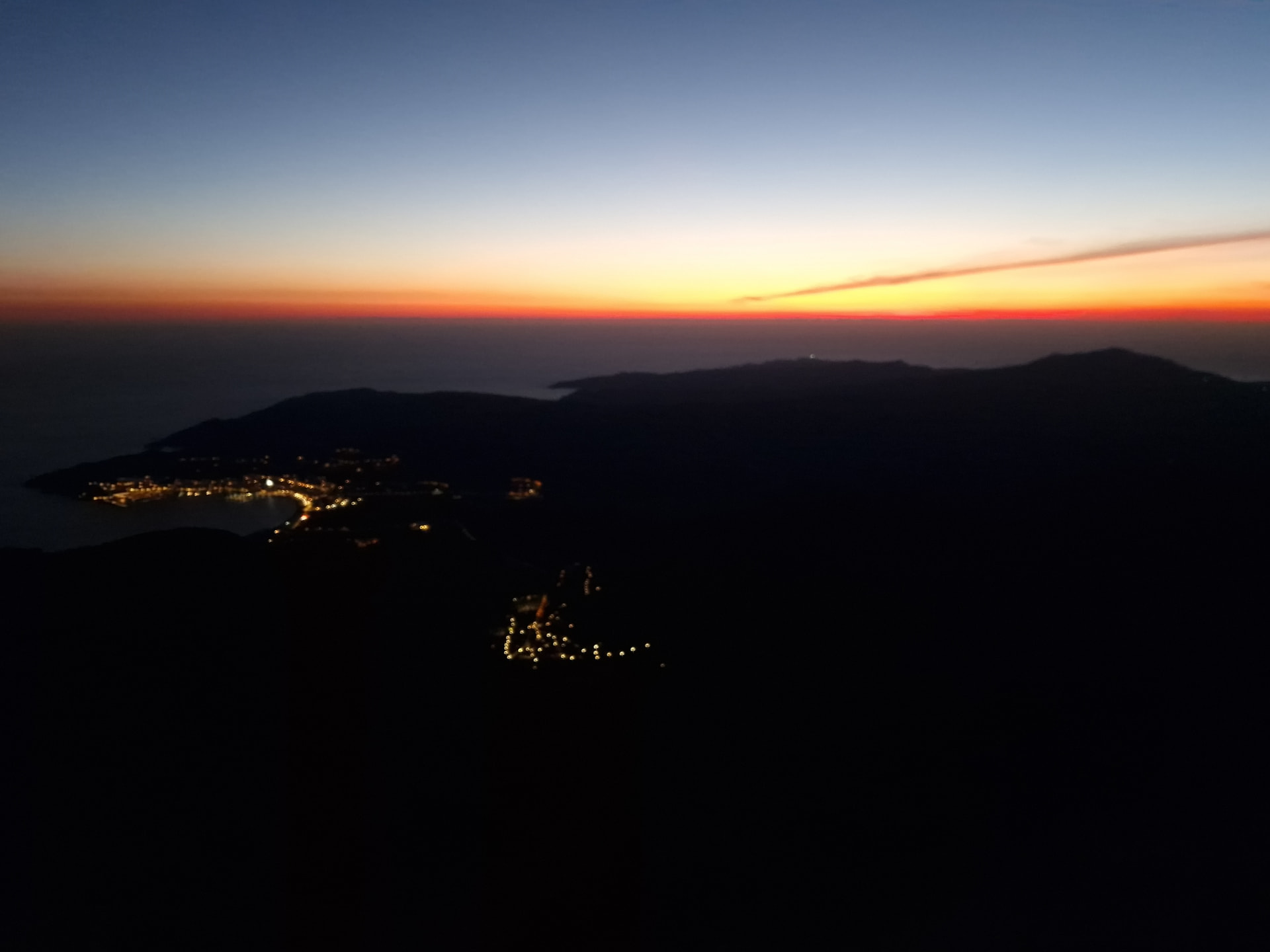

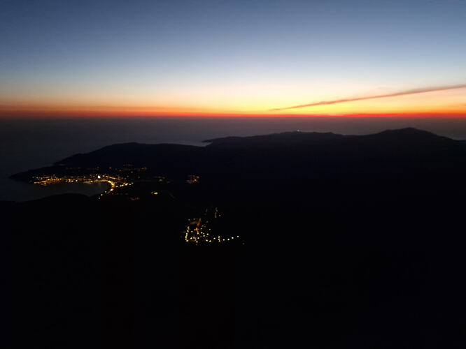

And the village of Port de la Selva, to the north, lay at our feet (Apologies for the quality of the photos – mobile phones do their best in low light).

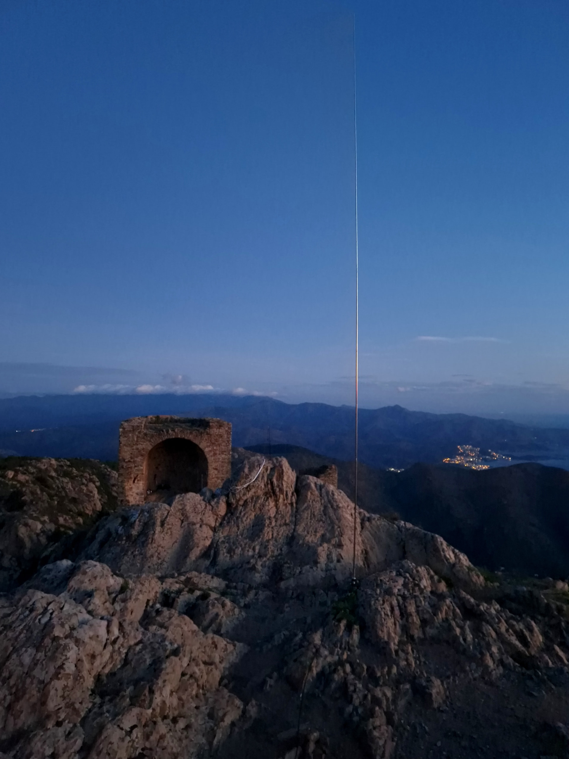

Dawn gradually broke:
We decided to alternate the transmissions, first one and then the other, to give both antennas and both sets of equipment a chance.

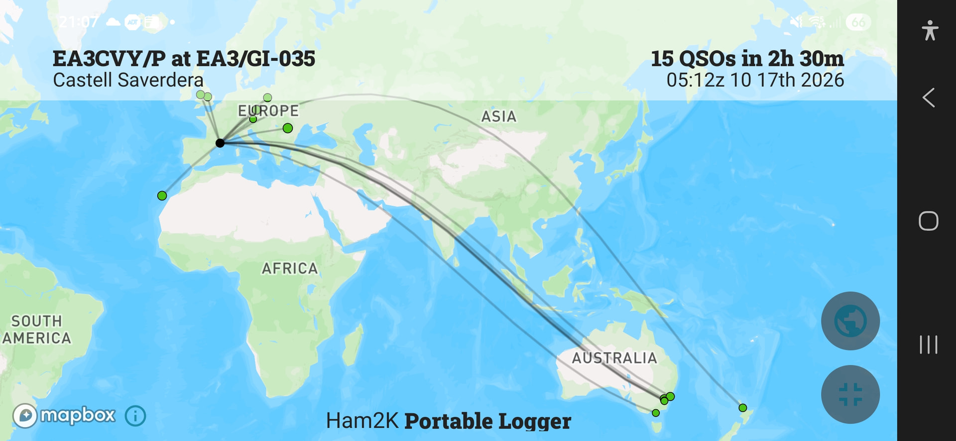

The first surprise was hearing @VK1AD, and even more so that he replied straight away – I couldn’t believe it!
Then more stations from VK and ZL came on the air, and it was a real treat.

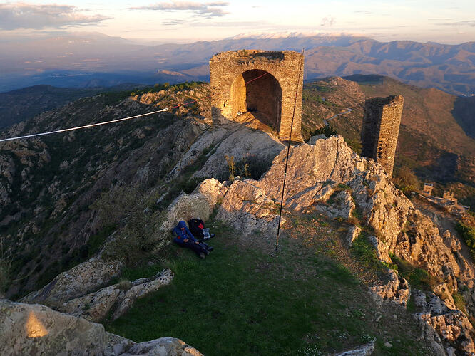

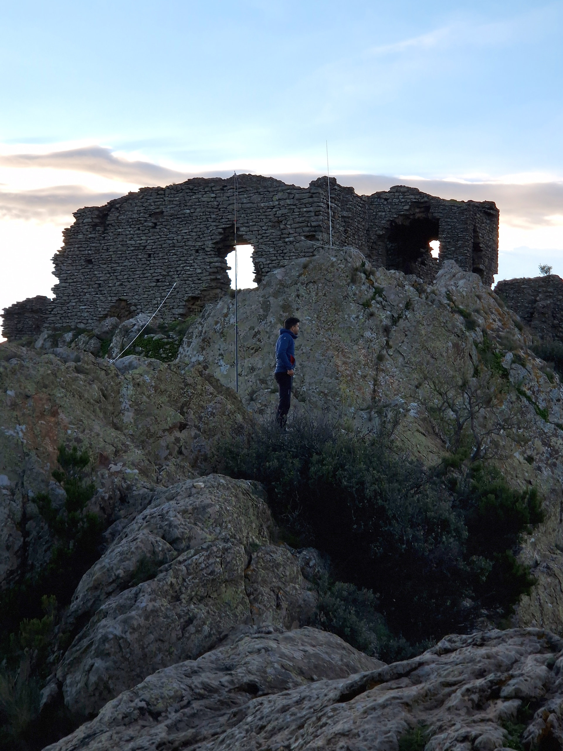

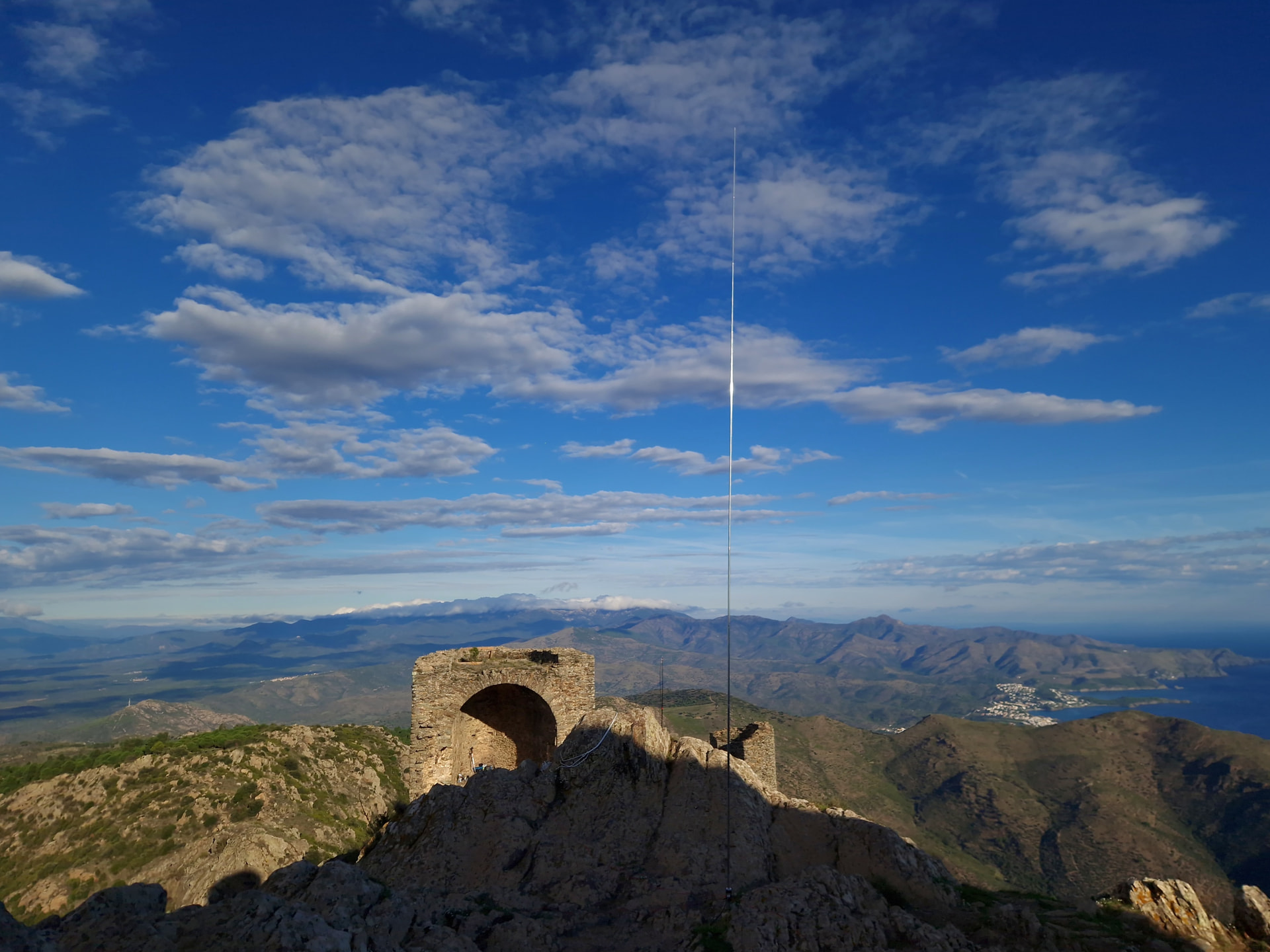

Some photos of the antennas and the site:
At last, the sun came out instead of the rain, and we were able to enjoy the views and the place.

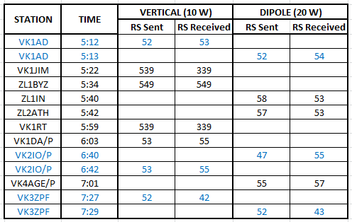

What was your impression on the comparative performance between the two station setups? Next time, would you pick the vertical or the dipole?

Although the vertical antenna was operating at 10 W and the dipole at 20 W, I don’t see any significant difference in the reports received. The dipole does seem to have better reception, though.
I’d go for the vertical again as you don’t need to orientate it, it doesn’t need to be raised off the ground, it’s very quick to set up, and the ground at the summit was completely rocky – yet even so, with the four radials, it did the job well.
In any case, I’m sending you an Excel summary of the stations worked and the reports sent and received (thanks @EA3JHJ). Only the stations we received with both antennas are useful for comparison, but it’s still good enough to draw some conclusions.
Changes in propagation over time also play a part.
Please let me know your conclusions based on the data.
73, Rafa
