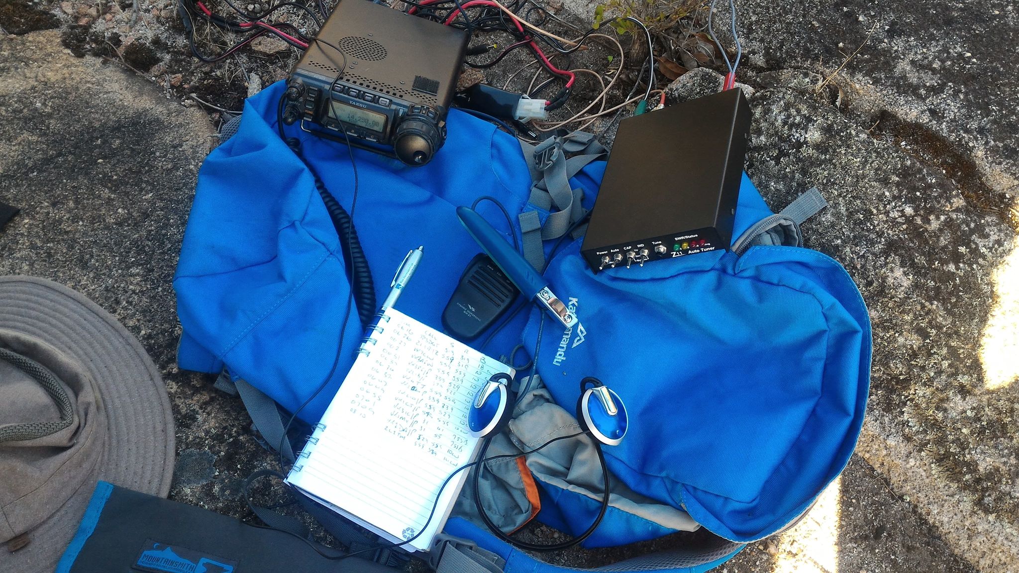

I headed to Mt.Randall VK6/SW-039 and was on the Summit about 05:30 UTC with lots of time to spare.Here is a photo of the late afternoon, was quite cool and windy at this time but temps were about 27C earlier in the day so not a bad day for SOTA. About 60-90 mins before Sunset when photo was taken, just before I packed up.
Living in Western Australia as far as Sota and amateur radio in general is concerned has its own challenges with isolation, time difference, and propagation all making operating portable that little bit more challenging. I have taken part in quite a few of these events and they are always great fun and you get the chance to work other Sota Operators on Summits in VK ZL JA and European Countries.
Today my plan was to run about 40 watts with my FT-857 through a tuner into my L shaped " fishing reel" vertical with radials. I’ve used this antenna before and it worked quite well.
I used my longer pole so I had to change the dimensions to suit, with a longer vertical section about 7 metres. When set up I found it would not tune on 20 metres and some other bands, so I had to quickly come up with an alternative. I unwound the vertical wire from around the pole and as it had a banana plug, I plugged it directly into the tuner SO-239. I grabbed 2 of the radials and joined them together and made a single counterpoise. I just stripped some wire and wound it round the SO-239 to attach it.
Everything tuned up much better so I was on the air at least.
20 meters looked dead so that was not looking good for LP Europe. Having a look around the bands I saw a Spot for JP3DGT/3 on 18 Mhz CW and worked him first call. 10 Mhz seemed to be my best chance of some more contacts, so I spotted myself and quickly worked quite a few VK and ZL Sota Chasers and quite a few Summit to Summit Contacts all on CW.
I could hear Mike 2E0YYY on 40 and 20 SSB but he could not hear me. I did work 2 VK S2S SSB stations on 40 SSB VK3IL and VK1MIC and they were the only SSB stations in the log.
Ended up with 1 JA S2S, and 8 VK S2S Contacts . Only 14 in the log all up 10 on 30 CW, 2 on 40 SSB, 1 on 20 CW and 1 on 18 CW.
3 Countries worked VK,ZL and JA. No Europe today. BUT CW ruled the day, goes to prove what a great mode it is for SOTA.
Thanks to all the Activators and chasers and the guys for Organizing the Event, I ended up with 39 S2S points in the bag, I’ll take that anyday.
73 John VK6NU
