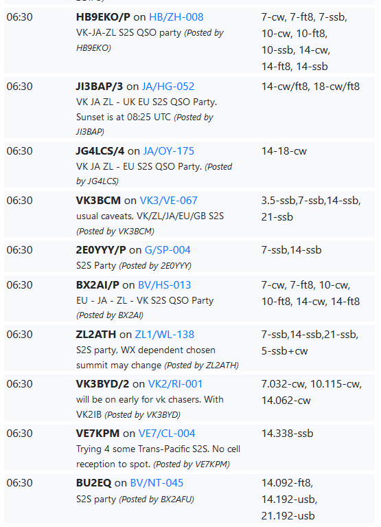

Here’s the current list:

I’m taking the list from SOTAWatch3 - the new one - at https://sotawatch.sota.org.uk/ I wonder if you are using SOTAWatch2 still and for some reason it isn’t getting across to the new system ??
I wonder if there are others that are also not visible in the new system??
YES! There are ones in SW2 that are not in SW3! - here is the SW2 list:
Currently 30 alerts on SW2 - 19 on SW3.

My original and later edit were both on SW3
Are you filtering the displayed Alerts by mode?
Warren.
AARRGH - that could be the problem - I’ve had that issue (unintentionally previously) - let me check…
No it looks OK
All bands all modes, no filter.
I’ve sent Jon a note for him to check, but if you are seeing your alert (and the other 29) OK in SW3, then it has to be a problem at my end.
73 Ed.
UPDATE: I just changed “all modes” to AM (no matches of course) then back to “All modes” and now I can see all of the entries including yours:
I can see Warren in SW3!!
Yes - me too - it was a strange filtering problem in Firefox. I didn’t set any filter for alerts only for spots (Just SSB spots), but I was only seeing Alerts with SSB as one of their modes - Warren is CW and so before I reset all filters, he wasn’t appearing for me.
73 Ed.
