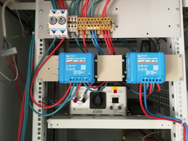

We run a 12 V system with a solar power of 500 Wp overall, 2 x Victron MPPT 100 and ca. 360 Ah SLAB. However, this summer we will replace the SLABs by ~ 300 Ah LiFePo4 batteries.
230 V were provided by an old and noisy inverter. The other day, it died finally, so we can also replace it. :slight_smile:
We run up to 200 W P/out on 12 V. Works fine, but bear in mind that we usually do not operate the station on a daily basis. However I like to setup my mobile office at the club station in summer, which usually works fine for a week with laptops, monitors, chargers and frequent QSOs. But that’s only summer. Two consecutive nights of 160 m CQWW SSB @ 100 W in end-February works also fine. YMMV.

Installing solar power and assembling the freshly-purchased barbecue (2017)
Victron chargers
Rotator maintenance and Whisky tasting :wink:
Right-click on the pictures for full resolution.
Hope this helps.
Ahoi
Pom
