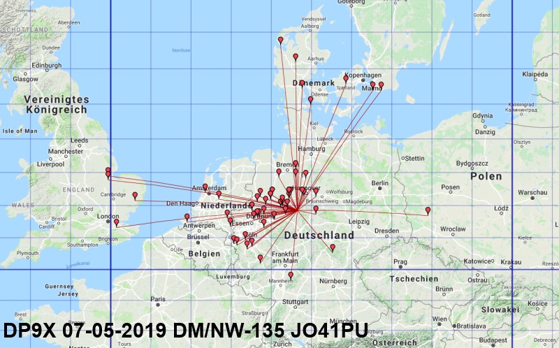

58 SSB QSOs
22 squares
6 DXCCs: DL, G, OZ, PA, SM, SP
2 s2s: DB7MM/P DM/TH-012, DD3WY/P DA/NW-343
Ahoi
