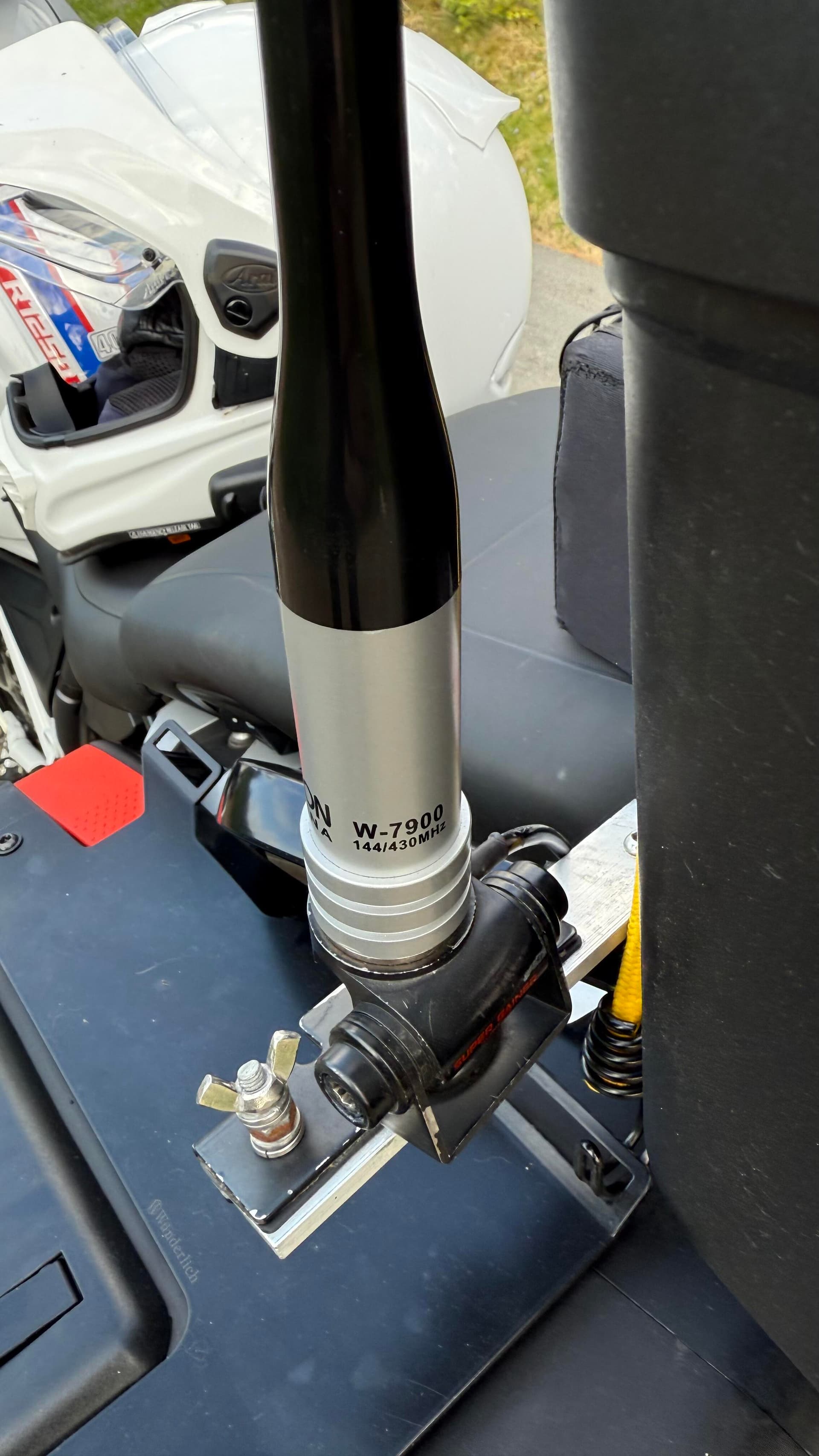

Thanks for all the recommendations. Just to close this conversation out I ended up buying a Watson W-7900 which is a copy of the similarly numbered Diamond antenna. It has impressive paper stats:
  • Gain: 5.0dB (2 metres), 7.6dB (70cms)
  • Operation: 7/8 wave double loaded on 144MHz by 5/8 wave on 430MHz
I decided that maybe if the ATAS-120A was happy with the grounding that the motorbike provided maybe I shouldn’t be overly concerned with an antenna that doesn’t need one.

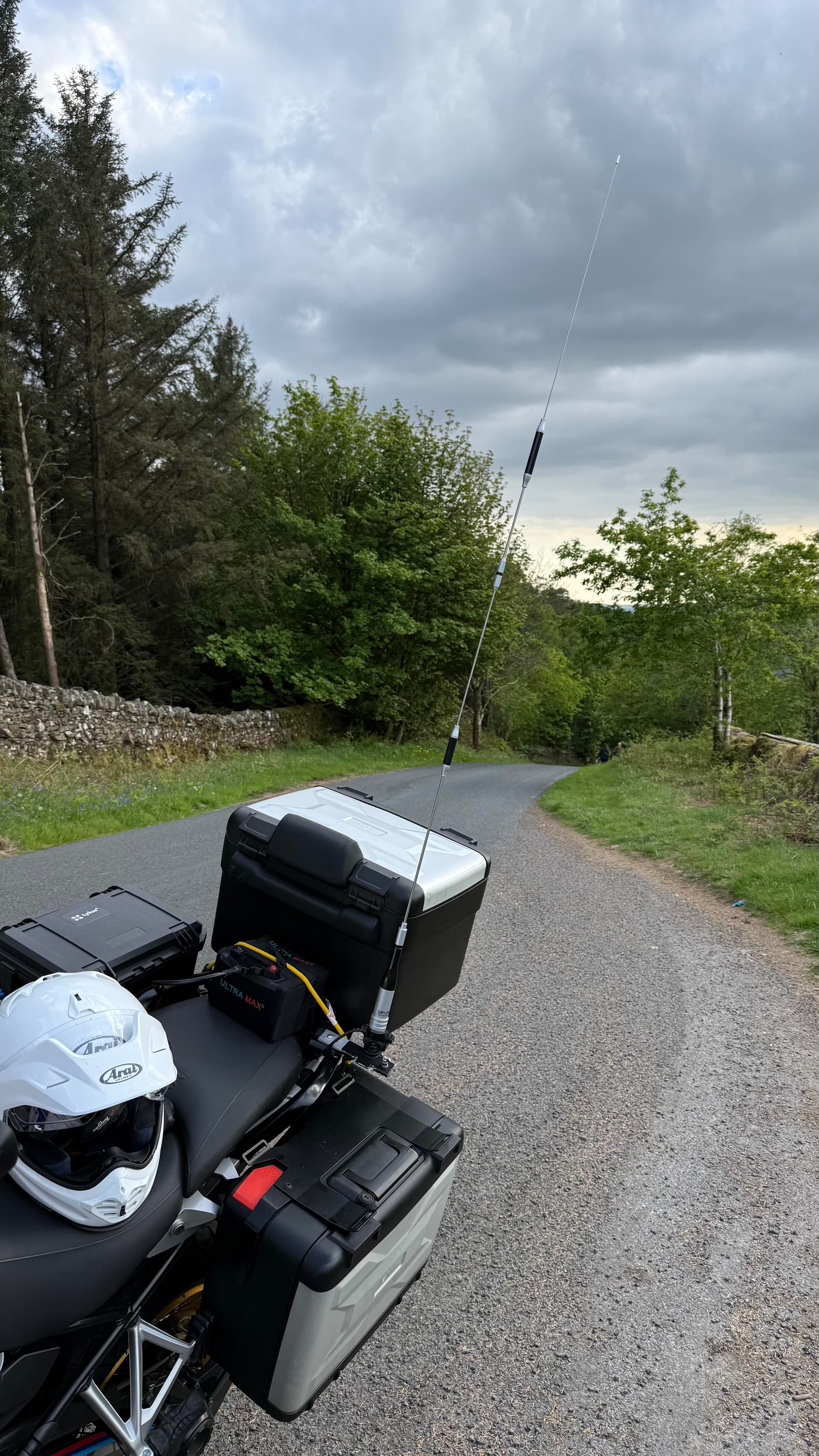

On a trial last week I parked up on the road near the main path to Gummer’s How G/LD-050 and was talking to a station in Millom before I had a break station from Colwyn Bay, so it is clearly working just fine on the motorbike.
It’s quite a tall antenna but with the lower mounting height on the motorbike is not unwieldy.
