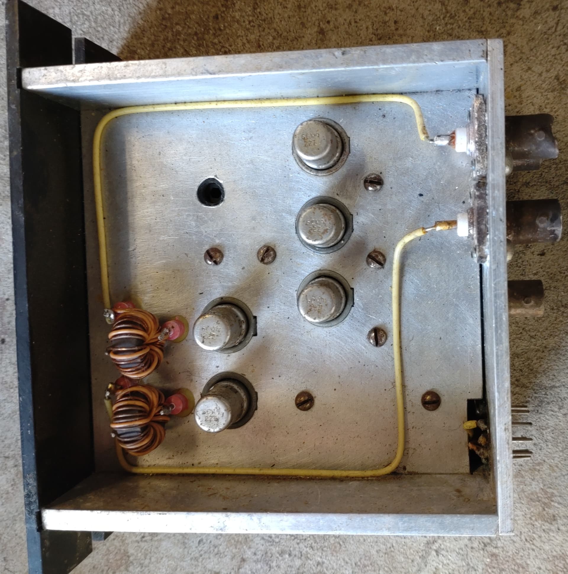

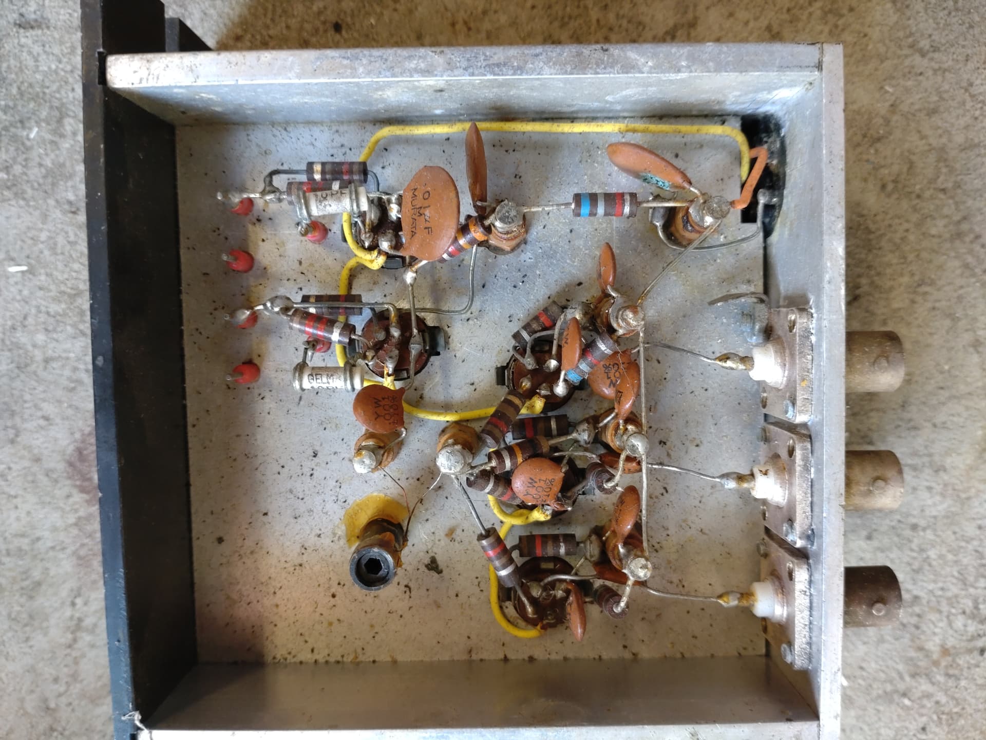

For someone wanting to build a small, rugged radio, I have some Nuvistors 6CW4 available. Nuvistors are 10x20mm.
I was in the attic of the old building of the former Radio Research Centre that studied propagation, and found a box of modules using Nuvistors. This one uses 6CW4 triodes.
The building is being demolished, and these will be dumped.
If anyone wants to use these, contact me.
This module is an adder, from the “Large Interferometer”, which recorded the azimuth and elevation of incoming HF signals. It had two vertical dipoles on an ~10m horizontal arm that rotated continuously - for many years.

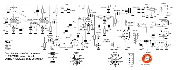

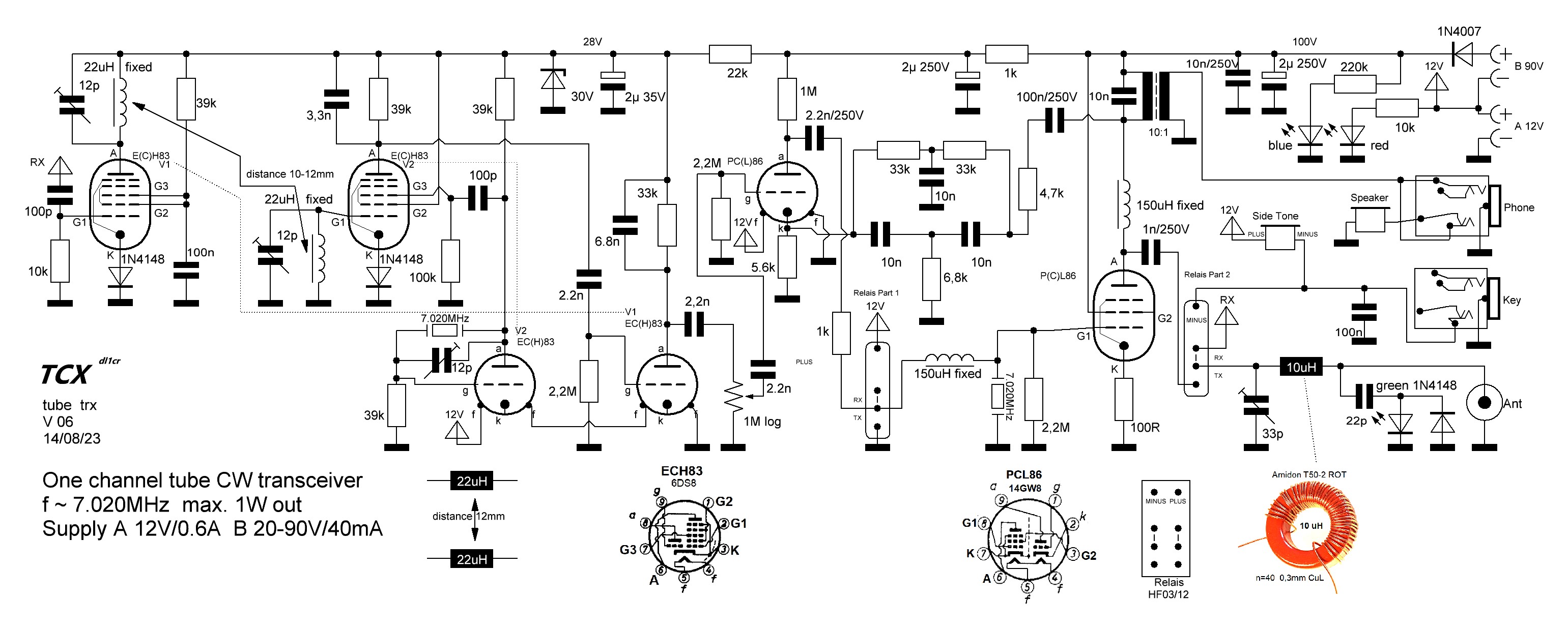

This reminds me of my first and so far last use of a homebrew 3-tube TRX on a Summit.
