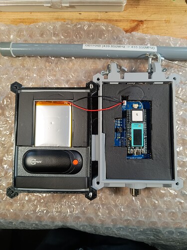

You can use the SOTA tracker as a tracker, iGate, or Digipeater. It contains a Heltec Wireless Tracker board which can be flashed with Richardo’s iGate firmware by selecting the “Heltec Wireless Tracker” board.
In fact it’s what was in the payload of the RSGB high-altitude balloon (GB1HAB)- configured as a Digipeater with a tweaked version of Richardo’s iGate software:
