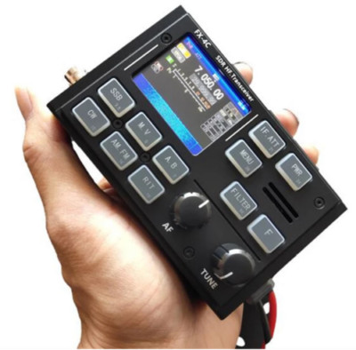

Strange, when you google the “PFR-3 auction” on UK ebay, you will find also this QRP SDR transceiver among other things …
Is someone already using this transceiver?

Yes. I have a uSDR Transceiver. As we are in lockdown I can’t use it on a summit. Given that it cost me $200 AU it’s not bad. Not bad at all.
I was intrigued by the method of generating SSB. It’s not perfect and very low level audio is squelched but for SOTA use its OK, based on a local QSO.
Sensitivity is down a bit but as it’s a 3/5 W rig and most people on the other end will be in the 100 W category it should be adequate.
CW sounds fine but until it’s been out amongst the mosquitoes and blazing Sun I can’t say much more.
Compare it to it to say an MTR but with SSB and all HF Bands. 80, 60, 40, 30, 29, 17, 15, 10 m. Mine also seems to work on 12 m.
Plenty of filter bandwidths to choose from.
You also get AM and FM. It’s a little heavier than an MTR3 but provides much more in a package of about the same size
You won’t get a smaller multimode multiband HF transceiver this decade IMO.
For lightweight operation it’s amazing. Pop it in one pocket with a battery and put the antenna and a log book in another pocket.
Sure the KX2 is a better big pocket transceiver and needs less skill to operate. But look at the price differential.
There is now an on line manual.
I can’t wait to get out in the field for a day with this really tiny rig .

Very promising radio for this money.
Also there is chipper version without a battery an smaller size
https://a.aliexpress.com/_9GotaC
It seems for me that it is cheapest cw HF rig with SSB bonus.
Hard to stop thinking about purchasing it as upcoming Christmas
gift.
There is also this one bit more funds needed to purchase but still works out cheaper than the kx2
A bit expensive noname rig. I have to say that I am little bit disappointed by Xiegu SDR rigs
It would be nice if the people designing the clones would give credit to the original circuit designer. It would also be helpful for those who’ve bought one (like me) who have no operating guide. Mine came with the radio packaged with the wrong microphone and no power supply. The only thing I’ve found wrong with it so far is the selector is a bit flakey on the band change position. I would love to get my hands on an operating manual for the thing.
I have an FX-4C. Not a bad little radio. Built in sound card as well, so easy to do digital modes out of the box. No CAT control yet though. I believe this radio is from the same developer of the FX-9, as well as the FX-4A that LNR was selling a few years back. There’s a farcebook page too, and the developer is quite active on the group. Heavier than I would have thought - but not too bad and I wouldn’t hesitate to throw it in the backpack for a days SOTA adventures…
