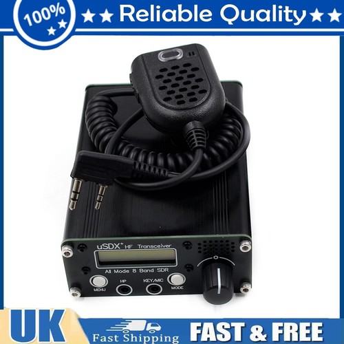

USDX+ on ebay? anyone used one?
I havent got a fantastic radio budget, but would love something compact and portable for “hill top” use, been looking at one of these for ages, but not sure weather or not to take the plunge!
Just wondering what other peoples thoughts are, and what accessories would be useful to get the best out of them? obviously a tuner/suitable antenna (im thinking of cutting several EFHWs, so tuner not needed) any ideas??

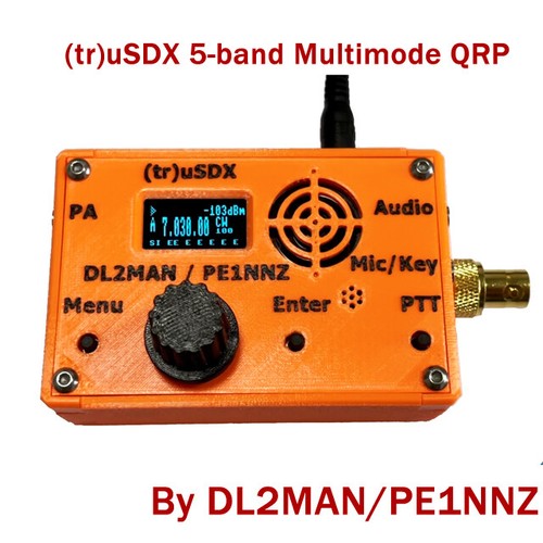

Interesting responses. I’ve used both the (tr)uSDX and the uSDX+. Although it’s a bit of a spoiler, I’ll take my uSDX+ over a (tr)uSDX. It’s not perfect by any means, but here are my thoughts based on my experiences of using them for SOTA and general portable usage.
(tr)uSDX:
  • Poor form factor and weak SMA connection.
  • Required power connector that appeared to be a weak point as far as strength of connection goes.
  • Poor CW filtering.
  • No internal battery.
  • Enclosure did not feel as robust as uSDX+.
  • And #1 pet hate… the screen is truly appalling. You cannot see a thing in outside light and for this alone, I would not buy one. It was a very frustrating being stuck at the top of an Alpine mountain on a recent SOTA activation, and not knowing what frequency I was on. Truly awful screen,
  • Plus point… internal microphone did a great job.
uSDX+
  • CW filtering is pretty good, certainly a lot better than the (tr)uSDX.
  • Internal battery lasts for hours.
  • Rugged case (I’ve dropped mine on the floor, it’s been drenched with sea water ona recent /P expedition) - works just fine.
  • Excellent screen, easy to see.
  • Covers all HF bands.
  • To be fair, my unit hasn’t been without problems… the rear microphone connector was poorly soldered and the mic stopped working. I reflowed the solder joints and it’s been fine. The internal speaker has stopped working but that’s not an issue (for me) as I always use headphones (although the speaker/mic works as it should when h/phones are not attached).
Overall, for me, the uSDX+ wins easily. I’ve had a 10m SSB contact to Brazil using it, plus contacts to the US, Asiatic Russia, etc. It performs well and has never let me down out in the field. It’s not perfect, but for what it is, I am a very happy customer. I couldn’t say the same with the (tr)uSDX and I was glad to hand it back to its owner!

I use the uSDX “red corners” on CW. It has some quirks but the full hf band coverage, good power output, strong battery, swr/pwr meter and virtual indestructibility of the IRF510 PA are very favorable. Yes the rx front end is wide but attenuators can help, and in my case a magloop antenna is a high-Q bandpass filter that has let me operate under field Day conditions.
@G7BEH About year and half ago, I tested one of the models od uSDX and found that it doesn’t meet criteria for suppression of harmonics. I looked inside to see if I can remedy the problem and if was all covered in white stuff. I gave up and sold the unit.
(tr)uSDX meets harmonics suppression criteria.
I might be unlucky, but I read number of posts of people who had harmonics issue with uSDX.
73 Marek
@SP9TKW Just to be clear, I have the uSDX+. One of these…
…and it’s definitely not covered in white stuff inside!
The (tr)uSDX may meet harmonics suppression criteria, but for me, I found it unusable for all the reasons I listed previously. The uSDX+ is in no way perfect and has some annoying traits, but for portable operation, I’ve found it reliable, usable, lightweight and small.
