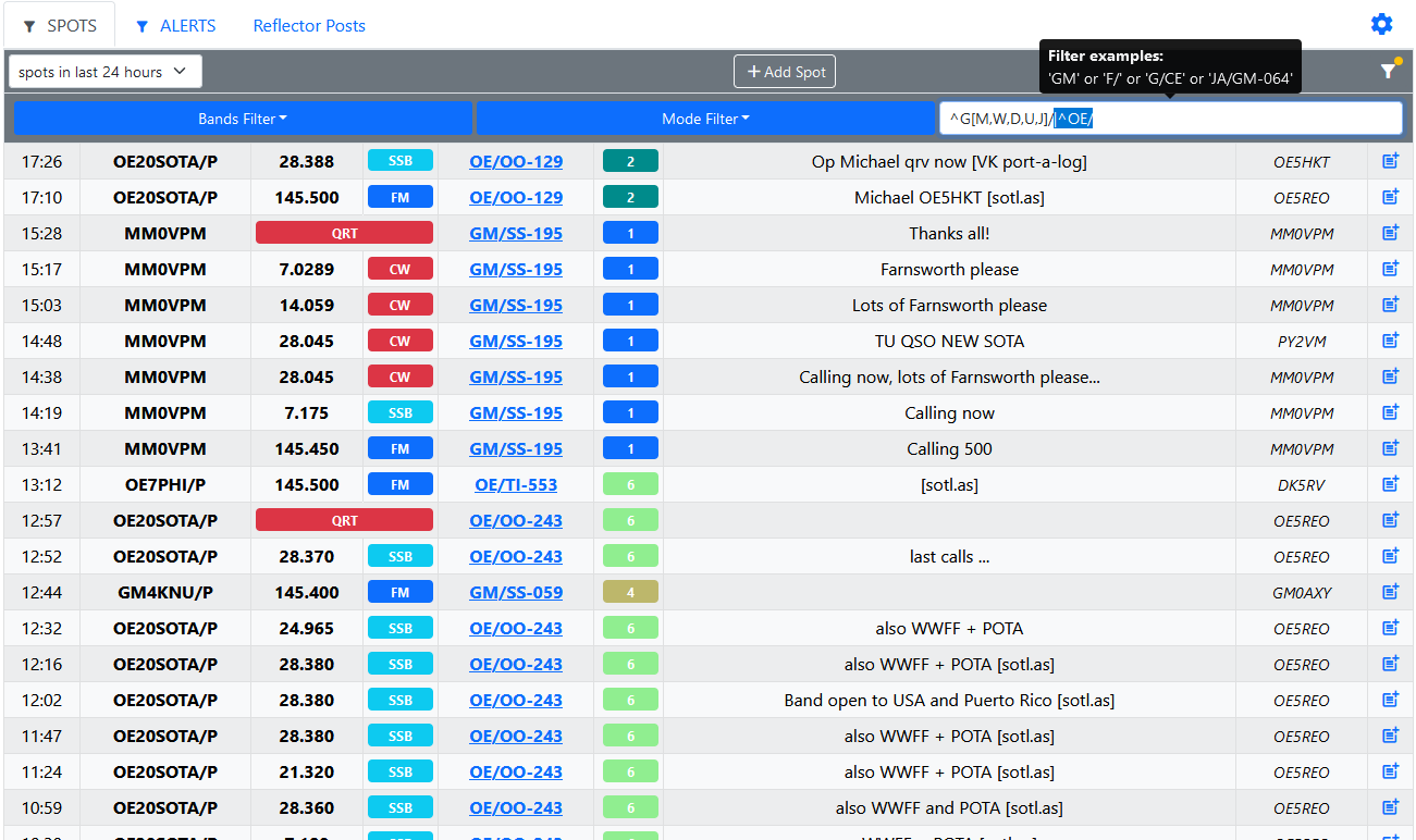

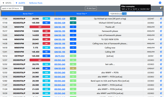

That works. But the regex style filters are not working as one would expect.
For example
^G[M,W,D,U,J]/|^OE/
would retour all spots for summits in GM, GW, GD, GU, GJ and OE.
But it does not :upside_down_face:

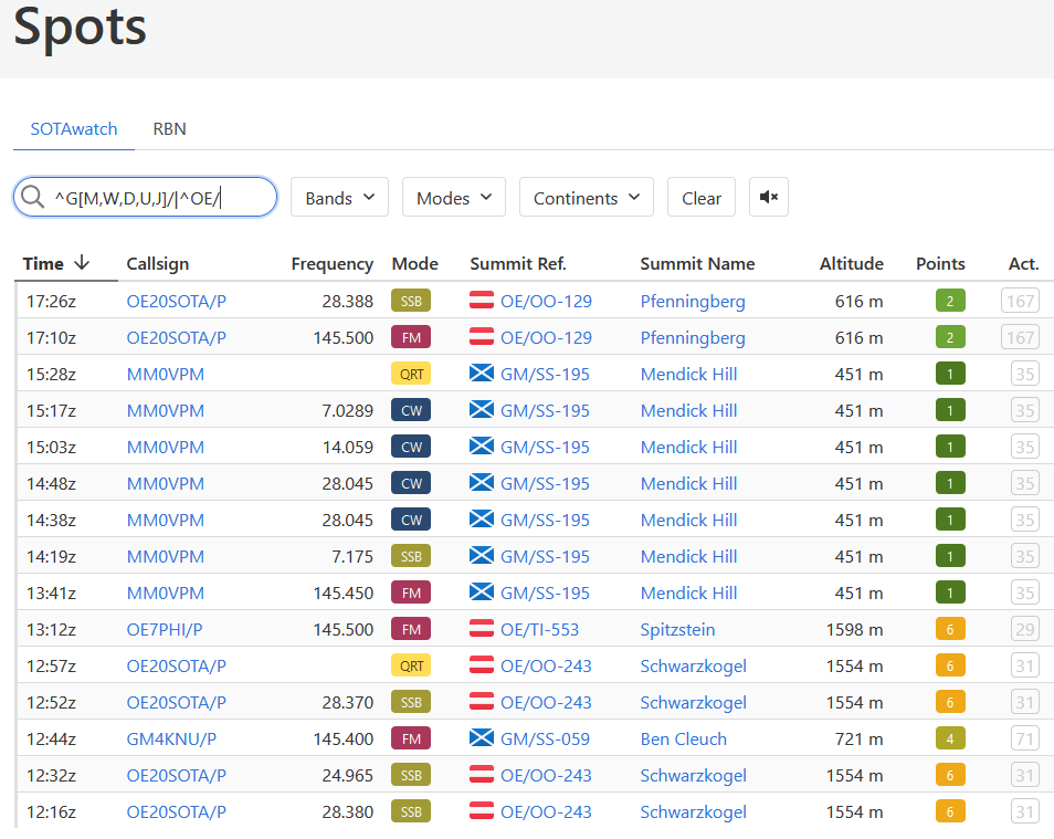

In sotl.as it works as expected:
The way it works:
^ = starts with
[A,B,C] any in the list matching
| is the logic OR
A fix for this is building now.
Impressive reaction time :muscle:
Now working :+1:

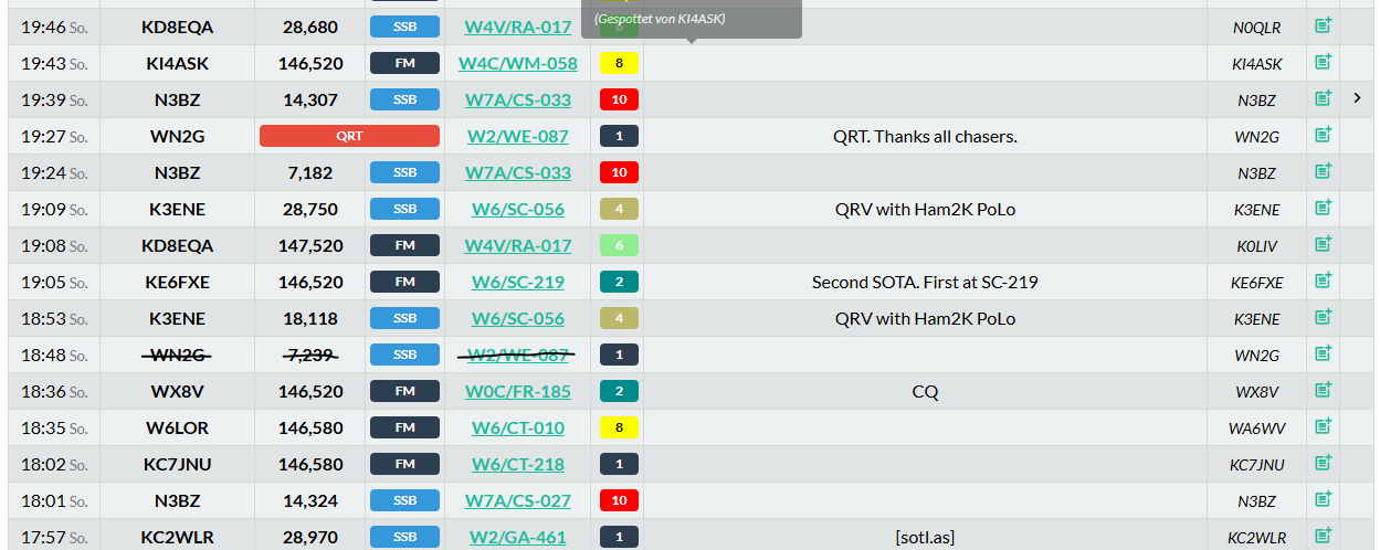

Btw Andrew is there a plan to utilize the QRT spot in a more useful way?
I would like to see a (default) option that previous spots (of the same callsign and summit) are hidden (or striked thru) when a QRT spot was placed.
Or even more general to show only the latest spot for the callsign + summit combo?
Because that is reflecting the actual state.

Am I blind ? I donā€˜t see that option :grimacing:
Show Expanded Spots is the option
Expanded acticated = Show all?
But then it does not collate in a meaningfull way as seen in my screenshot example.
The spot before the QRT should not be in the list I guess as it got superseeded by the QRT spot.
I’ll have to look at the logic. i think it collapses any spots that are the same summit and callsign in order. I don’t think it goes all the way down the list and collapses everything, like a threaded view
