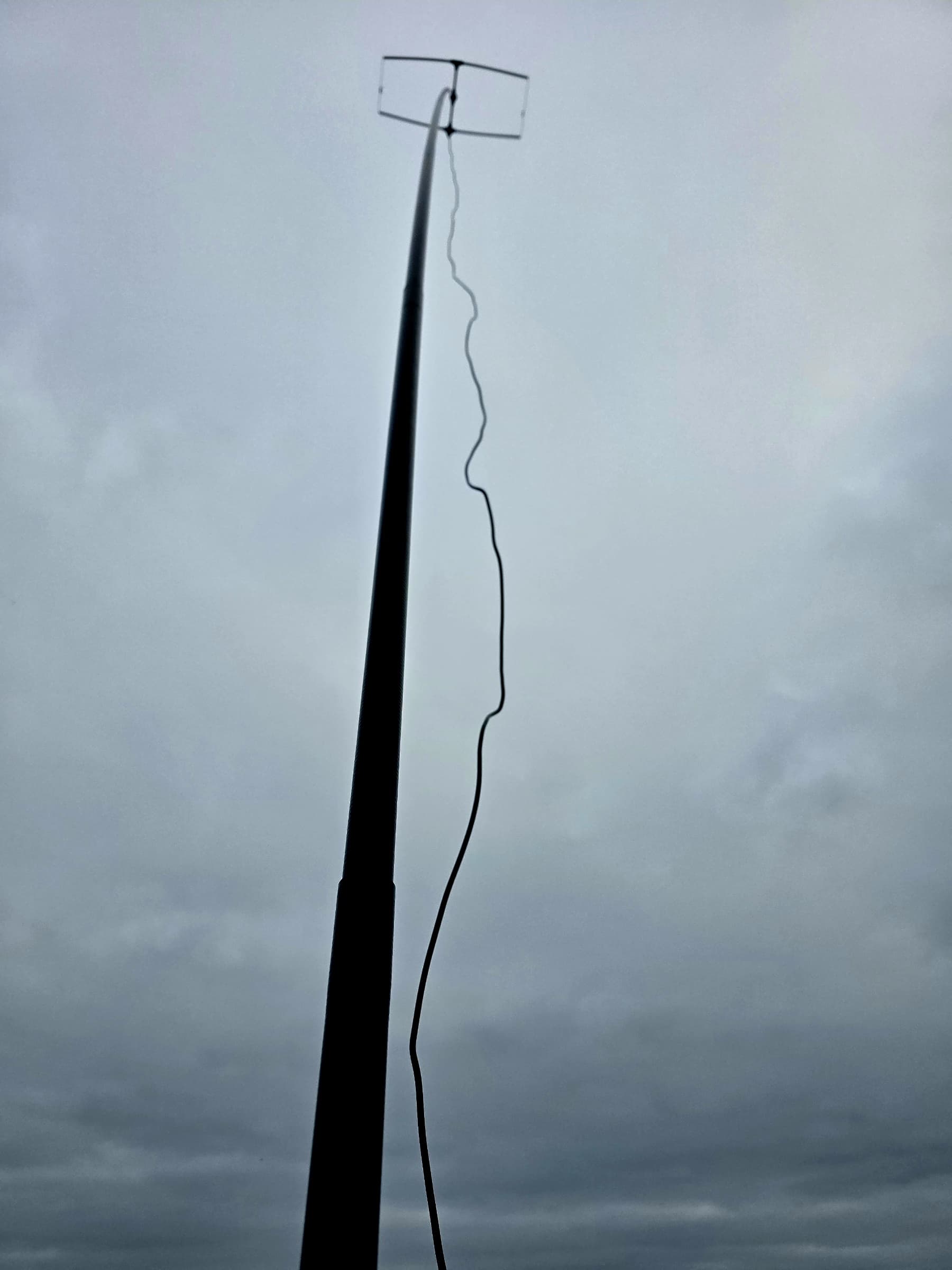

No SOTA for me but i might get out tomorrow or Sunday and try my DL2MAN Moxon on 2 and 70 for CW using my Quansheng.

Going to run a Quansheng on CW 2 and 70. Using my RH770 for 70cm and alternate between the DL2MAN Moxon and the Slim G, both on a 7m mast for 2m.

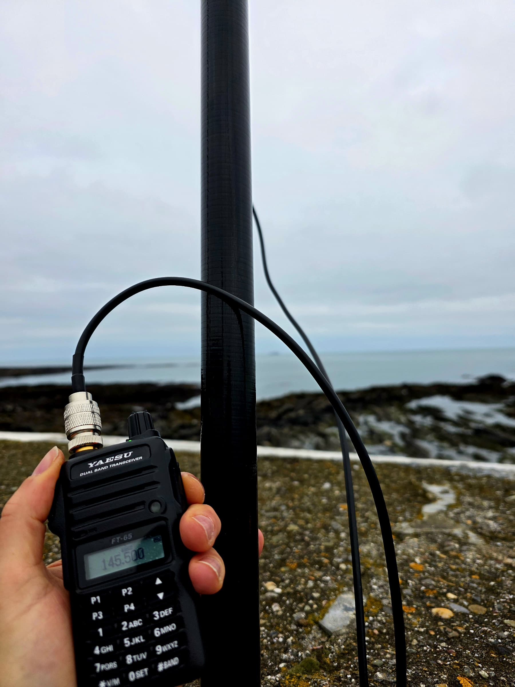

I will also try FM on 2 and 70 with an FT65 as well, see if I can get across to the UK. If anyone is on a summit I will try and chase, see if the Thira Hird (lift) is on!

Couple of snaps below. I also went for a run earlier. Tripped on a root and split both knees. I’ll spare ye the gory snaps! First time I’ve called CQ on CW or FM with two bleeding legs though! :sweat_smile:

  1. PL259 + an adapter = fail. Fit the correct connector to the cable and ditch the adapters when operating above 30MHz. (*)
  2. Unsupported weight of coax hanging down will result in premature failing of the coax. Attach to pole to support weight and stop it flapping about in the wind.
  3. Horizontal polarisation is no good for FM as it places you at up to 30dB down relative to other FM stations using vertical polarisation.
  4. Be aware of the plateau effect and operate nearer the edge / slope to benefit from reduced destructive reflections. You may only need the antenna 2m AGL not 5m and save on coax loss.
All the effects can be marginal to severe but they all add up so take steps to minimise them when you can.
(*) you can make a 10-15cm cable with an SMA and BNC female for example. That allows attaching other cables to handies etc.
Cheers for the pointers. I didn’t know about the adapter issue. I do have a BNC to SMA cable but it isn’t long enough for the mast. I’ll look in to making a custom one.
The horizontal I get, I thought it would be alright for CW and a quick check on FM. Next task is to adapt a mast mount for the Moxon to seat it vertically. Added to the to-do list.
I did switch between the Moxon and RH770 but still no joy. I had the Slim G as well but couldn’t use it as I left a carabiner in another bag. Tried to tie it on but no joy.
Very good point about the coaxial strain. It did drop off at one point! Duly noted for the future. There was near zero wind this morning, not even a puff of air and the sea was like glass. Unusual as Loughshinny harbour is usually pretty exposed and can howl in the Winter months.

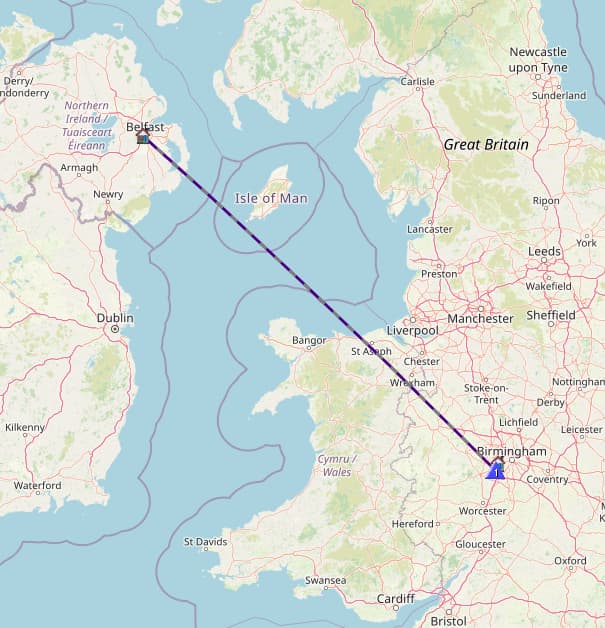

118 miles on 1 watt with my new home brew antenna , whist walking my dogs in the Wyre Forest Worcestershire I was hearing GM stations but my 500mw would not cut it !
118 miles on 1 watt with my new home brew 2/70cm attic antenna . Whilst walking my dogs in the Wyre Forest Worcestershire I was hearing GM stations on 70cms but my 500mw would not cut it !

On Sunday, a personal best for me (I think). 336km / 227mi from G/CE-002 to somewhere near Larne using 5W from an Alinco DJ-G7 handhand on 2m. Peaking at 59 both ways :grin:
Looks a good 30 miles from Larne that does. Nice QSO nonetheless.
