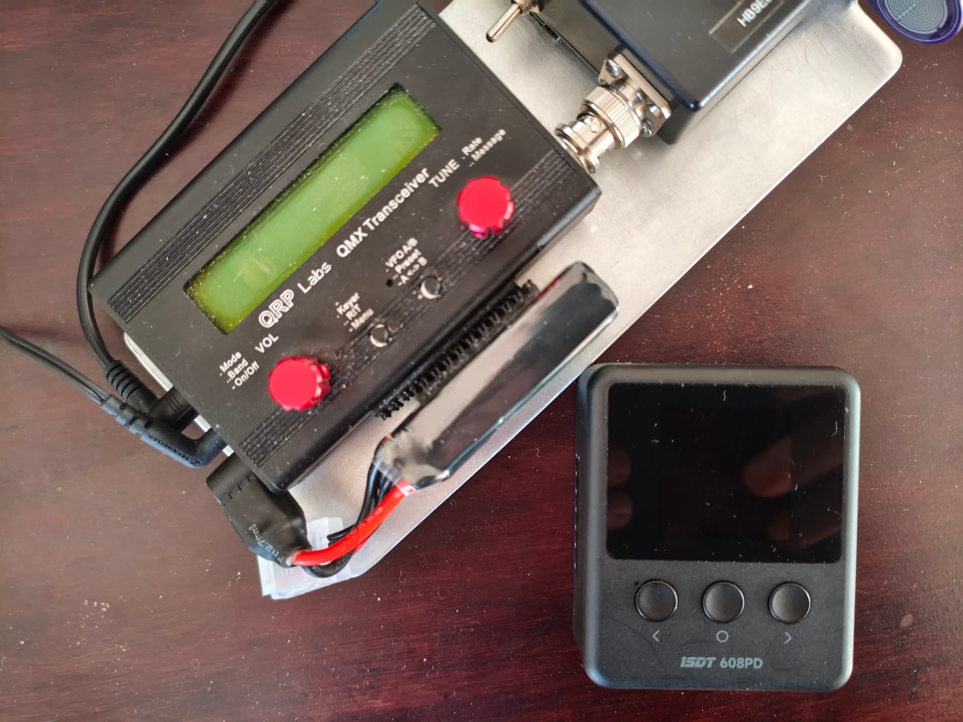

I like to travel and hike very light. I am using a QMX with a 650mAh LiPo battery, 50g. Recently I came across a charger that may be of interest to others. It’s small, 80g, and takes PD input - so if you’re traveling with a phone charger, you’re all set. The charge voltage can be set so the QMX gets its preferred 12V max. ISDT 608PD on Ali for 25 Euros.

So how does this work (I’m sorry if this is obvious) – the ISDT 608PD charges the LiPo battery at home, then on the summit the battery charges the QMX? And then during the hike if you want to charge the LiPo battery, you charge from your existing power bank → into the ISDT charger → into the LiPo battery?

Adam, the unit is a multi-function battery charger and it’s a lot smaller than many being used by SOTA people. Mine is 14x14x5cm requires either mains or 10-15V DC. This unit has a DC input or a USB PD input. PD is the magic expression, it means Power Delivery.
Originally USB sockets could provide 5v @500mA. Later an update to USB defined a number of extra power and battery modes and some USB sockets could provide 5V @2A . PD is a spec that lets the USB device tell the USB host what voltage and current it can use. So instead of just 5V there are high voltages such as 9, 20, 28V etc. My work laptop uses the USB C connector for charging and it tells the PSU it wants 20V at 3.3A. If you use this new battery charger with a PD capable PSU it will tell the PSU to set the right voltage. The benefit is one charger can charge your laptop / phone / electro-gizmo / battery charger. In addition, the options for LiPo etc. charging re much greater with this charger than old chargers.
At the summit, the battery (it’s Velcro’d to the radio in the picture) powers the QMX.
The advantage of this charger is its tiny so can be included in a QMX travel arrangement for not much space/weight increase. And if you already have a PD charger you’re laughing.

It’s as Andy says, Adam. Works well a wall phone charger or a powerbank on the go. I just find it brilliant, therefore posted it here.

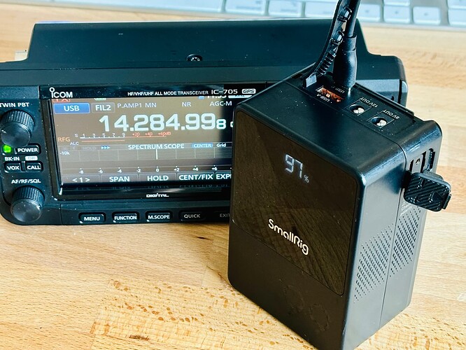

Thank you @MM0FMF and @EI3LH , I’ll study your responses carefully later today and surely ask more questions, but for now just curious if, after buying QMX, the above charger gives me any benefit above the SmallRig 99 which I already have (for photography purposes). That SmallRig gives 3A to 12V and 3A to 8V (barrel-type sockets), has USB-C up to 20V (3A) and D-Tap (up to 15V at 14A). It has 6.7Ah nominal capacity.
It is quite bulky (see image compared to ICOM-705) but since that combines charger + battery, I wonder if that could be my only power source for my hikes – for QMX, phone, camera, etc.

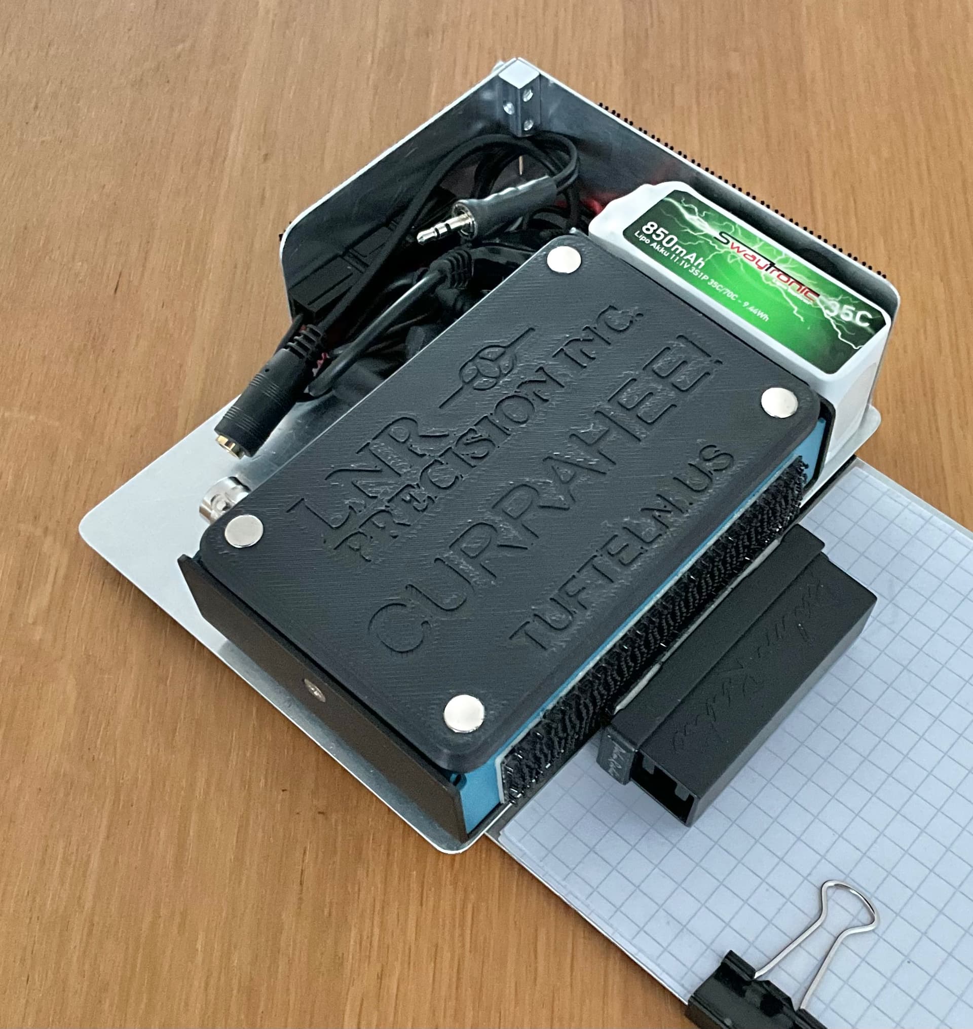

I also have these Digicam batteries that Zi have been looking to as kfo use for my QRP radios
Initial testing has been positive and I can attach it to the Peovi cage very easily

That appears to weigh 580g compared to 50g for the 650mAh LiPo battery. If you are carrying it anyway for your photography then it might be reasonable (except for eggs in one basket) but otherwise it’s a bit heavy.
My understanding is @HB9EBE has 50g of the LiPo battery + 80g of charger + xxx grams of a powerbank, which brings the weight closer to SmallRig if it was to be the only thing I take. But I agree, it is quite heavy, I’m just reviewing the options here…
You only need to take the 50g battery to the SOTA summit. You have the 80g charger plus USB PD power supply back in your hotel room.
