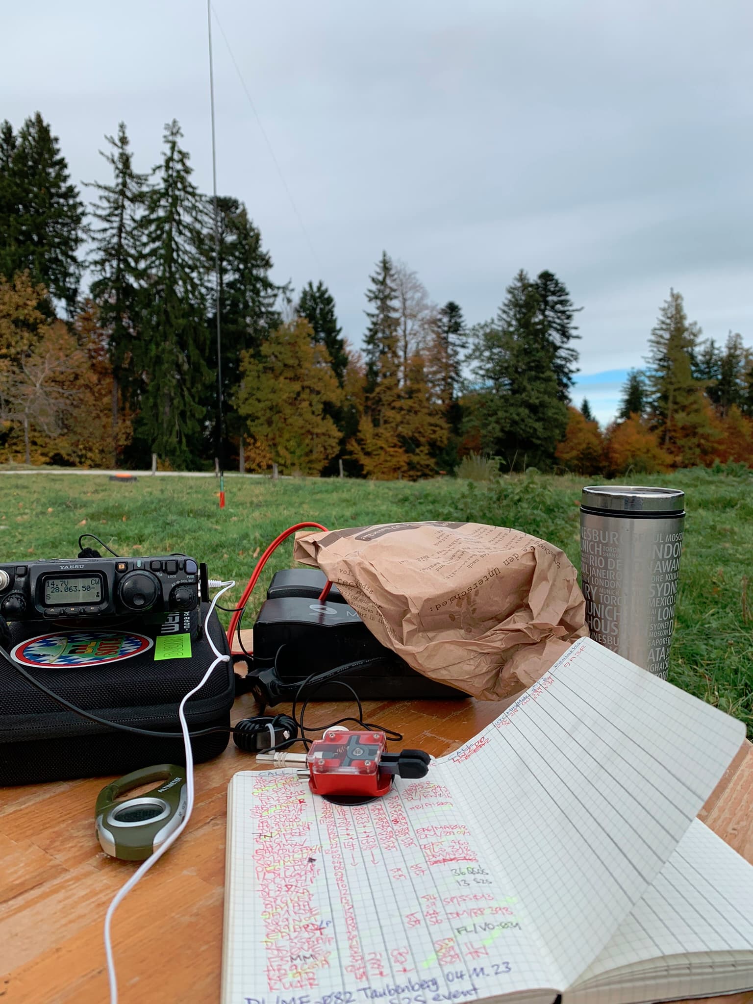

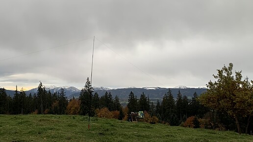

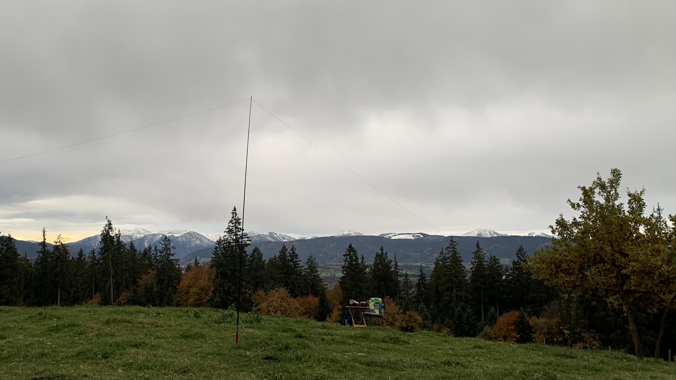

DL/MF-082
FT-817 (5W) and EFHW @4,5m (Inv.V)
73, Mario DJ2MX

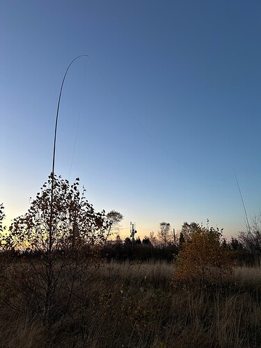

The Trans-Atlantic S2S Event exceeded my expectations!10m was the “money band”. What an awesome time!

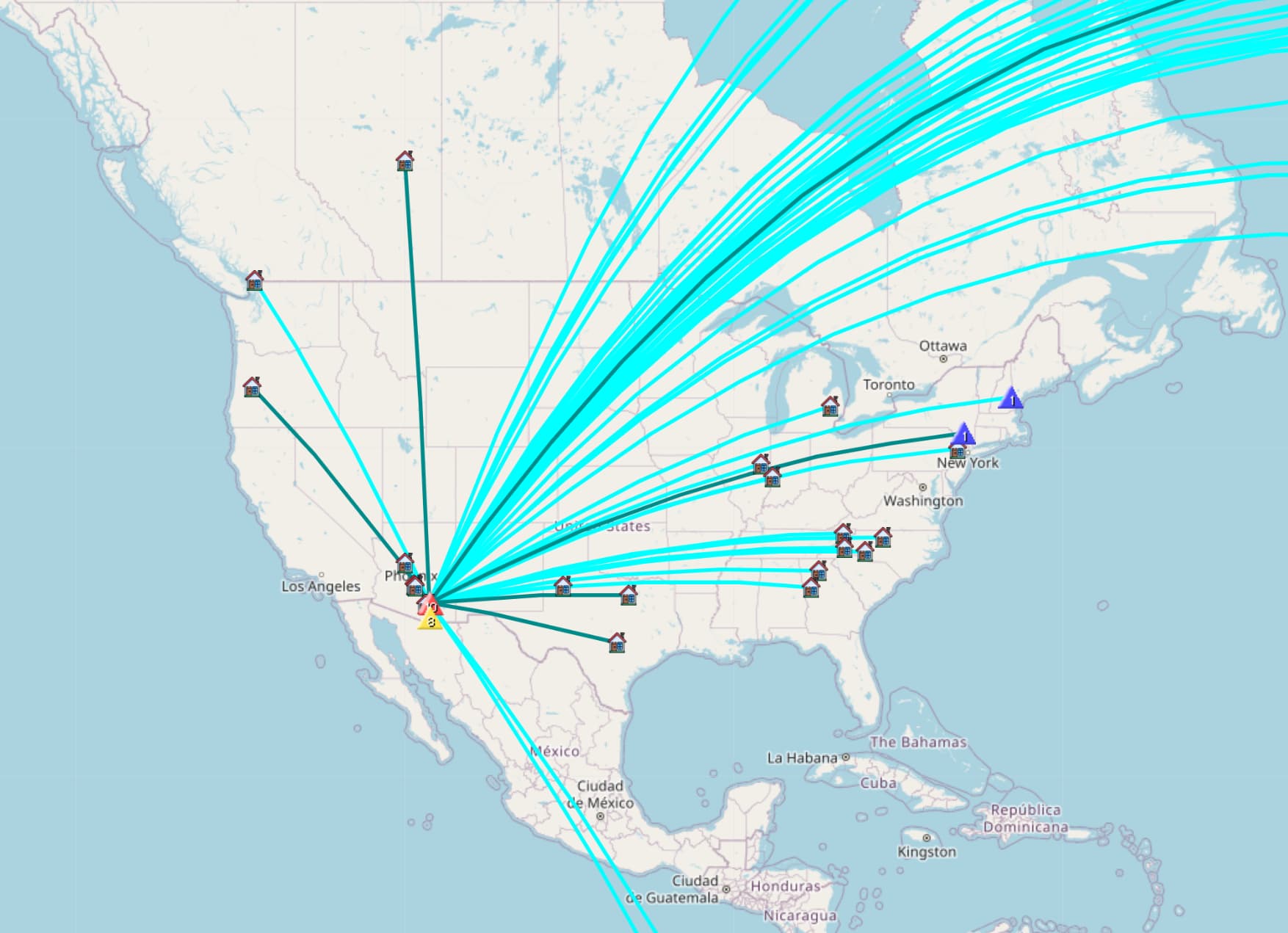

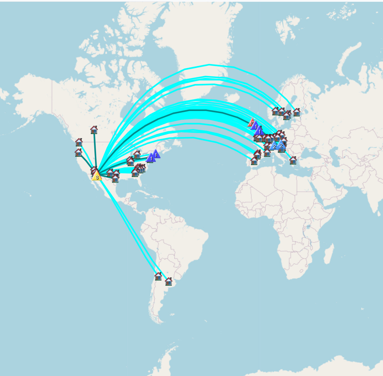

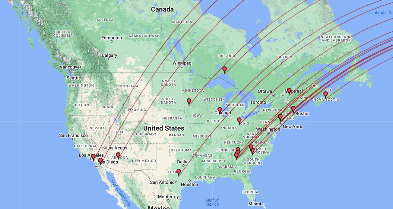

Though I had previously activated Mount Lemmon (W7A/AW-001) just a few weeks earlier, I chose the summit for the event because of its elevation (9160 ft / 2792m), a relatively short drive (90 minutes) from home, a minimal (10-minute) hike slogging a heavy (33 lbs / 15kg) pack to my chosen operating location, and a 10-point score to reward chasers.
Unfortunately, I had no cell service at my operating location which deprived me of the ability to spot myself and to see other activators’ data. In addition, Garmin changed their messaging system to require downloading a new phone app, so I was unable to spot myself using my Garmin. Fortunately, I had posted an alert and RBN stations picked up my signals and posted spots for me, which saved the day.
Of 68 contacts made during a little more than 2 hours of operating time, 62 were on 10m and 6 were on 15m.
Total QSOs: 68
DX QSOs: 42 (40 EU + 2 S America)
S2S QSOs: 9 (5 EU + 4 USA)
Radio: Yaesu FT-891
Power: 50W
Battery: 20Ah LiFePo4 which died after a little more than 2 hours
Antenna: 133’ (40m) end fed inverted V with apex at 13.5’ (4m). Orientation: N-S
Many thanks to GM0GAV/P, G4OOE/P, OE5EEP/P, HB9DQM/P and GM4OIG/P for the Summit-to-Summit contacts!
Many thanks to GM3JW, DL6UHA, OH1MM, F4WBN, OE6STD, OE6GND, F6EAZ, S57S, ON7QR, HB9CEV, EA4R, G0TRT, F5JKK, DL2AKV/M, LW2DO, DK7ZB, OK2PDT, EA2DT, SV2OXS, SA4BLM, G3VXJ, DK1WI, G4OBK, DM4EA, G4GIR, EA2LU, G4YBU, LA5FHA, SM5LNE, SA0AQT, S52AU, HB9CBR, ON4ATK, OK2BVX, G3RDQ, ON3LMA and LU1MAW for the chases!

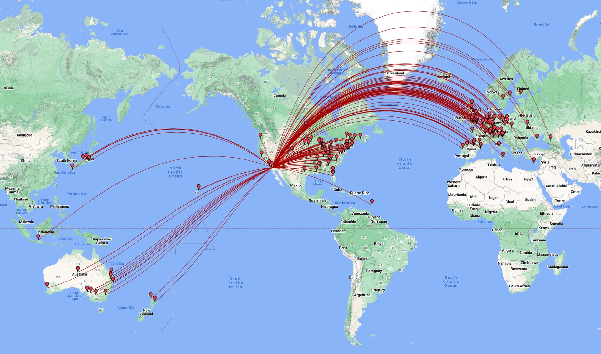

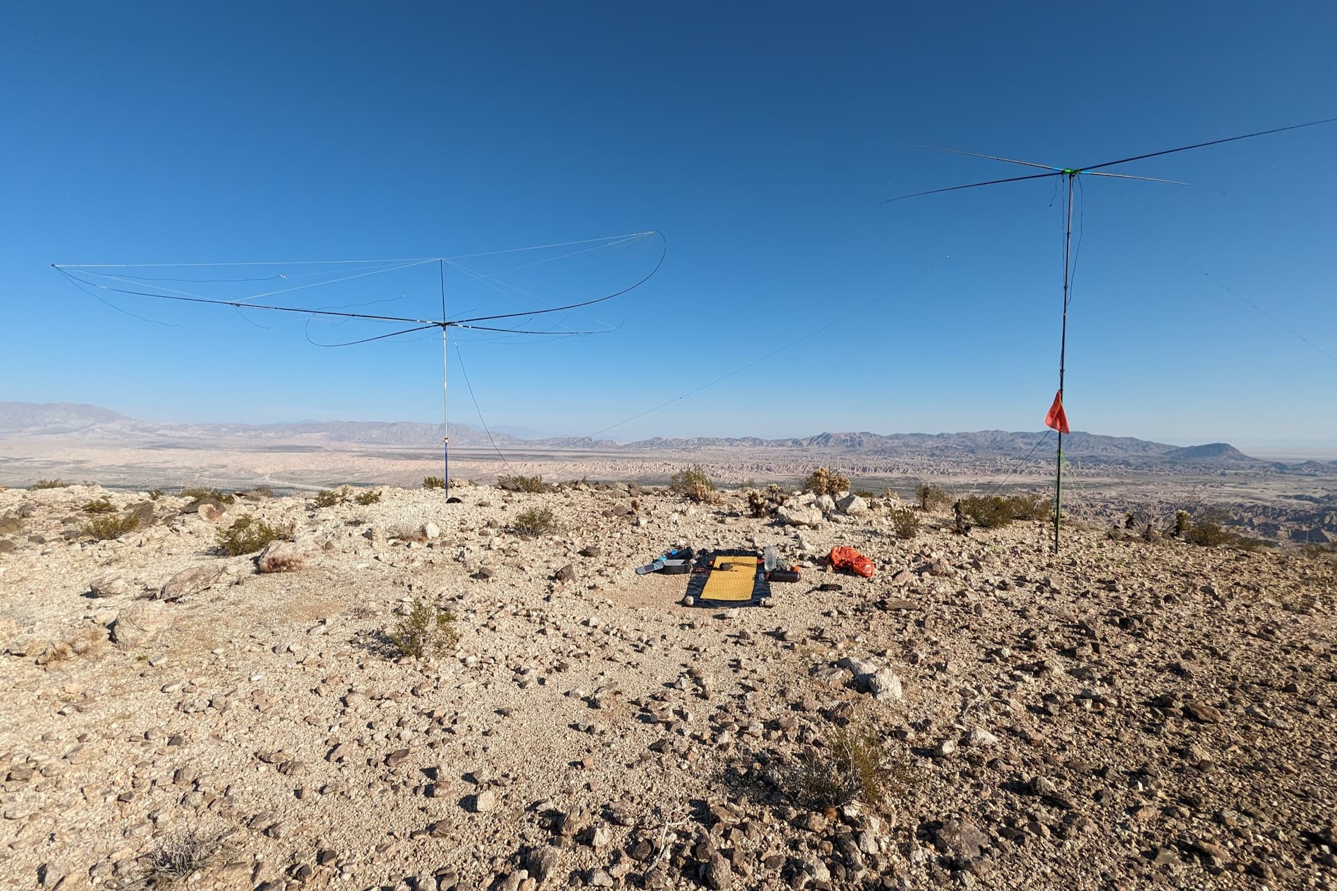

Simply put, that was the most incredible activation I have experienced, thanks to excellent band conditions, awesome SOTA ops around the world, and an amazing pileup of chasers.

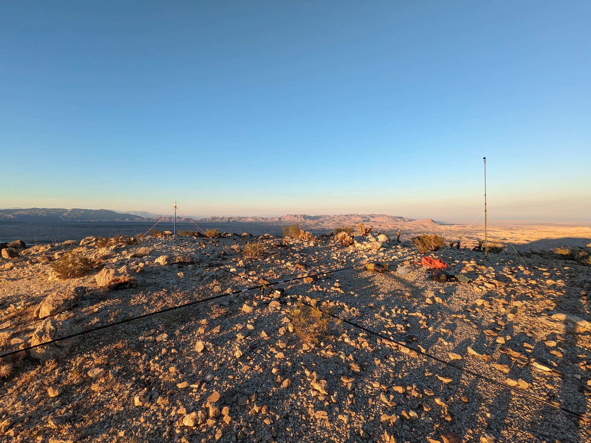

I set out after work Friday afternoon to the Anza Borrego Desert about a 1.5 hour drive East of San Diego, California. The dirt road became very rough so I stopped about 1/2 km from the end and began my hike in 30 deg C weather with no wind.
My destination was “Mine Benchmark,” W6/SD-396. Mine Benchmark - CalTopo
Not carrying just the usual mini CW rig, pack was heavy - about 20-25 kg - loaded down with an ICOM IC-7300, 28 Ah worth of LiFePO4 batteries, and three antennas. My intent was to primarily work the 10 and 15 m bands with a homebrew 7 element 10 m yagi and a 15 m moxon. I also had a 40-10 m linked dipole as a backup and nighttime antenna. All of that was stuffed in on top of overnight gear, as I would be camping on the summit.
10 m 7 element yagi radiation pattern from MMANA model
The 2 km hike up 230 m of elevation took about an hour with the heavy pack, and I arrived 45 minutes before sunset. Immediately, I got to work setting up the 10 m yagi and hoisted it up on the 5 m pool cleaning pole mast with the antenna pointed West.
Setting up the 10 m yagi.
Hoping for some 10 m propagation to ZL, VK, and JA, I started calling on 10 m SSB. Within an hour, I had 19 in the log before stopping to set up the 15 m moxon and linked dipole to operate before going to sleep. 20 m CW netted a few more JA stations and some friends in the US.
For my evening operating, I finished with:
12 VK
5 JA
2 ZL
1 YB
8 US stations
YB2NDX was the stand-out, working me with 5 w on 10 m SSB. But still, the real goal was to get EU S2S.
I set the alarm for 6 am local time to try to catch as many EU opportunities on 10 m and 15 m as possible. I tuned around, listening for EU stations on summits from the spotting page, but could not yet hear many of them. So, I spotted myself on 15 m CW and began calling. About an hour of operating there logged about 30 QSOs with S2S.
10 m 7 element yagi on the left, and the 15 m moxon on the right
I then switched to 10 m SSB for about 70 QSOs, then 10 m CW for about 30 more.
My final log included:
**170 total QSOs, 113 of which were DX! 26 different DX entities worked. **
  • 87 total EU contacts
  • 18 EU S2S
  • 6 US S2S
I think many of my EU contacts were not even SOTA chasers - just operators hearing me and replying to my calls. I’m sure there were S2S stations buried in the pileup that I missed, and I know there were some who I just couldn’t quite hear well enough despite lots of patience and repeats from them. My apologies for not getting you in the log.
Many thanks to all who participated. This was an amazing event and one I’ll remember forever.

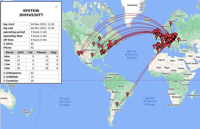

There are some amazing reports above. My daughter and I drove the four hours north Friday and camped in central Oklahoma, starting to hike Saturday about 6:15 am local and almost two hours before sunrise. Wind conditions on the summit were awful with gusting to at least 45 mph so we set up as best we could on the lee side of boulders, which likely was the reason we only had two contacts to the west.
Not spectacular numbers but a lot of fun and most importantly my daughter had fun operating ssb. S2S included SP9TKW, GM4JXP, LB8CG, VA2EO, NM3A with 15 meters being our work horse. We tried other EU stations but could not get through with louder stations. We heard 10 meters quite hot but by that time had enough of the wind. 32 in the log.
Thanks to other activators and the chasers.

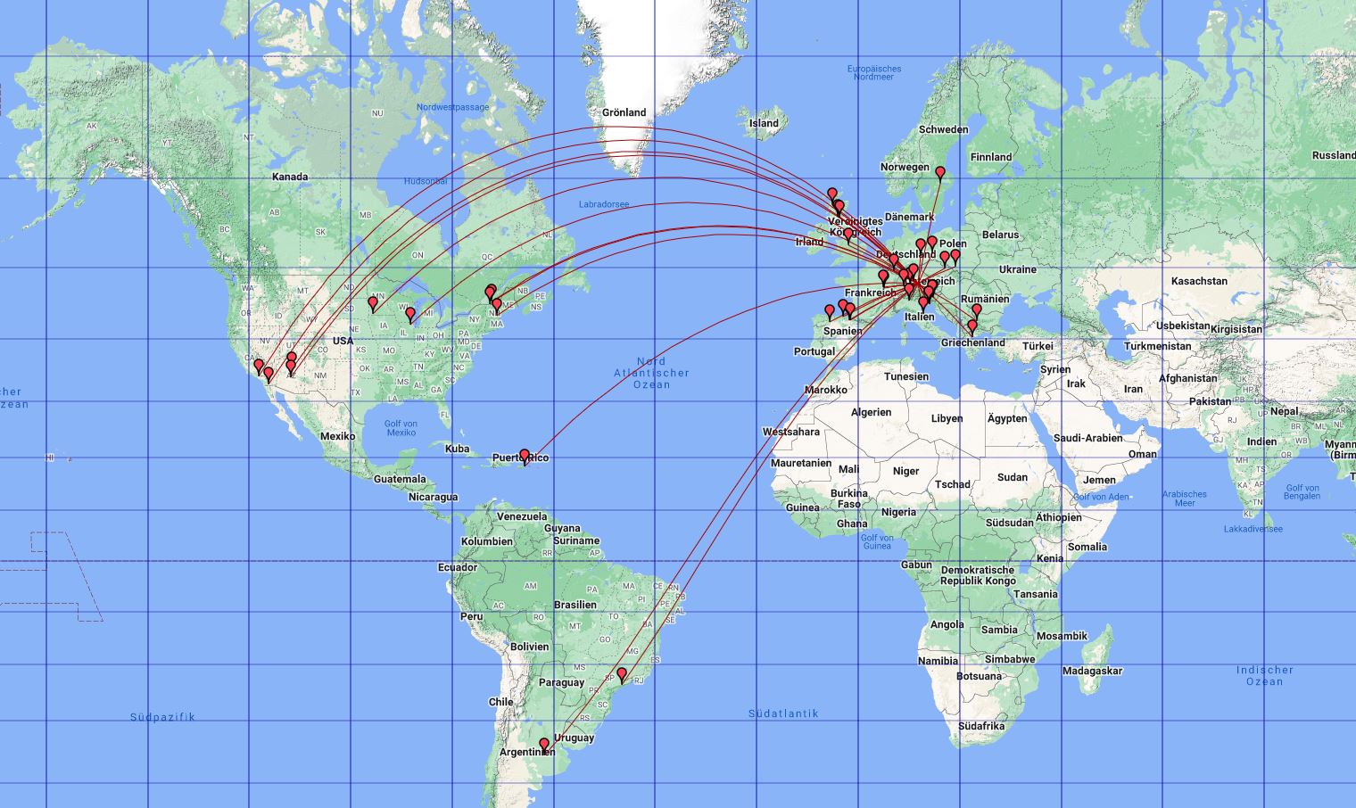

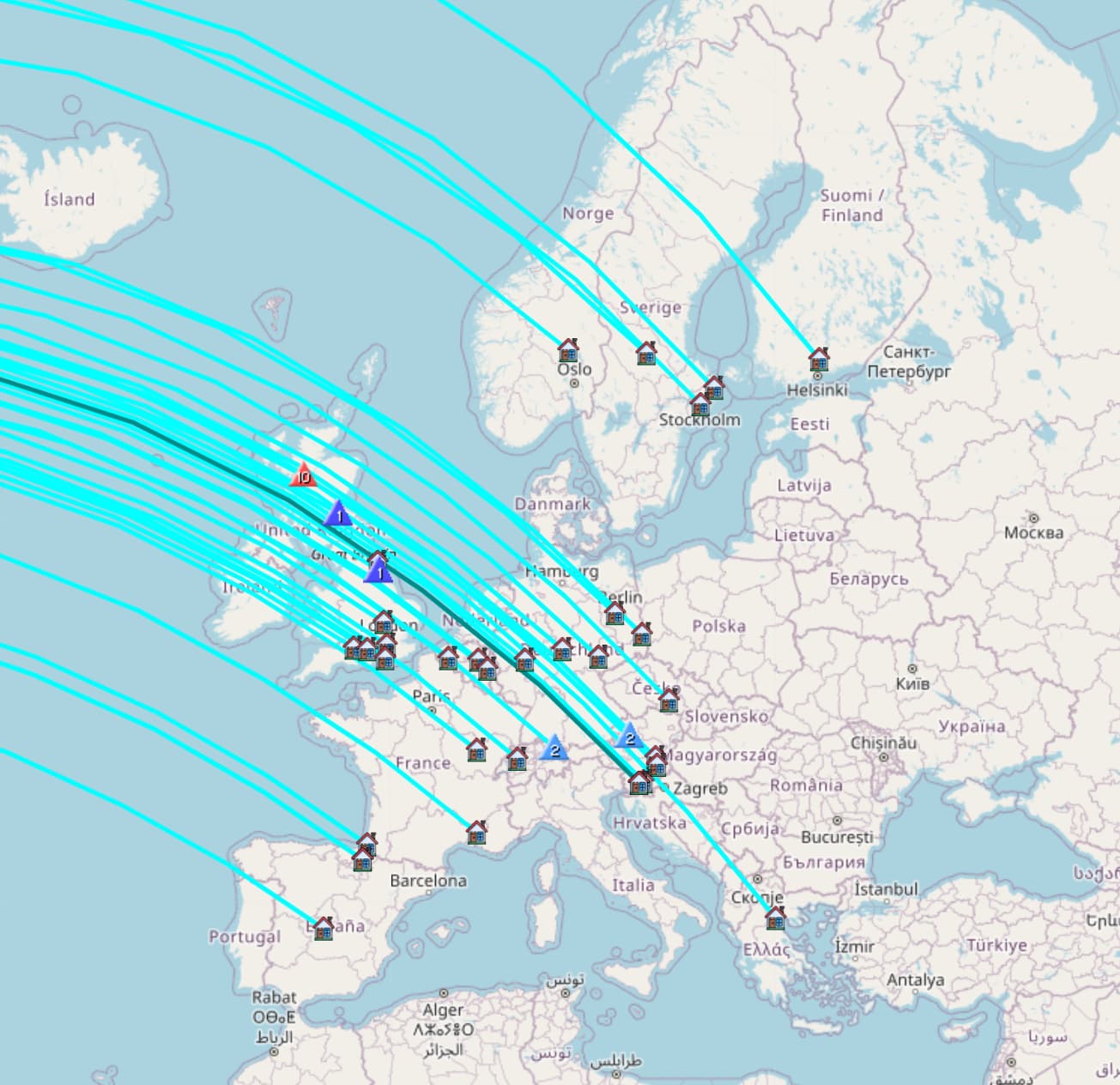

My bag was 92 QSO all SSB, running 100W into EFHW as inv-L with apex at 9mtr high and transformer 2mtr off the ground. After 3 hours my 20Ah battery was empty so just before sundown I had to finish.
I crossed Atlantic 20 times: 18 times NA and twice SA. Managed 7 S2S into NA and 8 in Europe.
Longest QSO was Horacio LW2DO 12427km and longest S2S was with Adam @K6ARK 9857km which was just ahead of S2S with Paul @W6PNG.
Many thanks to all activators and chasers and I hope to catch you again soon.
73 Marek
Hi Adam, thanks for the S2S last Saturday!
I remember your signal being very strong and being surprised when I learnt that that was a S2S. Now I know why! :slight_smile:
I’m very curious about both antennas, specially the 7 el. I tried to zoom in the picture but I’m not sure I can see the wires and ropes clearly enough to understand how it holds mechanically… Would you mind sharing a schema?
Thanks!
Roger, EA3M
I will share a MMANA model when I have a chance, but for now, here are some more photos. https://photos.app.goo.gl/M3c7SyBfMPcC9nK3A
The elements are black 18 ga Poly Stealth wire.
Cords and guy lines are yellow kevlar.
Spreaders are “7.2 m” telescopic fiberglass poles.
The center hub is 3d printed.
Adam

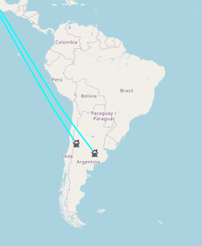

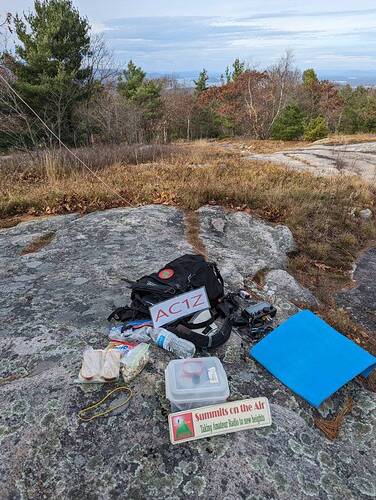

AC1Z - Enjoyed the S2S Transatlantic Event! Made 47 contacts 27 DX including 32 Total S2S with 15 S2S DX! Lots of NA activity too with 17 USA/Canada S2S contacts! KX2 with 10 watts and trail friendly end fed antenna. Thanks to Gerald G4OIG/G8CCK for coordinating this event!
Thanks QSO Phil,

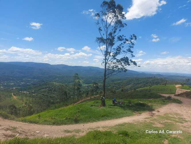

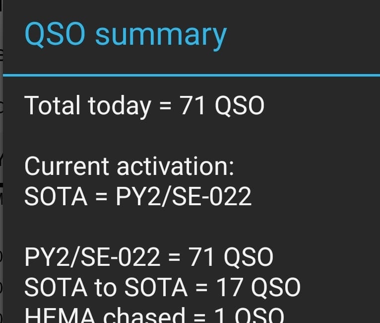

Beautiful audio in PY2/SE-022
Carlos
PY2VM.

Hello John,
Thank you for the QSO S2S with me PY2VM and Marcio PY2TTN.
PY2/SE-022
28mhz was very good, but with a lot of splatter from DX stations.
It improved a lot when it went from 28.343Mhz to 28.570Mhz.
Carlos
py2vm
Hi Alfonse,
Thank you for QSO S2S - PY2/SE-022
We thank PY2VM and Marcio PY2TTN for the QSOS and S2S.
S2s: @DG7AC, @in3jib, @m0wiv, @g4ooe, @oe9hrv, @oe9tkh, @hb9eaj, @hb3ynl, @hb9eko, @pu2oyt, py2gut, sp9jtr, sv9bij, va2eo, lu5mrr, lu6mfb
Carlos
py2vm
