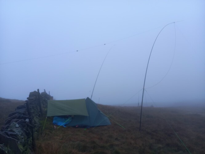

A good afternoon! Only 1 s2s in the log and none over the Atlantic although @AJ2I tried very hard, we couldn’t quite make it. 5 Watts not quite enough at that moment. Furthest qso was to North Carolina. I dodged the rain showers to change bands and the sun shone, then went down. Back to the car in the dark…
Operating point from Minch Moor GM/SS-133 - a brief break in the rain…
Back to the car by the light of the silvery moon…
Ft817 barefoot to 1/4 wave verticals or dipole depending on band
Thanks for the contacts!
